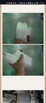

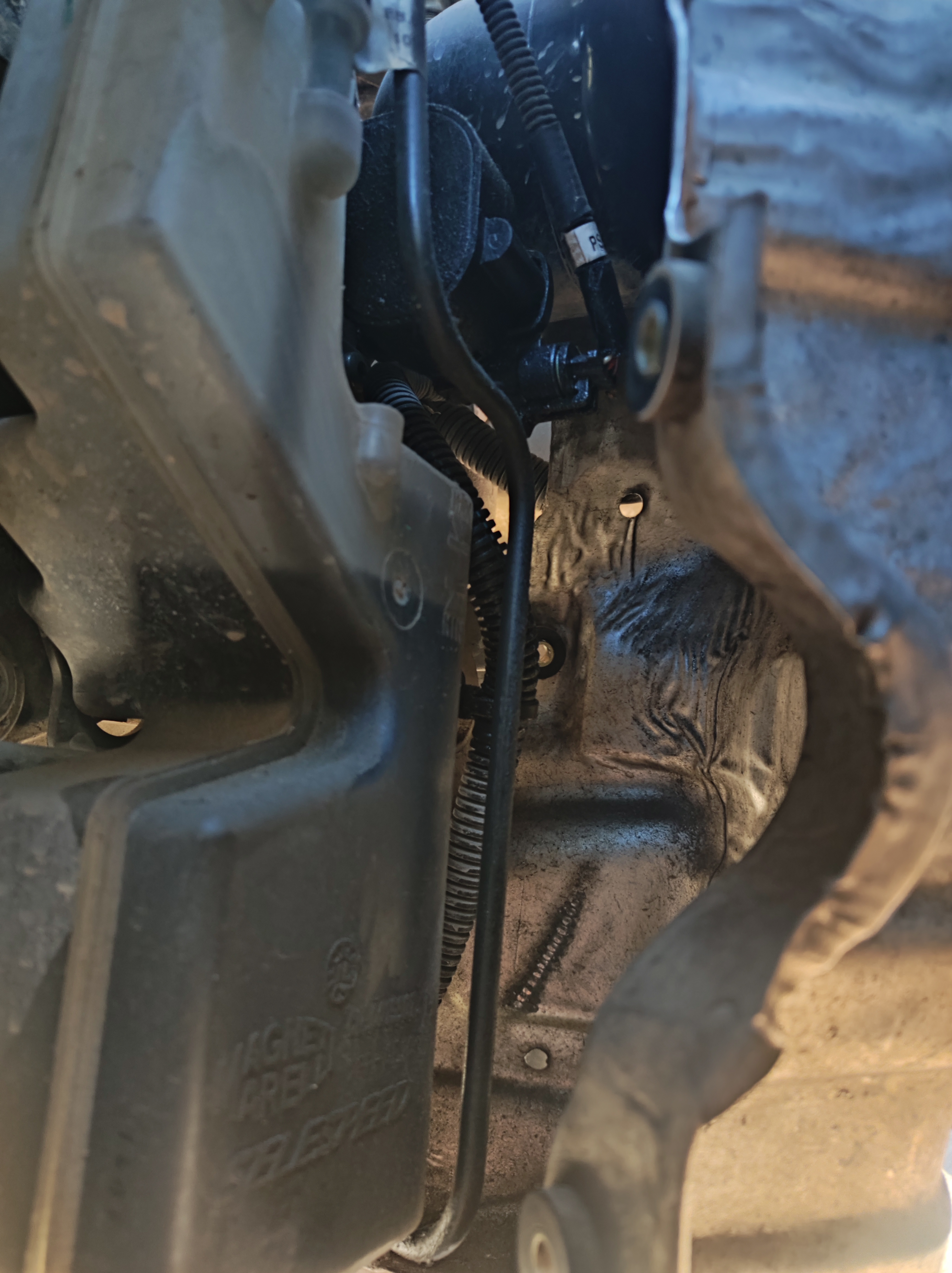

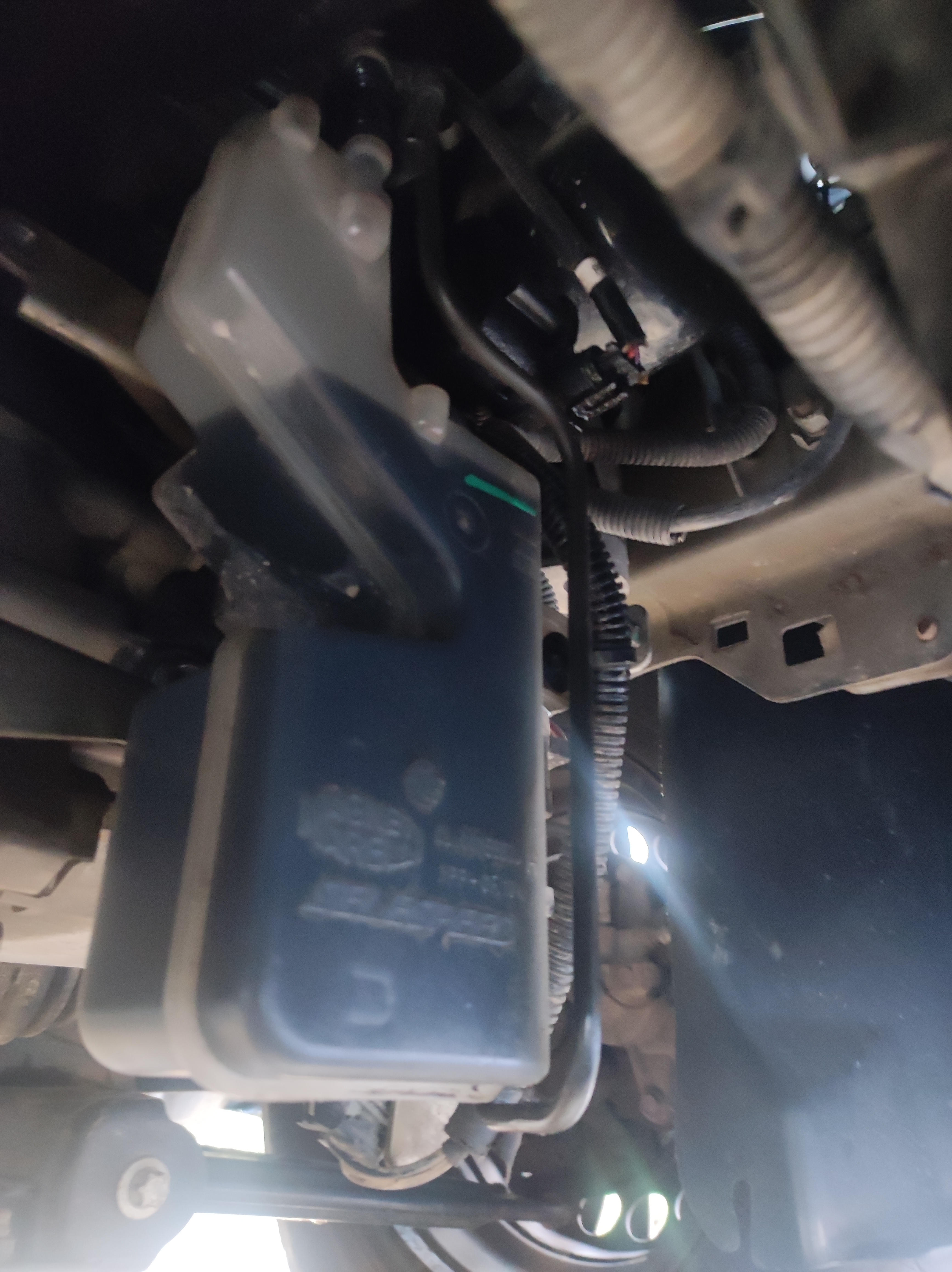

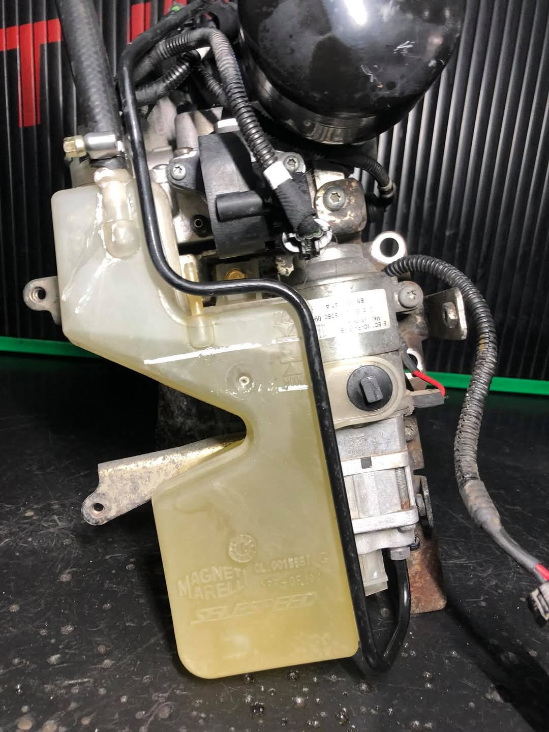

Hello
Please could you mark me return pipe on picture?
Is it easy to remove return pipe without braking reservoir pipe?
Is it possible to pump fluid out through the cap on top and how?
i tried with 5-6mm pipe but i couldnt push pipe down, its was stuck on top?
Thanks

Disconnect return pipe and open the door
You can't properly fill the system without software
After the system has primed by opening the door the level should be at minimum

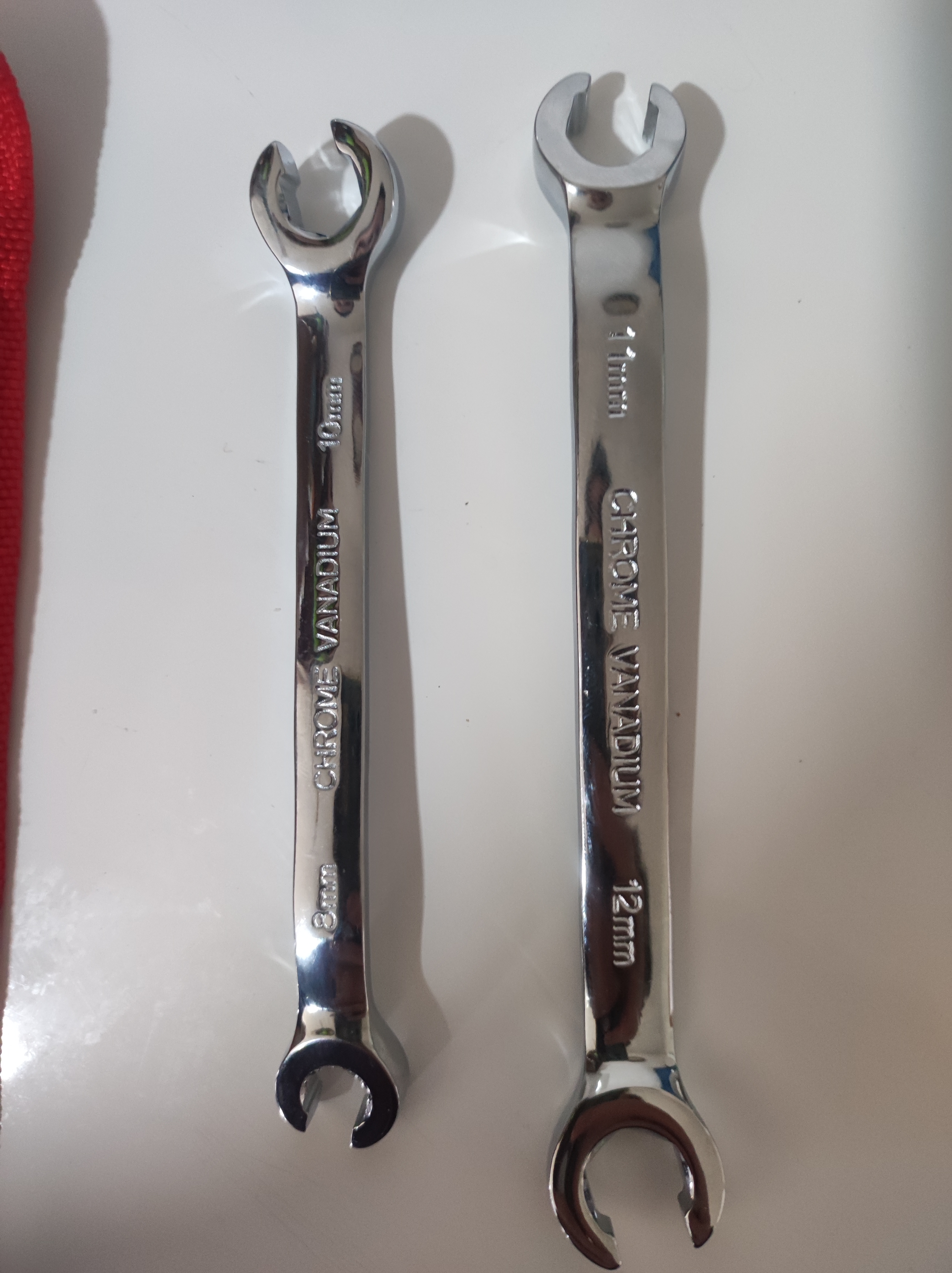

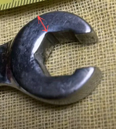

I made by myself two brake flare spanner by cutting with grinder middle of wrenches.
One longer wrench is China, and other shorter is professional Porsche. Return Pipe width is 5.8mm and i cut 6mm.
When i get time and good weather i Will try it.
Many thanks

I try to unwind return pipe with brake flare spanners that i made and didnt managed to unwind. Wrench 11 was big and and slip down.
Next time i Will try to grind standard wrench 10 to fully fit without any space.

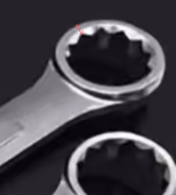

Grinding a slot in a 12 point ring spanner is unlikely to work - it didn't for me.
A 6 point flare nut spanner has thicker stronger sides to prevent spreading

Just buy the correct spanner
You then have it for life
Your making things difficult for yourself
Brake flare spanners are thicker and wider all round, to stop them spreading
Most combo or ring will be too weak once they are cut open

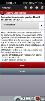

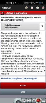

I have changed robot oil Today. Brake spanner 11 fit perfect and i have unwind without problem.
Then i drain out 0,4l by opening door. And fill 0.4l New CS speed fluid.
Then i shift speeds few minutes n,r,1 to mix fluid and wait for fluid to fill reservoir another 4 hours then i repeat same procedure. Drain 0.4 from reservoir and fill 0.4new fluid and close cap.
Then i made clutch drain 3 Times and end of Line calibration with alfaobd.
Its not necessary because there was no error when i change fluid and gearbox work but i do anyway as its recommended to extend robot lifetime.
Then i made test drive around 20km and all was ok.
I am satisfied that i made by myself :)
I Will change fluid every 20 000 km with same procedure.
