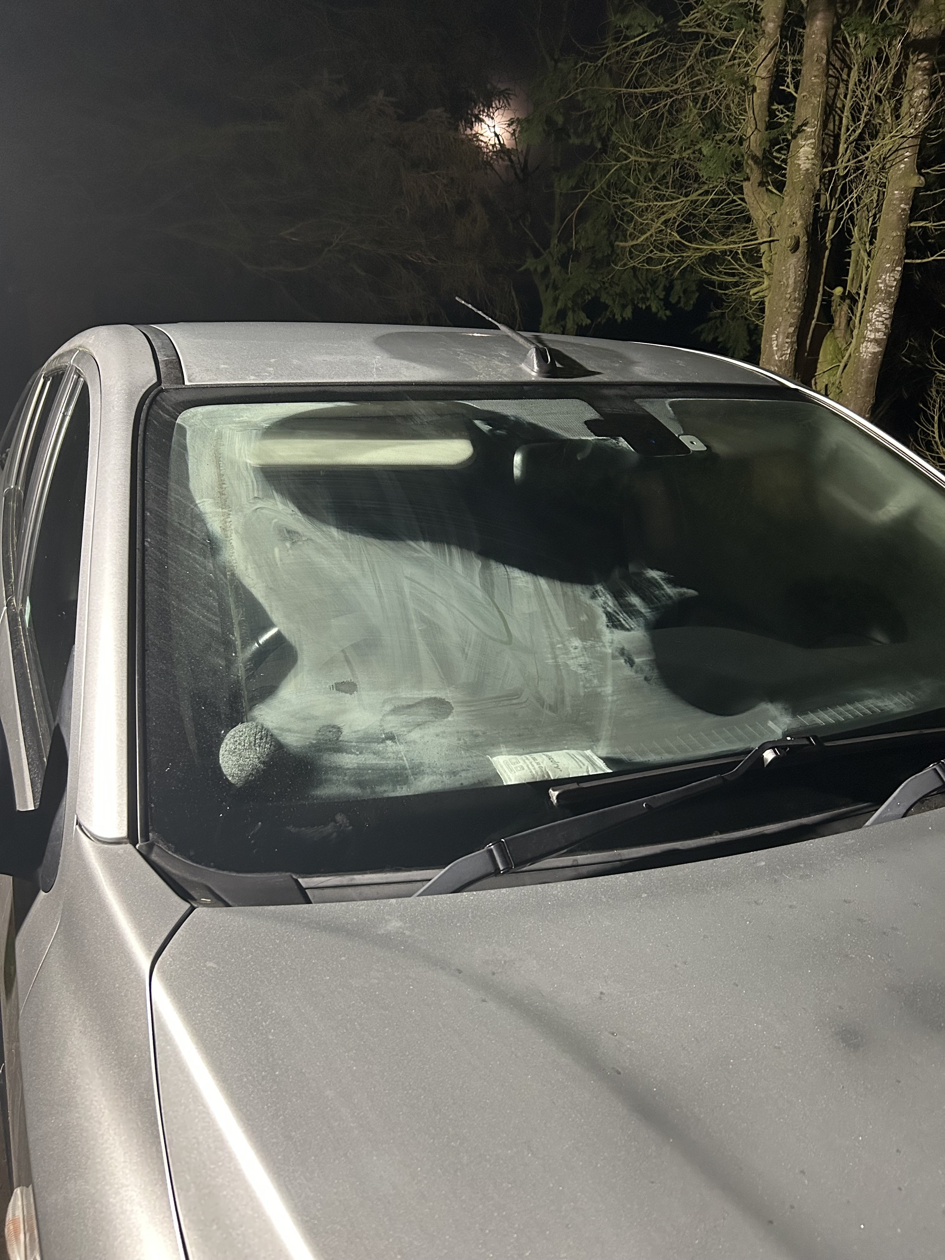

Has anyone had any problems with the inside of the windscreen getting a lot of condensation on it?
With this freezing cold weather (-7) I’m having to clear the inside of the pickup as well as the outside.. water dripping off windscreen.
After a run and all warmed up it starts getting condensation on it after about 30 mins ( on both sides of the windscreen to start with and then the front windows!)
Radiator does not seem to be losing fluid, A/C still works fine and pollen filter just changed two months ago. All carpets dry.
Are these bad for leaking windscreens or roof aerials?
Any help would be appreciated.

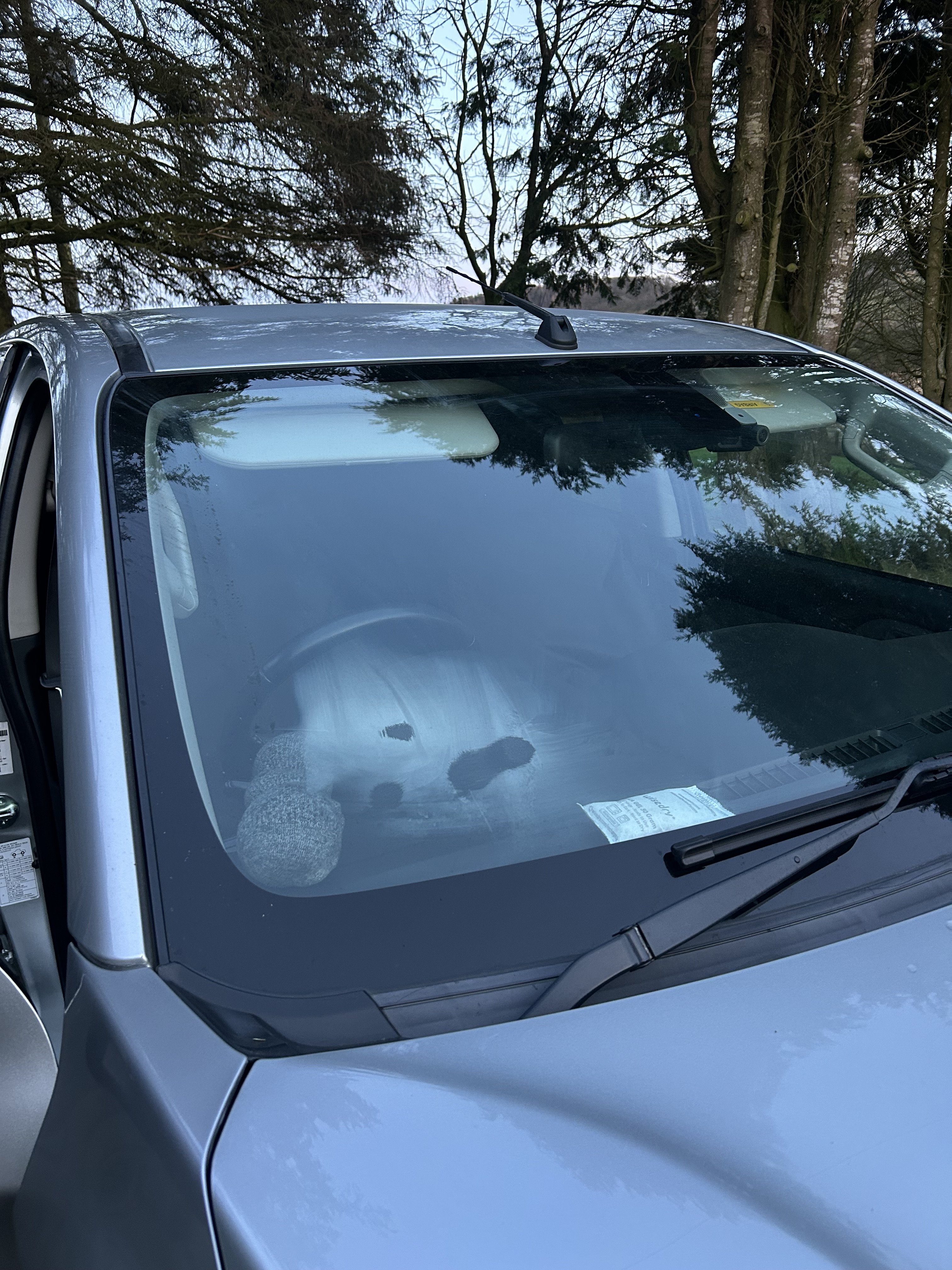

Ok so I’ve coolant pressure tested and I’m not losing pressure.
I’ve driven pickup for 1 hour and parked back up, I’ve got a sock full of cat litter and a silica gel packet on the dashboard and as you can see by the photo I’m still misting up! Outside temperature is now 12 degrees Celsius and I’m still not getting to the bottom of it. Any suggestions on next steps?
I was thinking has someone set it o recirculate by mistake.
If there is a lot of humidity outside it is a good practice to set the switch / lever to recirculate. In such conditions usually air in the cab is drier (heating and A/C), so it does not allow the humid air from the outside to get in the cab.
When have you cleaned the A/C system? Perhaps you have some kind of life there :D
I'd say strange the condensation is on one side only.
I’ve only had pickup 6 months and have done nothing with a/c.
I thought the same about just the one side but in the cold weather we had here it did same on passenger side too but not as bad. I was thinking could it be a blocked scuttle drain? Looks like the scuttle panel has been off before as there are clips damaged and missing and end plates have not been put on properly!
