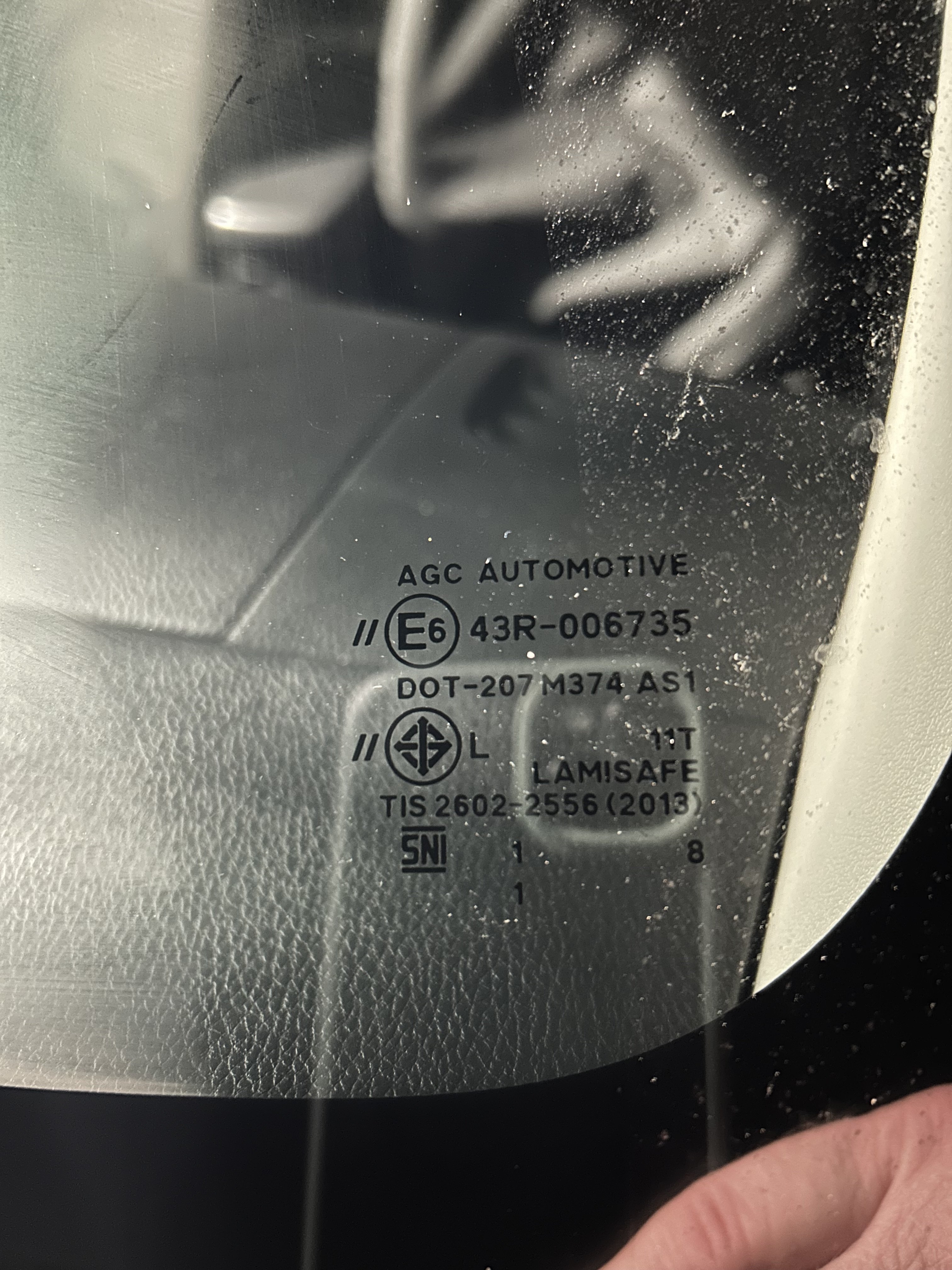

Is the windscreen original? There is coded production date (2 digits of the year + up to 12 dots showing month).
Windscreen stamp ( only thing that’s on it )

Were you aware of the fact that the windscreen has been replaced at the moment of purchase? Was it bought from a professionnal? As you've bought the car recently, perhaps the seller should deal with it. But I don't know the UK regulations on that.
Other windows have a different manufacturer name on them….. so windscreen must have been changed!
