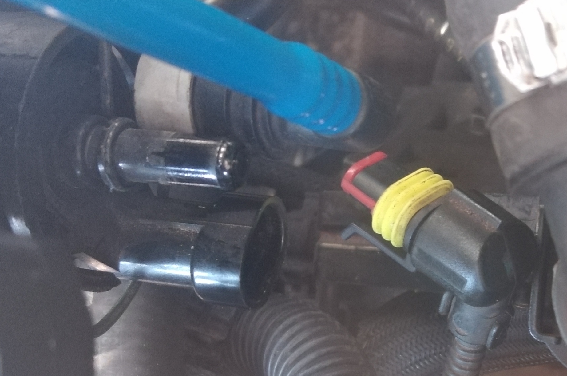

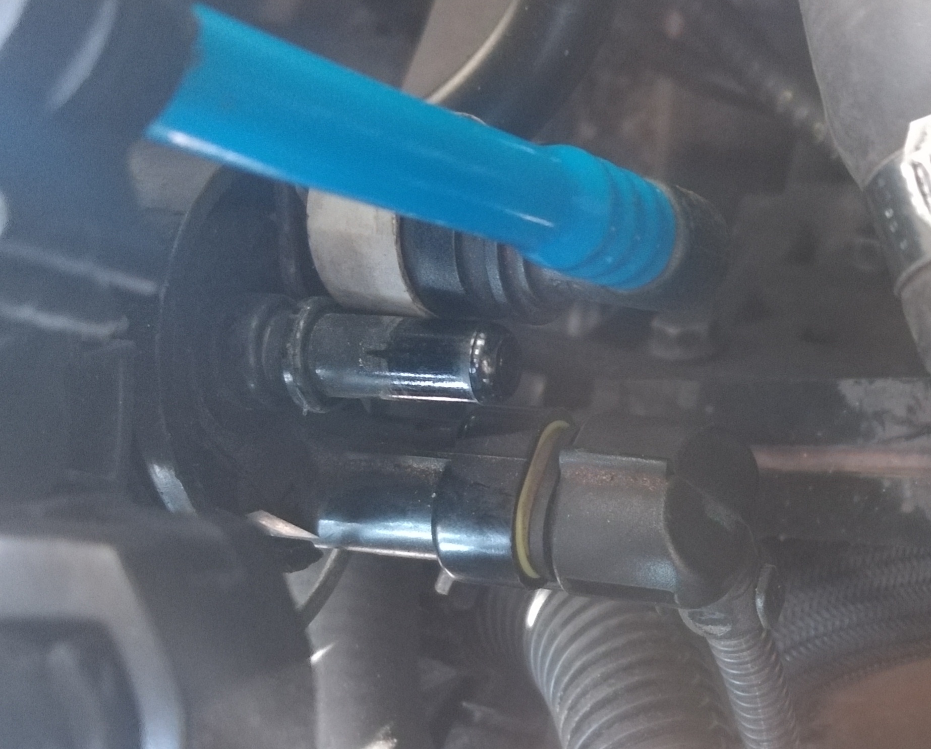

Well that will be you problem, it's not closing fully
It should remain closed with the engine cold
It should remain closed at idle
I suspect the ECU is doing its job properly as you can hear the solenoid opening as you rev the engine
Whether is a fail on fit part, or damaged due to petrol still in the canister I can't say

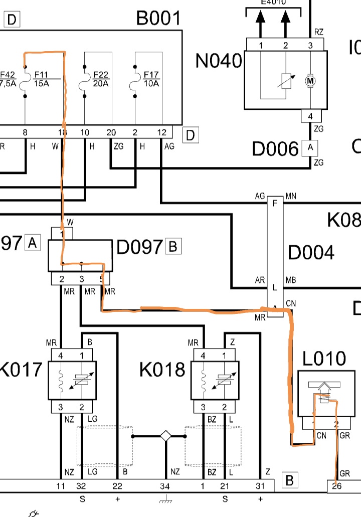

If you want I can look up the wiring diagram and you can confirm it's operation, but as you can hear it opening I suspect it would just be a waste of your time
