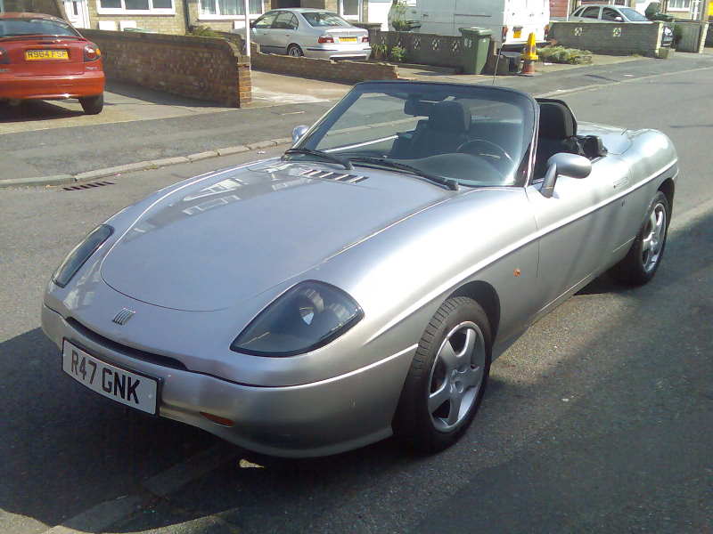

Below are my two prize possesions, the Sportawagon is of course the 2.5v6 with Q Drive.
