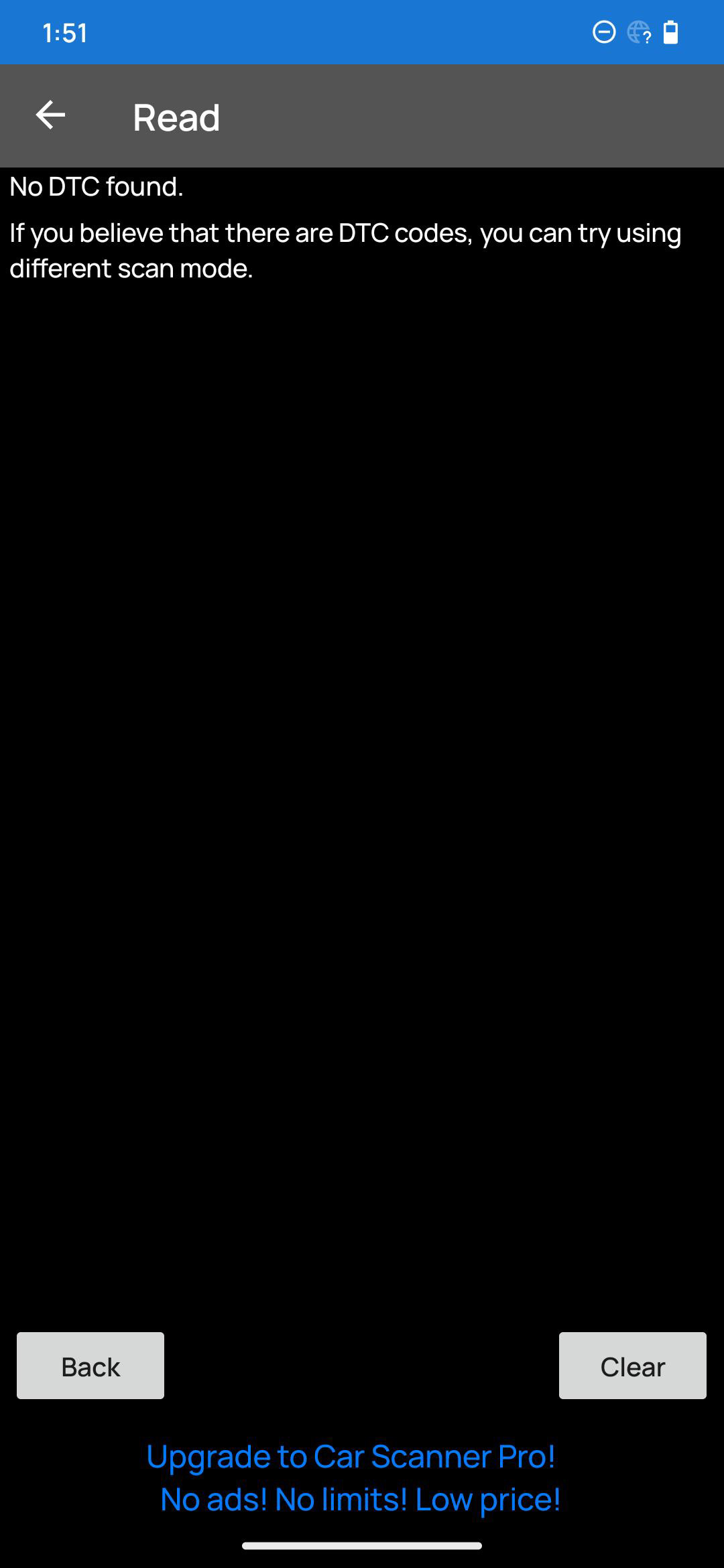

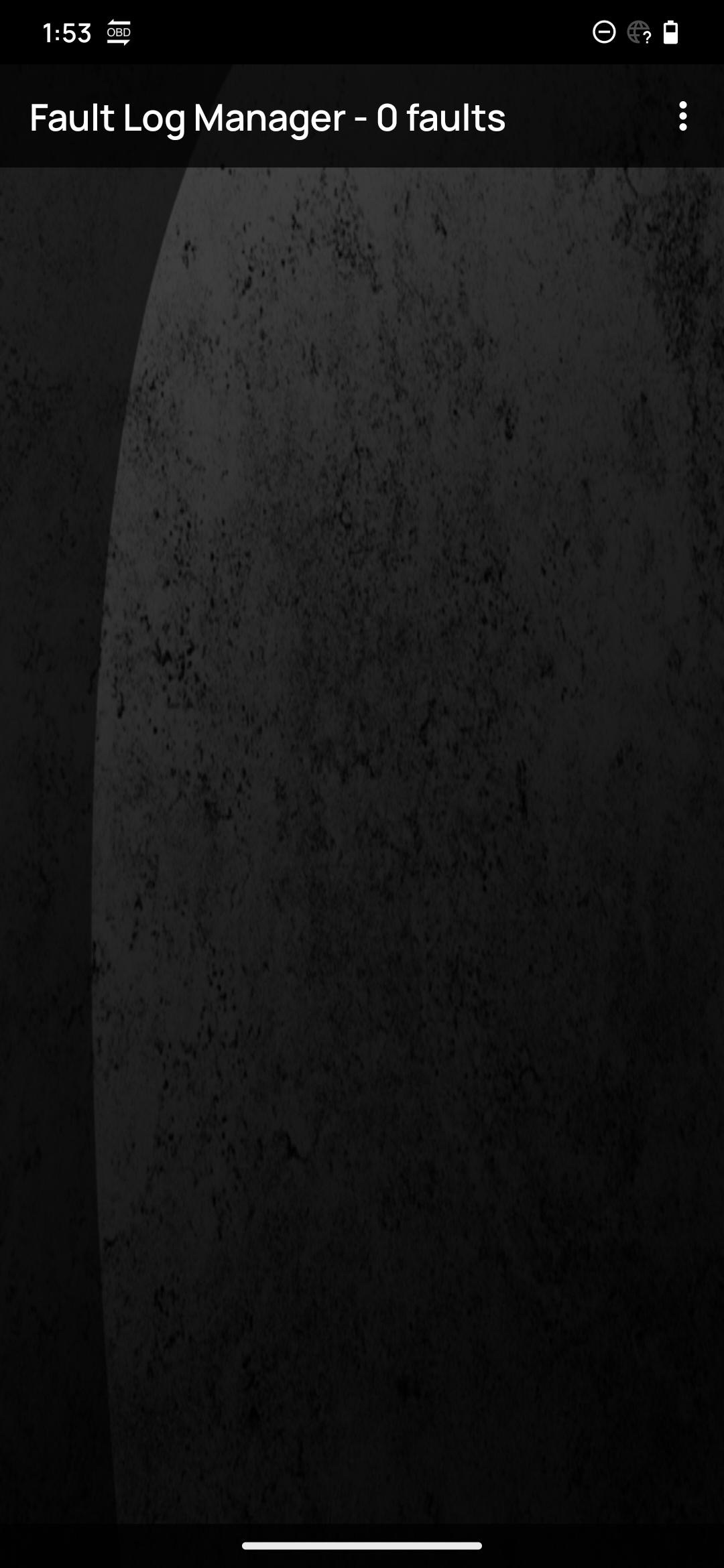

The OBD-II scanner finally arrived (the Bluetooth ELM327 one). It works well, surprisingly even connected to my iPhone without an issue (no idea how, it was labeled as Bluetooth 2.1 and supposedly iOS can only connect to 4.0+ but it still connects without an issue and reads properly).
Both Car Scanner and Torque Pro return 0 errors/diagnostic codes. I tried connecting it to MultiECUScan but there’s a weird problem: Windows asks me for the Bluetooth PIN every time MultiECUScan tries to access the OBD-II scanner, however it doesn’t give me time to enter the PIN and instead instantly counts it as a failed connection. I’ve mapped the Bluetooth device to COM8 but it simply won’t connect.
