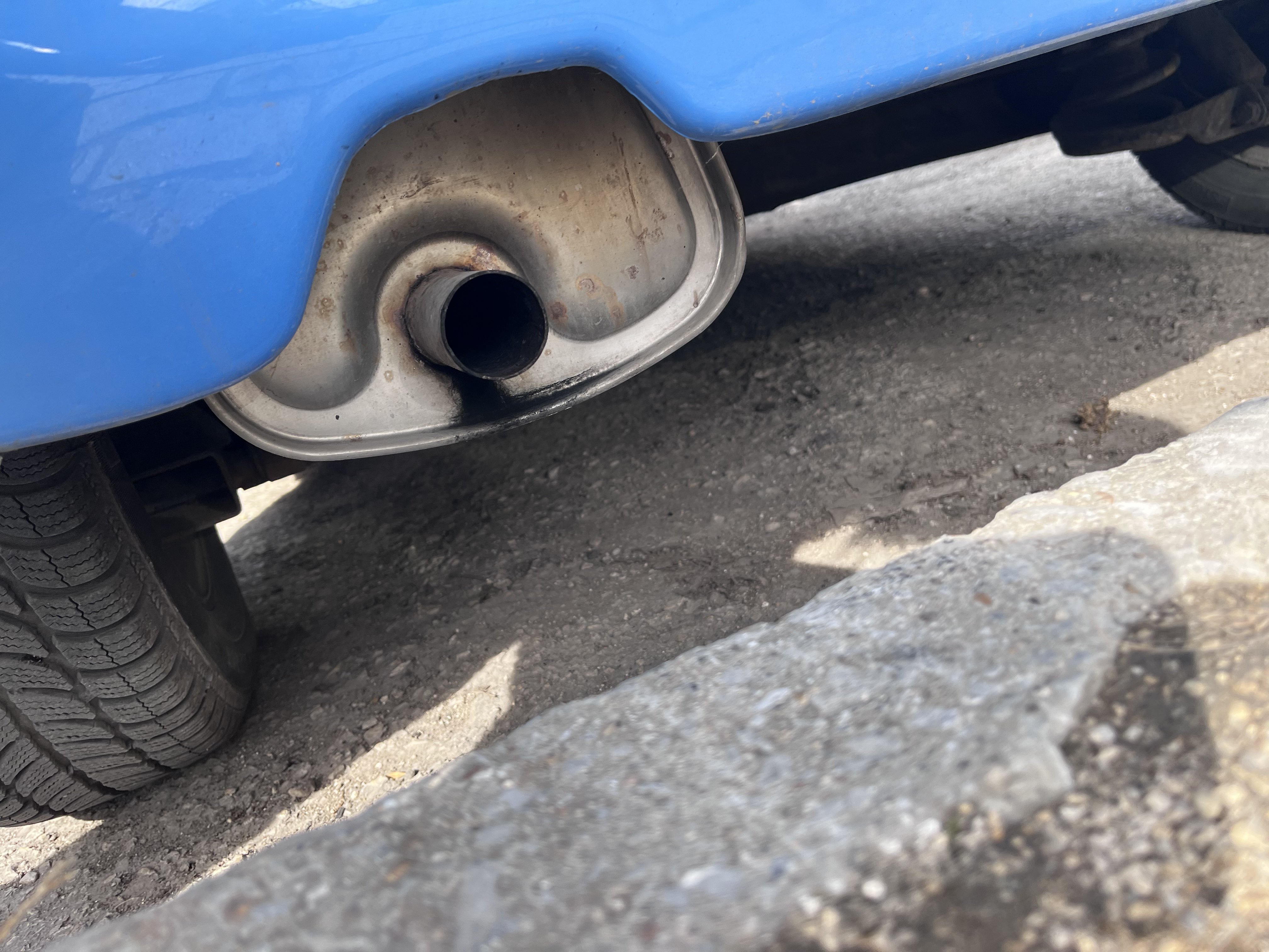

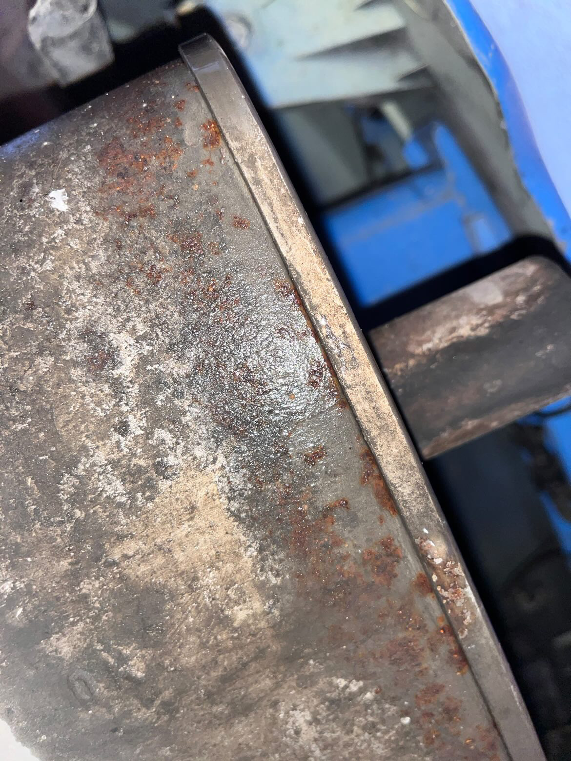

- the bottom of my exhaust pipe is black; there is never any black smoke coming out of it, it seems to function normally but it’s something i’ve noticed; it’s also a bit rusty, i’ve attached photos of it.

Black soot in the exhaust is normal

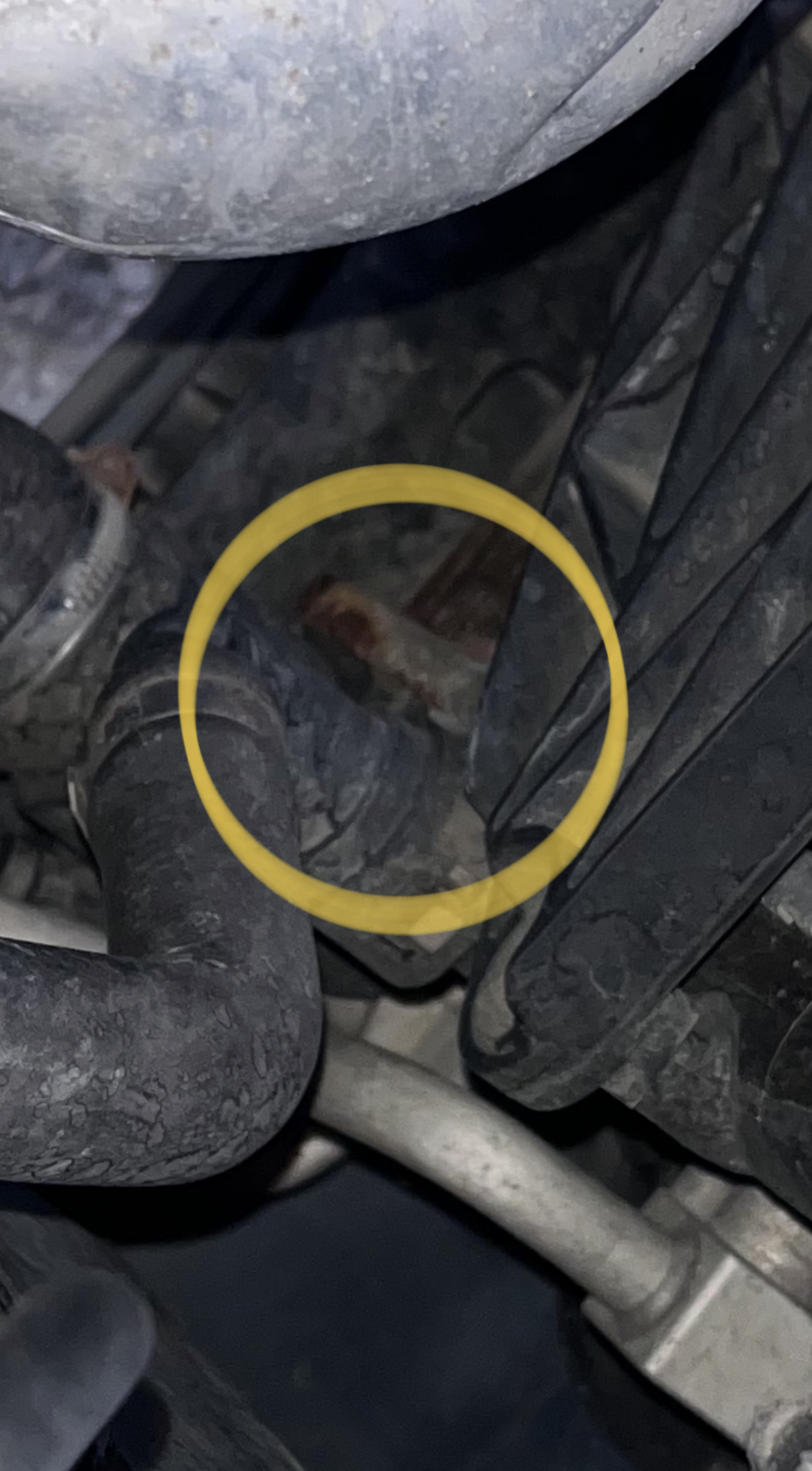

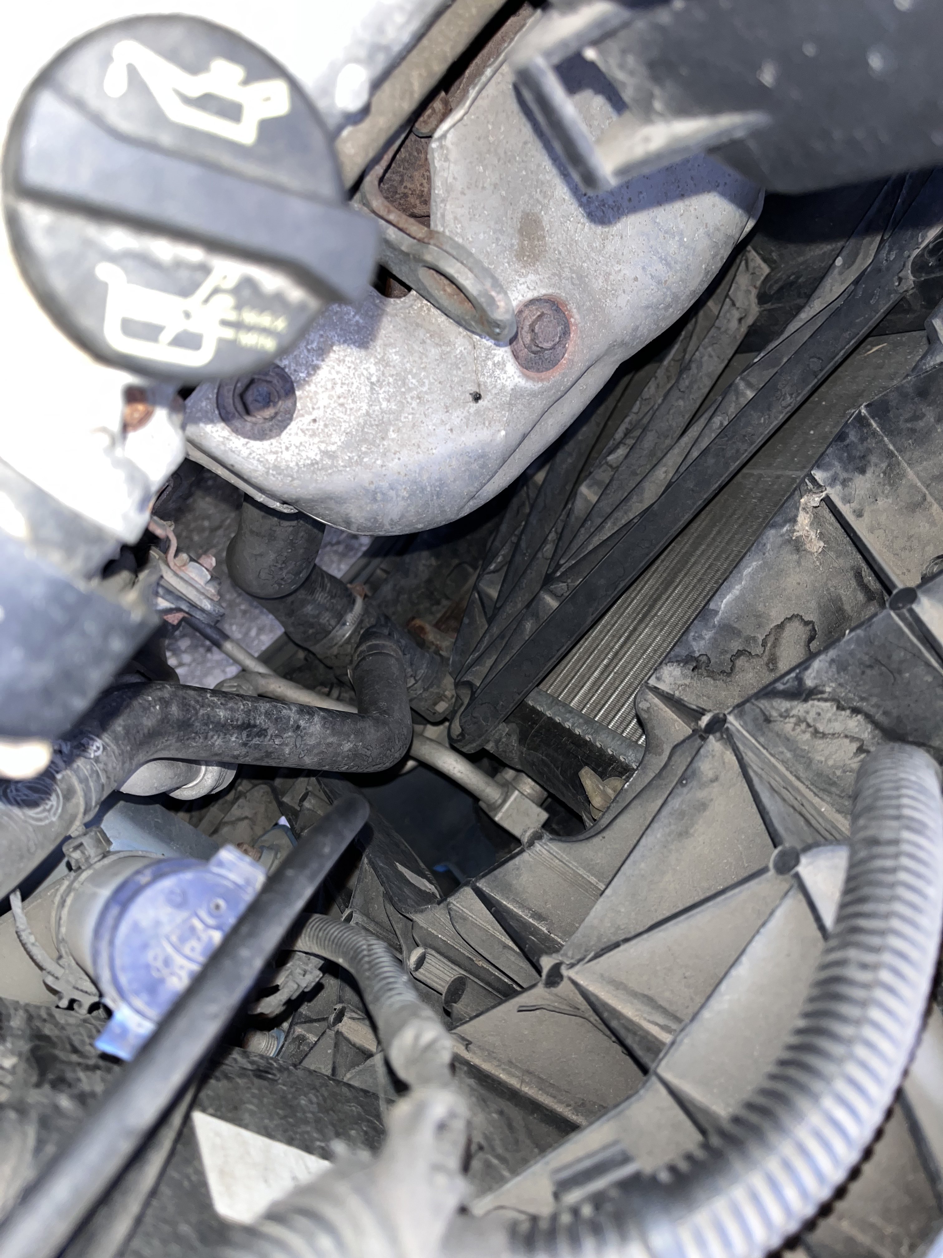

Alright, so… we have a potential culprit for the coolant drain here, near the bottom of the radiator you can see a bit of rust (marked yellow on the second pic). It seems to be like a 100-200 mL loss for exactly 28 days. Anyone knows how much these repairs go for? Is this yet another case of “it’s cheaper to just keep pouring in a bit of coolant every now and then than to actually deal with all of the technical issues since they’re beyond economical repair”?
Important thing I should mention is probably that for the previous 9 years the car had been sitting in a… definitely non-dry garage. The air is quite wet and maybe that’s what caused the rust theres and on the muffler.

Get underneath and see if the underside of these two hoses is dry:
Make sure the two tabs I've circled in red are fully up - they are pushed in to release the bottom hose connector.
I had coolant loss from this quick release connector after replacing my coolant.
I certainly wouldn't want to drive a car that was losing coolant, it can blow the head gasket if coolant drops too low.
Another common source of leaks is the coolant return pipe across the front of the engine.
