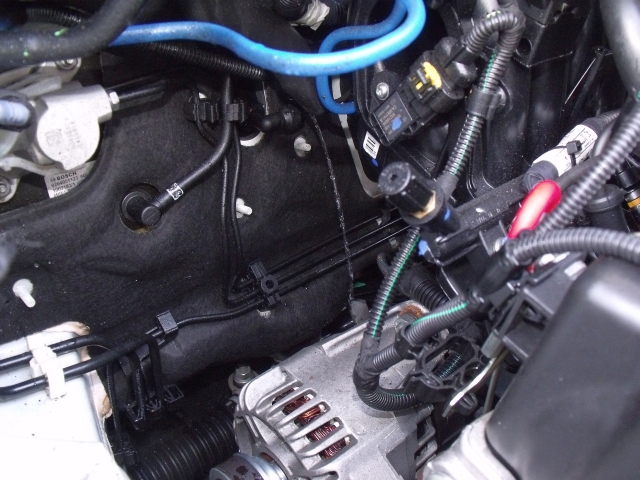

Mozzarella: Thanks for the picture (huge file by the way),. Any chance of pointing out the mod because I cant see what Im looking at . Thanks

The video by Alex shows what happens if you have the correct one fitted.
However if it's a Multijet diesel then it's less likely it'll have a problem, as the layout under the bonnet is slightly different & i think the alternator is placed out of harms way on the diesels.
both of those videos are of cars without aircon yes? as mine looks to have a huge aircon unit above the alternator would mine still be affected![]()
Although it's fitted the wrong way round. It should drain to the N/S (behind the alternator) on petrol models, and to the O/S for Diesel models.
Service bulletin covers both petrol and Diesel. Alternators are mounted in similar positions (behind the block).
The car in the video above does have A/C.
In my experience, the majority of alternator seizures were on models with air-con, which incidently have an expensive alternator with unique design, of which weren't available from anywhere but Fiat.
Be my guest if you think you can fit it like that! That's the only way I could get it to fit, plus it doesn't drain on the alternator anymore so problem sorted!
