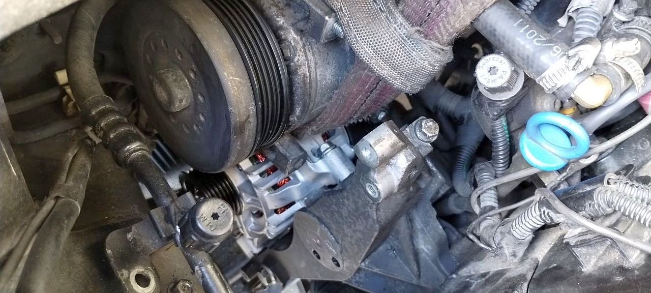

You can support the AC and remove the bracket/mount. Bracket only. Without the alternator (picture below is an assembly stage - new alternator).
Take it out, you're punishing yourself (easy, straightforward job, additional one or two bolts and nut to undo), then repair the threads (remove broken bolts) on the workbench (way more convenient than right angle drill attachments etc., or welding on the car - forget about it, you'll set it on fire).
Without the brakcet, alternator install is easier. You put the alternator in place (from the top of the engine, timing belt side), then slide in the bracket.
Clean the bracket (important electrical part - provides earth/ground to the alternator)...

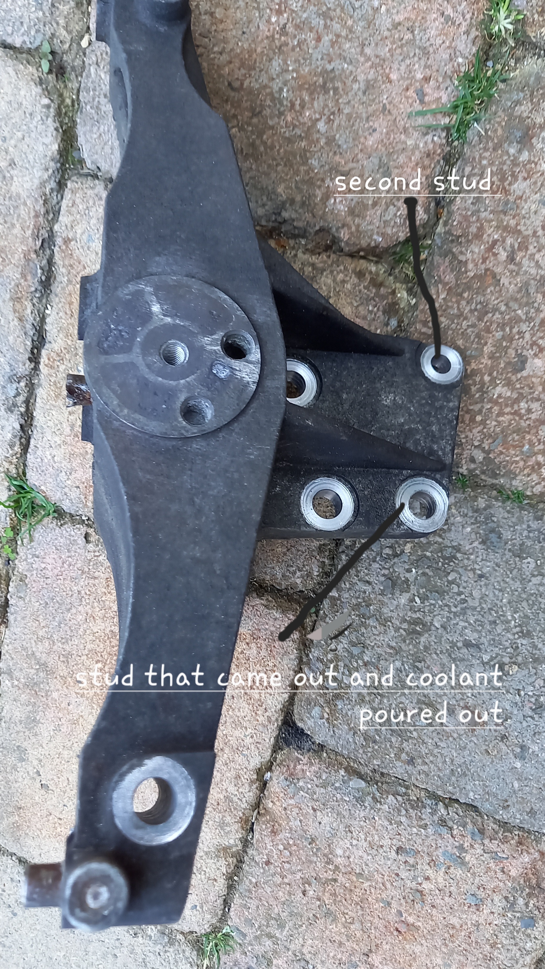

After undoing the compressor and the 5 bolts on the bracket and the tensioner it still would not move.
I could feel two studs with nuts on them towards the front past the tensioner area.
One came out easily but when I undid the second one it was siezed on the thread and unscrewed the stud ........
Then coolant started coming out so I replaced the stud as quick as I could.
Removed as much coolant as possable then with a bucket under the car I took the stud out and some more coolant came out.
The bracket was now loose and has been removed.
My bracket does not lie flat like the one in the picture as it has and extra mounting by the tensionr mount area (see the ePER link in first post)
Hopefully will be removing sheared bolts tomorrow.
Thanks for the info:cool:
Small update have been able to clean up several threads and reattach the stud that came out.
Need to get some longer M8 bolts.
Image to show the extra bracket and stud holes.
All back together now just have to get a drive belt fron halfords @ £13.50.
