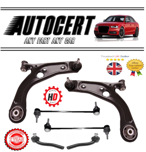

whats a uprated version ?
These are example only. I have not used these suppliers.
The 100HP version is usually about £70 each so these are not bad.
100HP type https://www.ebay.co.uk/itm/Track-Co...474200?hash=item2165d674d8:g:xncAAOSwCH9d3Q2o
This is the ordinary version https://www.ebay.co.uk/itm/FIAT-PAN...:Panda&hash=item365c971932:g:IV4AAOSwjLZeNCgC
From my experience they aren't worth the money. Just buy the cheap ones that are about £20 each. They last longer.

I went for the "correct" 100HP bottom arms, because there were reports that ordinary spec arms don't last very long on 100HP. I did not relish paying silly money and had to wait ages for delivery but did not want to be doing the job again. Was I mistaken?
what we know
100HP and standard arms measure the same size
The casting numbers on the arms are the same. There is one exception shop4parts have a casting thats different.
some online shops grind off the casting numbers so they can't be compared
every s/h UK 100hp I have seen has the different bush
s/h 100hp arms from Italy May have either type of bush.
You can by both types of bush. In fact there are three types. 100HP, standard and there is an unusual oval centre type.
The different bushes are listed as equivalent just different manufactures
personally I like to change like for like
I wouldn't have a problem putting standard arms on a 100HP because this has been done in the factory
I not so sure about doing it the other way round though due to the extra vertical movement. As the bushes are listed as equivalent I doubt it would cause an issue, but having never seen it from factory so probably stay with the cheaper and easily available ones
I would be very surprised if the ball joints were different though and thats the bit thats worn out. Should be Good for 100K unless the cover gets damaged.
I don't have any proof but the 100HP but the steering with stiffer arms does feel more accurate than the Dynamic 1200. Unfortunately, the latter has the original 13 years old bushes so its not a fair comparison.
I was really dissapointed. With those bushes I was expecting the arms to last a good while, but there are complete toast with about 18months and 12k miles on them.
I would never waste my time on them again.
