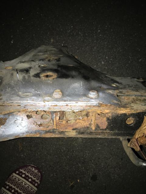

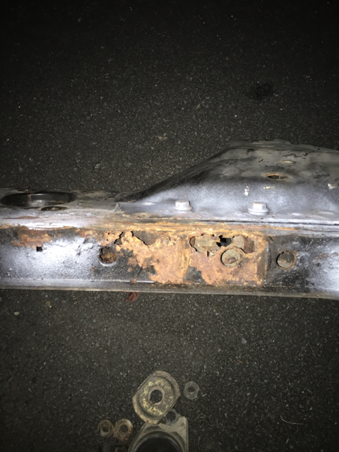

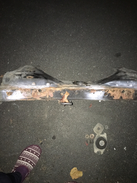

Some pics of the rot....
Rest of the subframe was perfect.
Marty.
No it's the box section at the back of subframe.. behind steering rack. That's a good bit back from the battery isn't it?... plus the corrosion is on both sides, I'd put it down to poor treatment/coating day one.
Marty.
