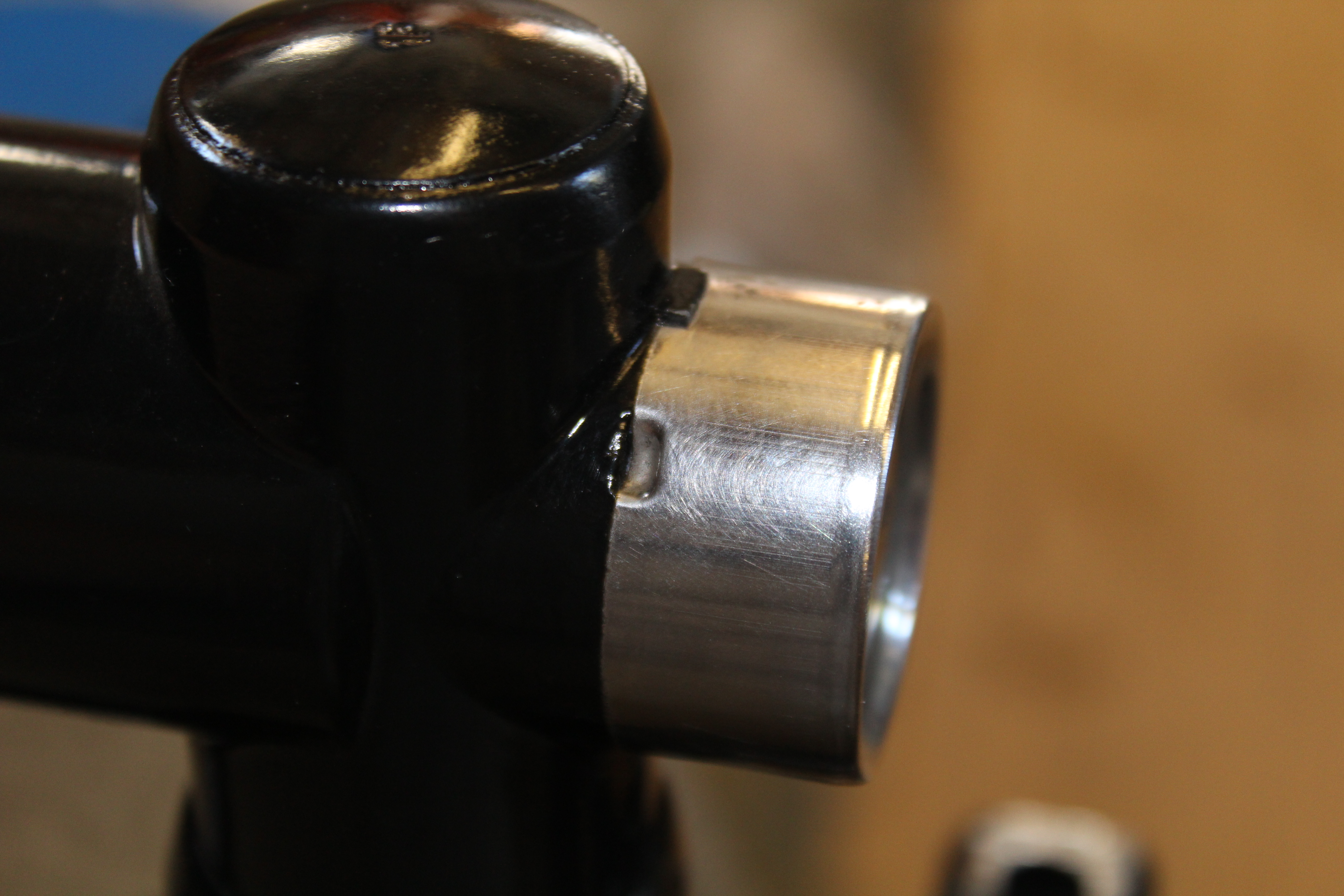

Slight problem last night, key broke off in ignition, unable to remove the broken part and unable to start the car or disable steering lock.
Had to call RAC breakdown for recovery home. 3hr wait, got in at 2:15 this morning.
Has anyone ever removed the lock barrel from the column? I never stripped mine that far. I think I need to remove the switch first to remove it.
Hopefully remove column tonight and have a look.
Removed the steering column. Had to remove the dash pod, undo the wiring to the column, loosen the steering box and then release the column undoing the top and bottom bolt.
I managed to remove the lock mechanism by sliding a thin screwdriver down and lever the sprung loaded section away from the column slot. Once removed I decided to pull it apart.
Starting from the back there is a large spring clip that once removed allows all the switch components to be removed. I didn't need to do this I found out after.
The front part has a stainless steel cover on, this is held by 2 tabs that have been punched into recesses, with a small punch and screwdriver these were prised open and the cover removed.
The main lock is held in place by one rivet of sorts, of which after drilling out allowed the lock mechanism to be released.
With the lock removed the broken segment of the key could be removed.
Now all I need to do is see if I can find someone to make a new key using the old key and the lock. Then its just a matter of re-assembly.

Glad you got it apart.
Big problem with people who try and start old motors on the key, rather than pulling the start lever, or pushing the start button.
Same problem on my old LandRover, button start.
I make sure I am there when the MOT guys starts the engine, "do not try and start it on the key you will break it ", LandRover ignitions are more fragile than Fiats, and very expensive to replace.
Could have been damaged at the MOT.

New key from ACME locks, ignition lock and column back in!
