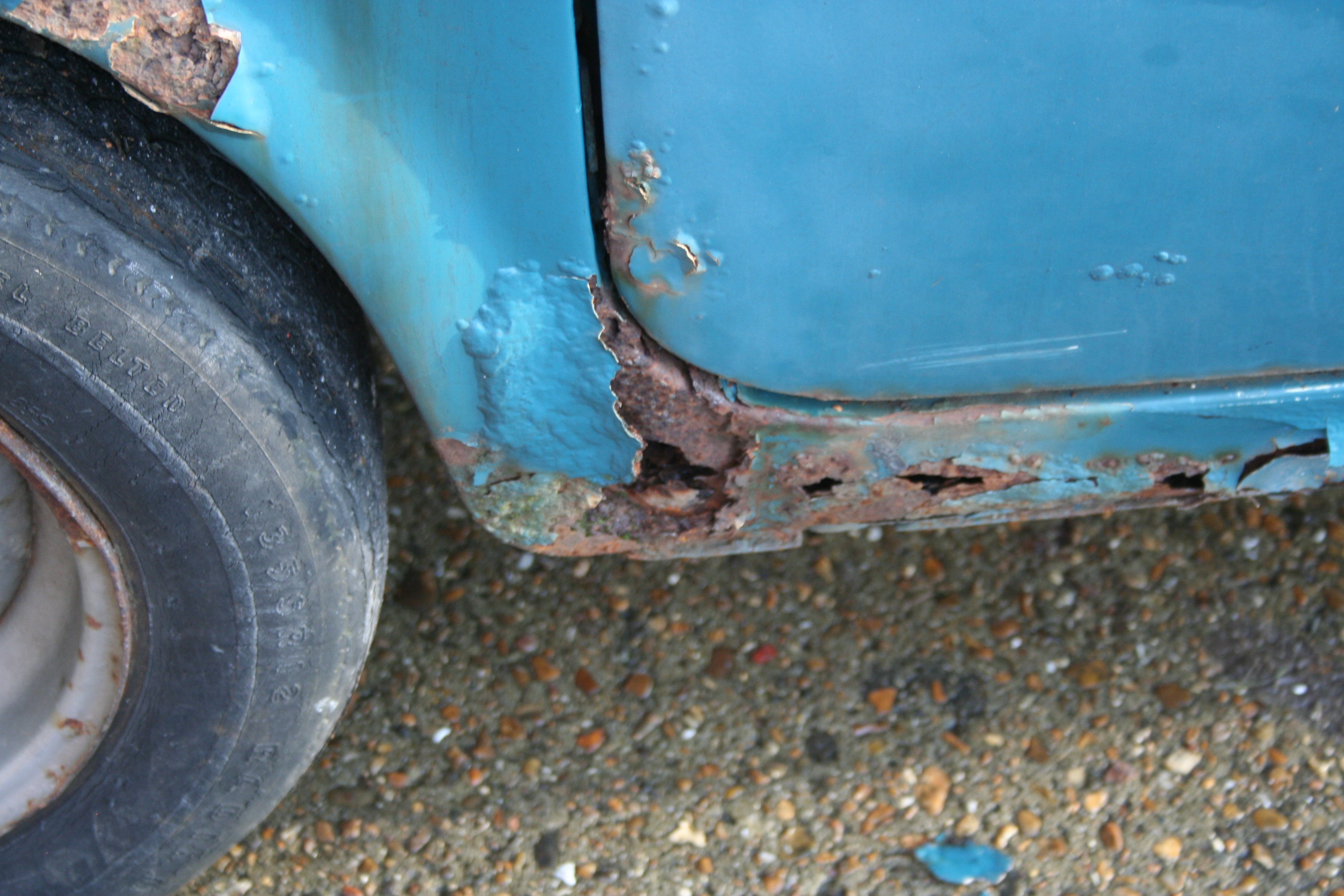

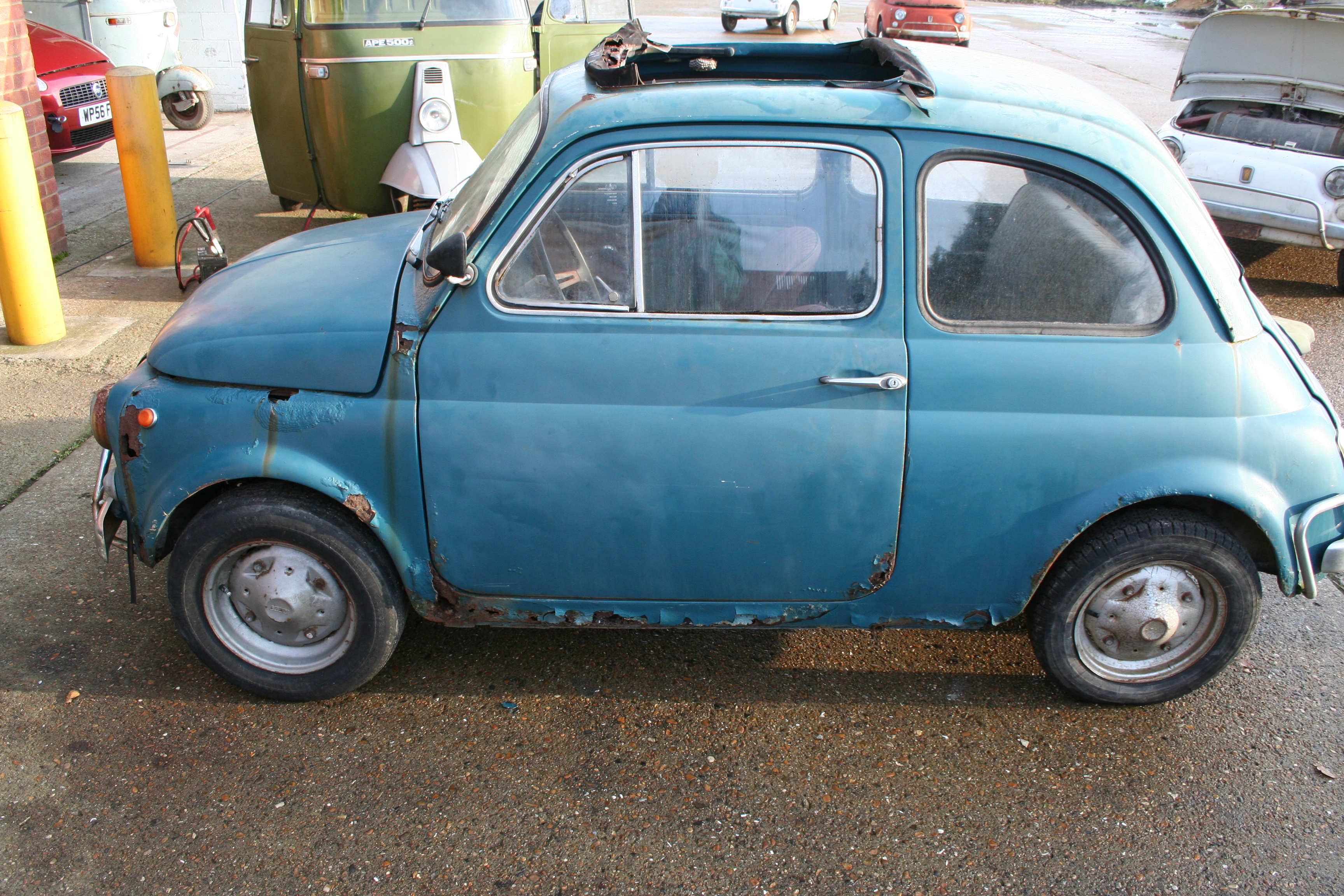

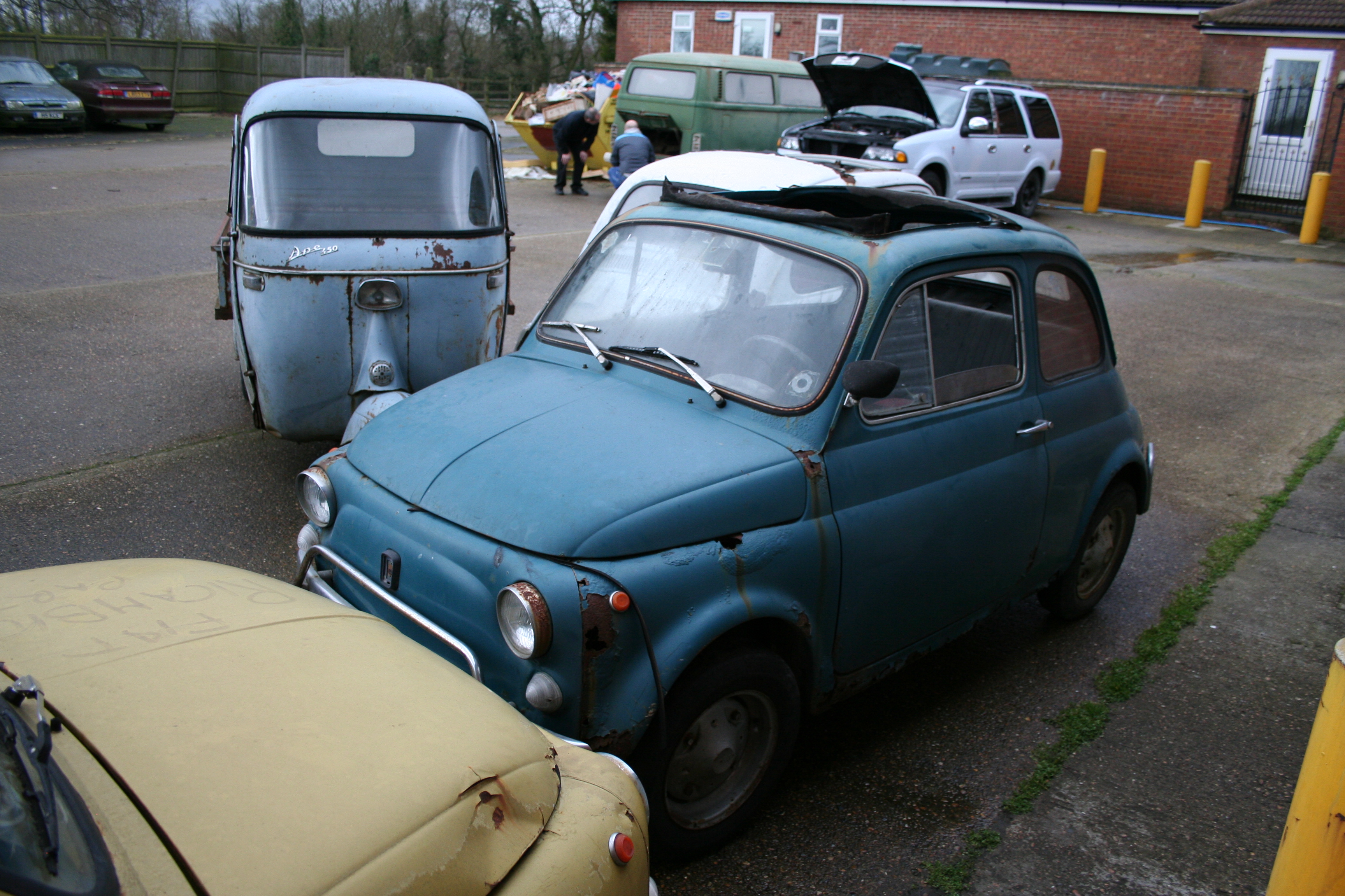

Hi all,
I have just purchased my latest project a 1971 Fiat 500L that has recently been imported from Italy. Of what I can tell from the logbook & history the car has been off the road for about 20 years! Unfortunately it appears to have been left outside and the sunroof has deteriorated & water has gone inside. So the restoration begins.
I used to have Mini's so I am used to small cars, but boy these are small.
Not sure where I am going with this yet, Original or tuned.
Look forward to any advice fellow members can offer.

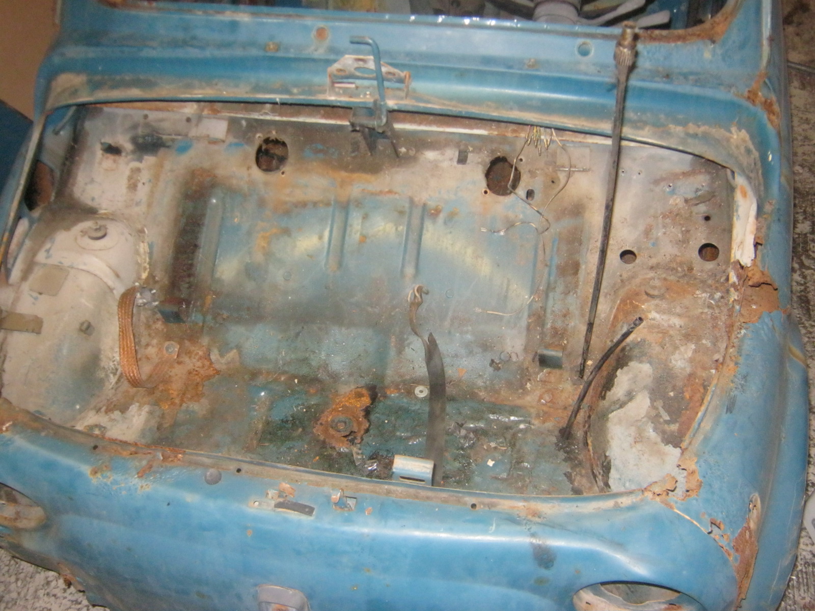

A few more house jobs to finish and then within an hour I had the engine & box out(these are so much easier than the Mini's to work on & no engine hoist required.
I didn't even scrape my hands. That's one thing you always do on a Mini. And what a pleasure not to have to drain antifreeze and then spend the next hour lying in the stingy stuff trying to get bolts out. All the bolts came out without one snapping on me. I was starting to like this car!
Well that's it for this week. Back to work so I might get an evening or 2 out there to strip out the tank & electrics. Leaving suspension & steering until I need it out.

Removed the fuel tank, dash & wiring loom last night. Not much left to go now before Franko is naked. Bulkhead looks ok, its covered in oil so will be messy to clean but at least that's not rusty (the only part that isn't!)

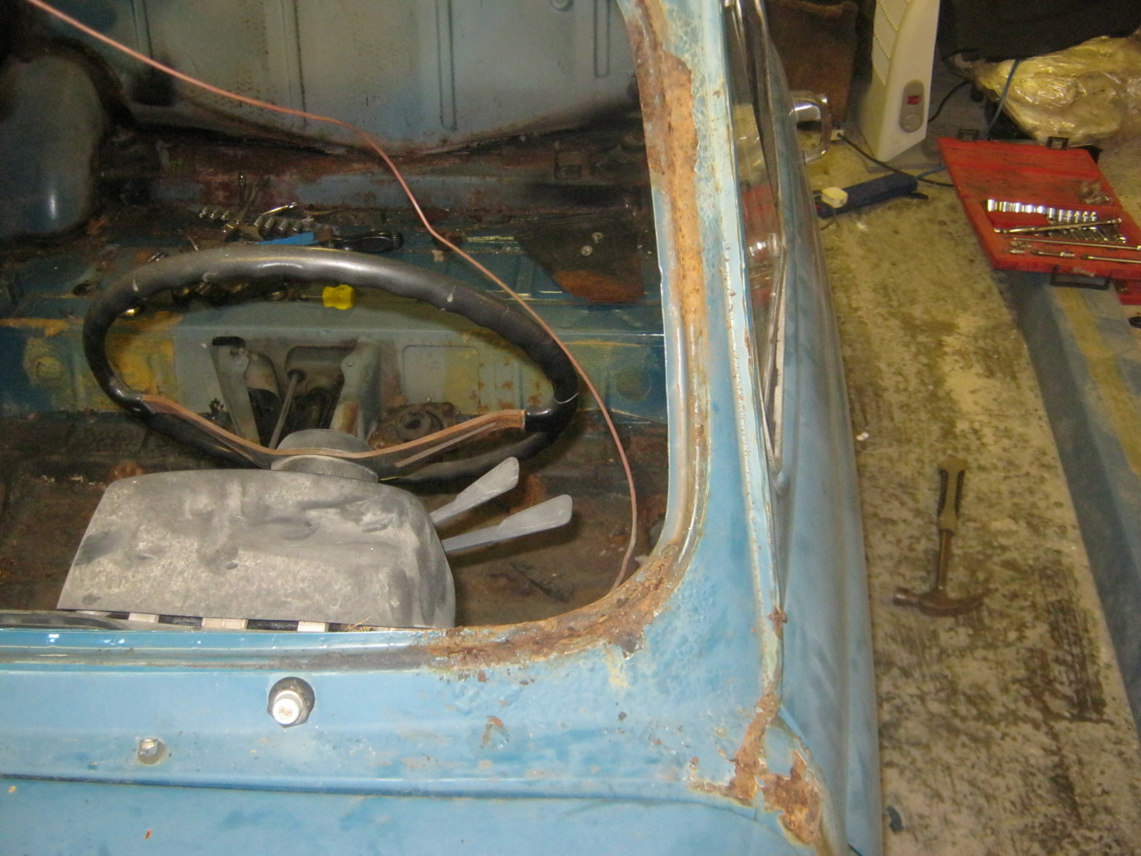

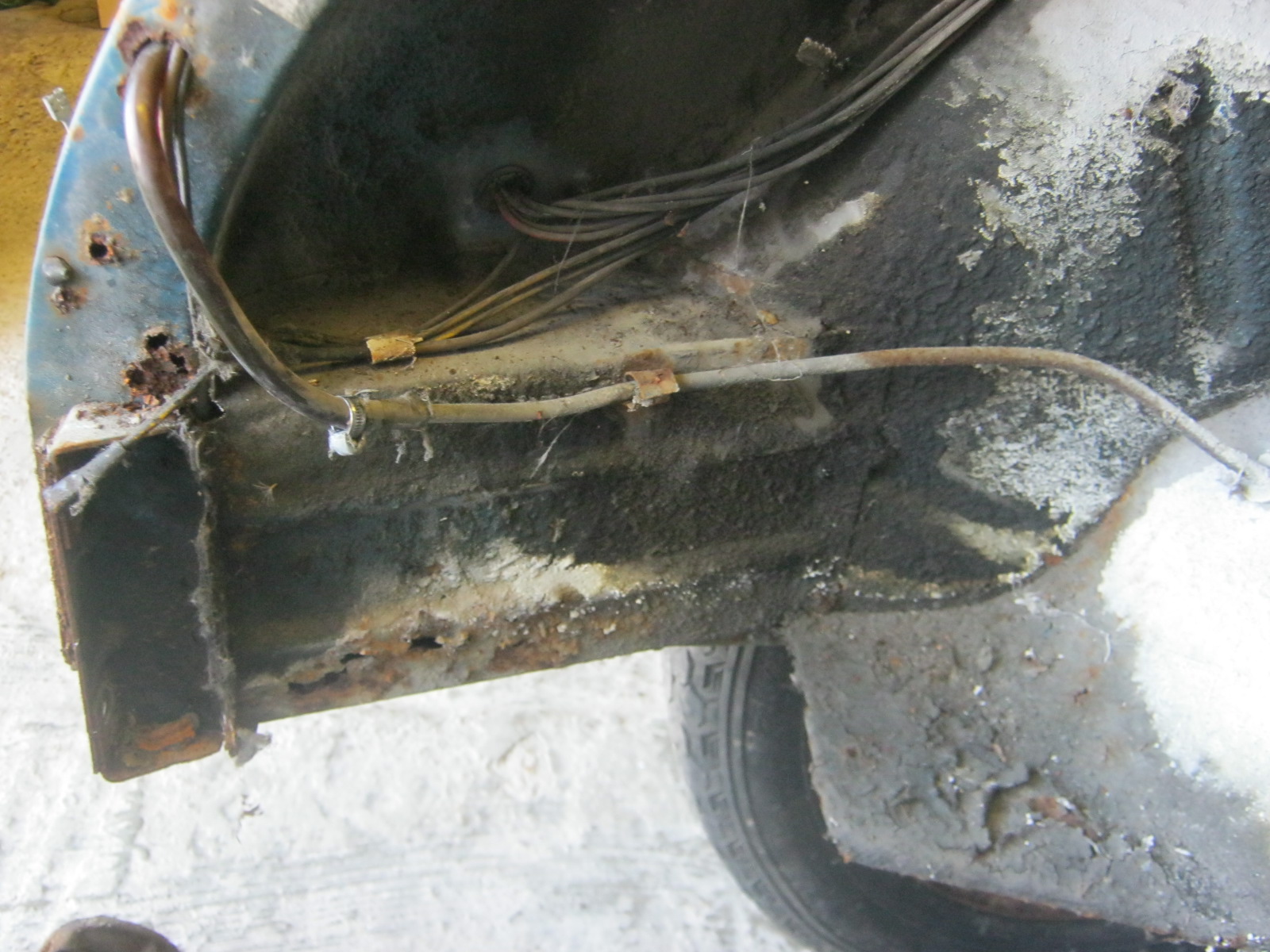

Decided to get the grinder out today and make a start.
Cut off the front panel (didn't take long) & the nsf wing. Its clear that the wing and inner arch have been replaced before as there is remains of an old wing underneath. Removing the wing made my mind up to replace the inner arches as they have heavy surface corrosion on the inner side. Good news is the upper A post looks ok. It has light surface rust that will clean up, especially if I get the shell sandblasted before fitting the outer panels.
I also cut out a section of heavy corrosion on the ns screen pillar and made up a new section & welded it in place. This turned out quite nice, a thin spreader of filler is all that is needed to finish this off.
I have cut out the lower scuttle panel rust as well and have decided to repair this rather than replace the panel, that's £100 saved, Hoorah!
