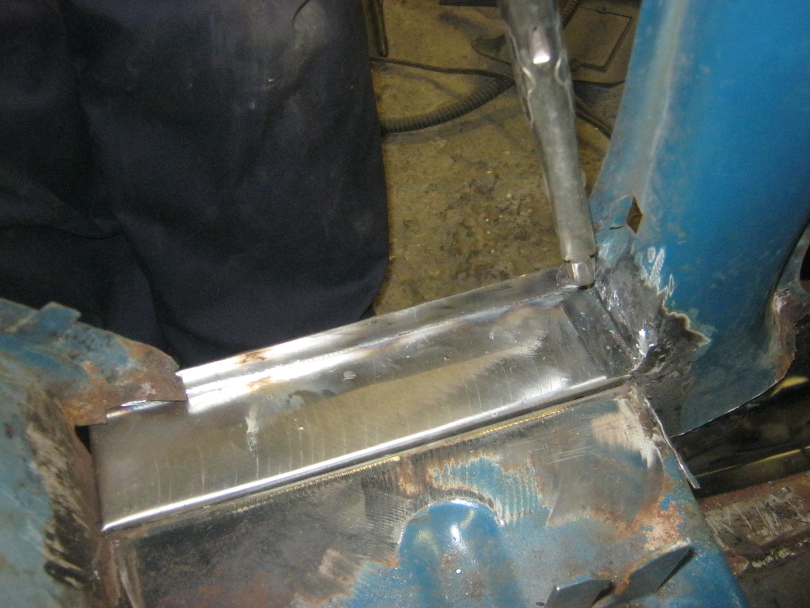

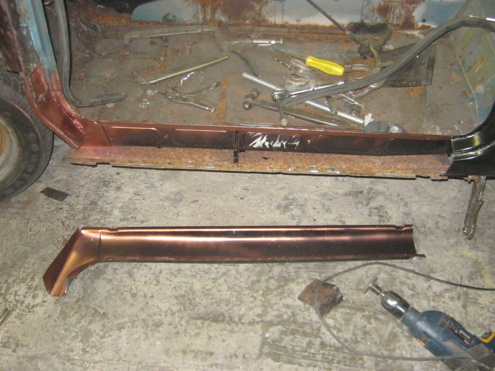

Well, I have now completely removed the ns sill. I have made up a new section of the inner A post. This provides strength to the Door post and also makes the vehicle more rigid. Plus it gives me something to weld the inner sill to.

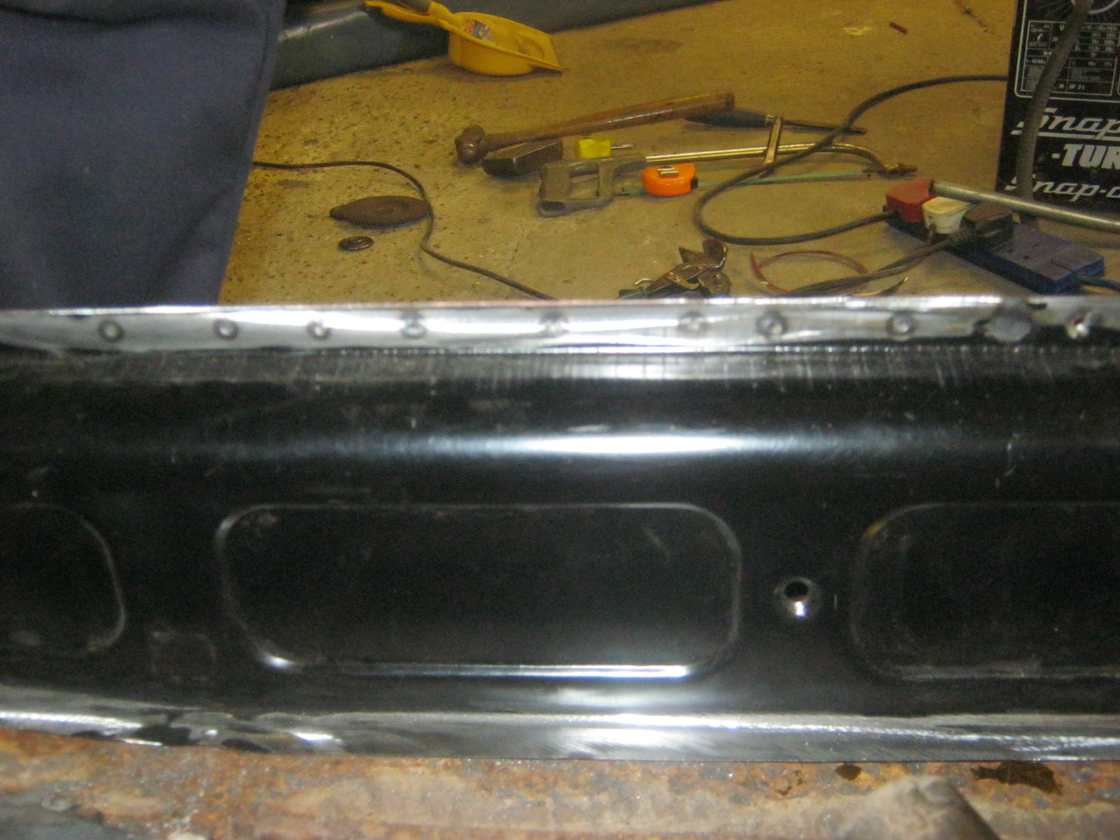

The new inner sill has been welded in place, and taken off the black paint on all surfaces that may need spot welding, coating surfaces with zinc weld through primer on those that will be hidden to prevent corrosion.
The rear seat strengthener is welded in place.
I then removed the lower rear section of front outer/inner wing giving access to the lower A post and front sill section. This allows me to be able to cleanly remove the last remaining section of the outer sill.
When I first offered the new sill up it had the correct gap at the back but a massive gap at the front. With a little grinding on the lower A post I soon got the sill to the position required. First clamped in place with vice grips and when satisfied I drilled some 1/8" holes through both panels and used a few self tappers to hold in place as these give more access when opening the door and also give me some solid reference points if I need to remove the sill again.
With the outer sill nicely in place I noticed the lower front edge of the door was sitting in slightly. I did notice this when I first fitted the door but presumed it was due to the front wing had been replaced.
Mark from Motobambino did mention the doors did have a slight problem with the front lower corner, but as he said with a few taps with the hammer on the inner edge of the door skin, the contour lined up lovely with the sill.
