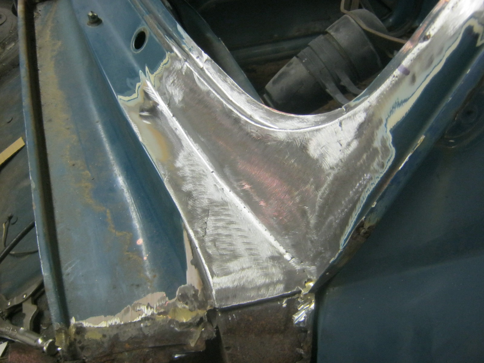

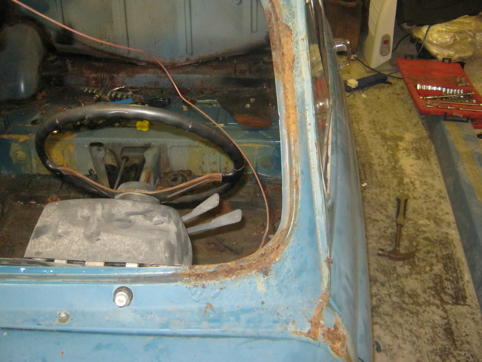

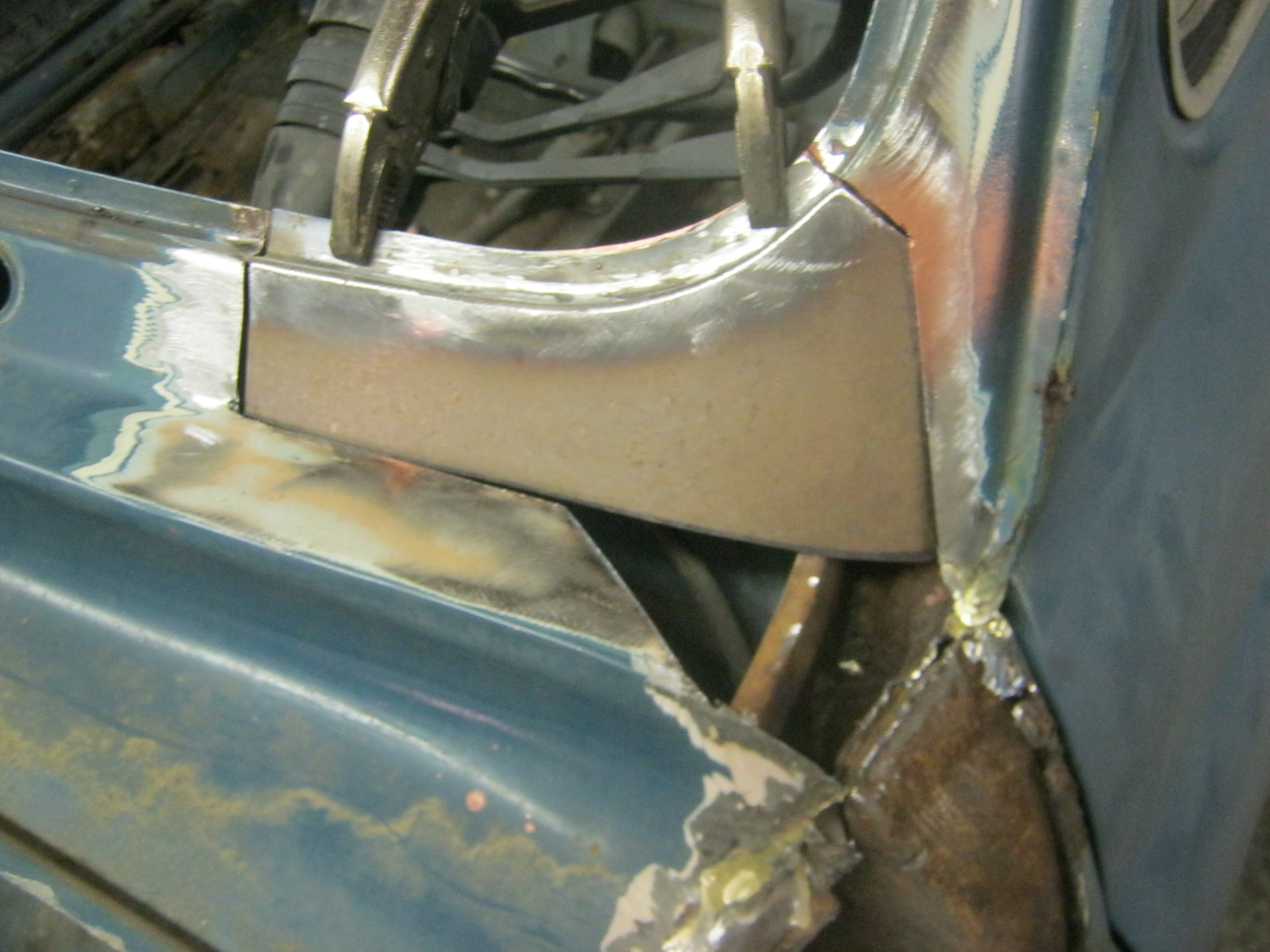

Another job done. Getting back into the swing of this.
There's a few more of these small repairs to do around the screen aperture and then time to move on to the major stuff once my new panels arrive (got to order them first!)

Hey Sean I think we are starting to see what a master with the metal you are. Top quality work, I think this thread is going to prove to be very interesting.
Tony
Really nice work happening here - how are you forming these small pieces with such ease???
Thanks Dunnah01,
Just basic panel beating/restoration process.
1. Decide how far you need to cut back to get rid of external & internal rust.
2. Think about how you are going to form the panel. 1 or 2 pieces depending on your skills & equipment.
3. Make some cardboard templates for the pieces you want, these can also be used to make sure the contours are correct when forming the panels & to help line up before welding.
4. cut your pieces from sheet steel (same thickness or slightly thicker in some places to add strength.
5. Form them up, you can use jenny/rollers, folders, strecher/shrinker etc if you have the equipment or good old panel beating. A vice, tubes, wood, sockets, anvil, pliers, hammer & dollies or anything else that you can use to shape the metal to whatever you want. You can also stretch metal by keep hitting it, or shrink it using peening method (sharp edge of a panel beaters hammer) or if you have oxy acetelyne, heat it up to cherry red and use a hammer & dolly.
6. one you have all your pieces cut & formed, tack them in place making sure the surfaces are as flush as possible to reduce steps when grounding welds down.
7.When you are happy everything lines up and other parts/panels fit then weld them up an inch at a time to reduce heat distortion. Make sure you get good penetration as you will be taking the top off so you need weld all the way through the panel.
8. knock the heads off the welds with a grinding wheel (dont go too mad) then change over to a grinding disc (36 to 80 grit) and sand the welds flush to the panels trying not to take too much out of the sheet metal - especially Fiat as it is not that thick.
That's it.
If I get a chance I will take a few photos of the next piece I do.

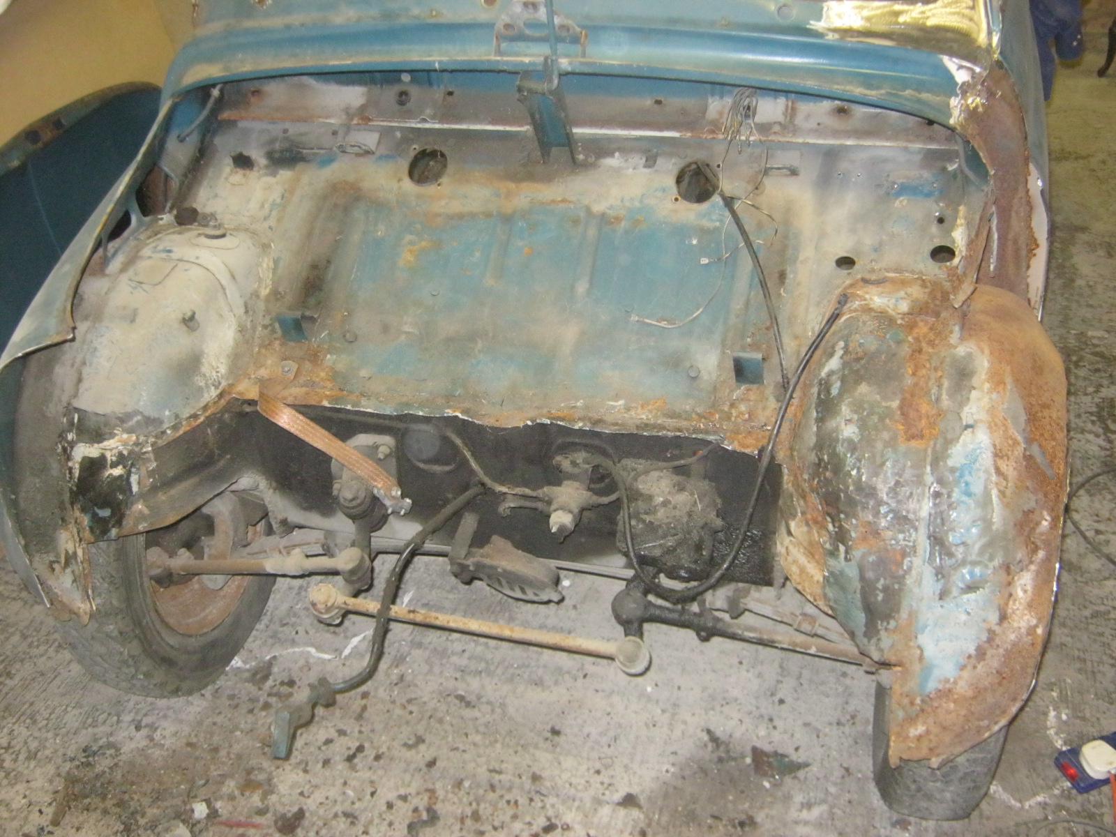

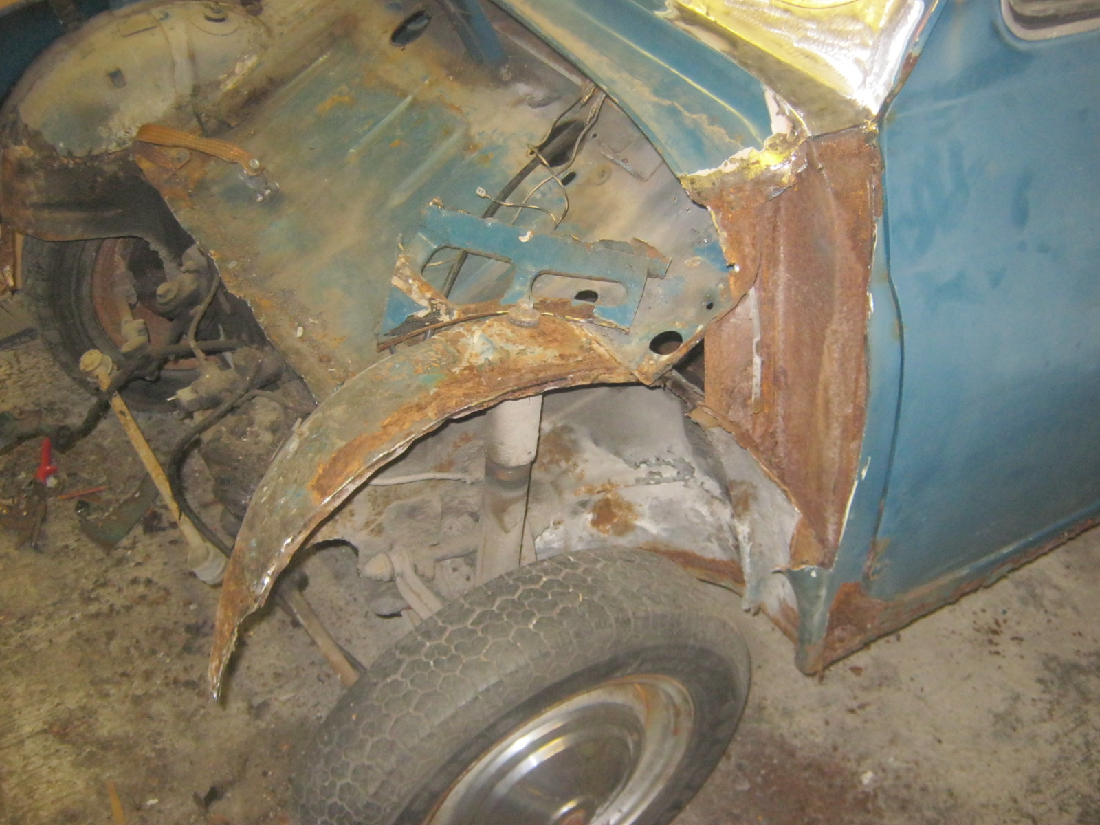

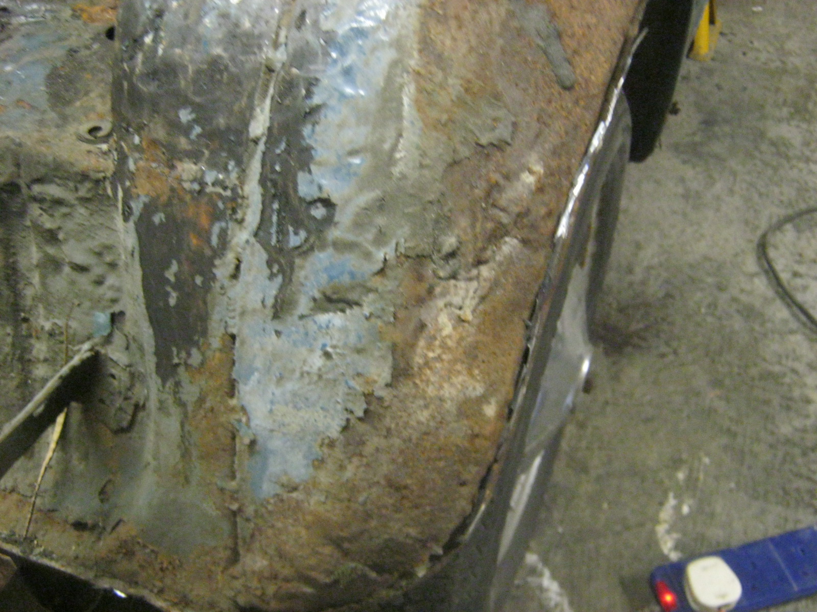

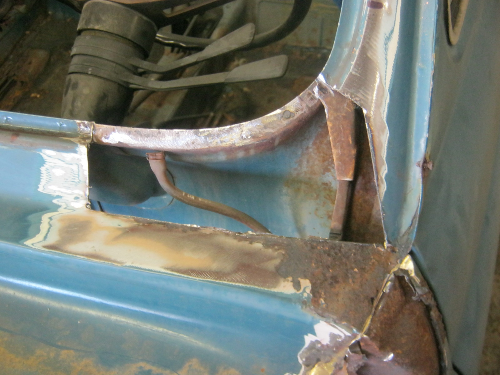

So I thought I would go and do a bit more to Franko. I have cut the inner front panel off -oh dear!
It is clear that Franko has had a prank in his earlier life. The NSF wing was replaced & the front section of the nsf inner arch. So I have cut it off! I have a new one on order so no point messing around.
I should be able to save the little inner wing extension & repair the inner wheelhouse.
It will all look lovely once repaired properly & sand blasted. The back half of the inner wing was only held on by 3 spot welds. Im going to leave the bottom half of the inner wing in place as it will be a guide point for fitting the inner sill. Plus I am concerned over the strength of the shell if I take it out before placing a reinforcer in place. The door hasn't dropped yet so that's a good sign.
Next step is either the sill panels or attempt some repairs on the roof. This is where it could go a bit bandy!

It's amazing when I see pictures like these Sean. My car must have lived a pretty dry stored life I am thinking, as the only penetrating rust I had was a hole in the top of the near side rear wheel arch. How lucky was I.

Tony you were lucky, from what I see these little 500's rot from the inside out as they did not undergo the same anti corrosion treatment as modern day cars. As you can see from the photos, the inside of certain panels have surface rust all over as they had little/no paint on them unless a spray gun got near them with a waft of paint.
