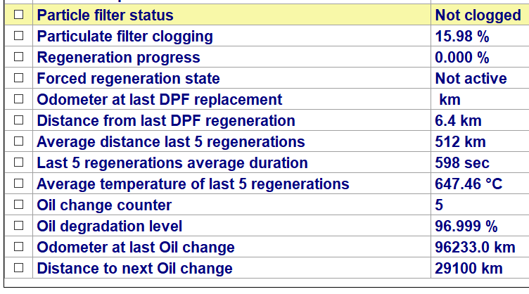

That is how I understand it. No one has yet tried the "pedal pumping" trick with a before and after check of oil degradation status with MES or similar so we don't know for sure it it works properly.

As luck would have it the cable I use to interface with my Triumph motorcycle is the same one for connecting with a Multipla.
I downloaded MultiEcuSacn and can confirm the oil regeneration was reset, so the pedal pumping which turned the light off does work. See below screenshot.
