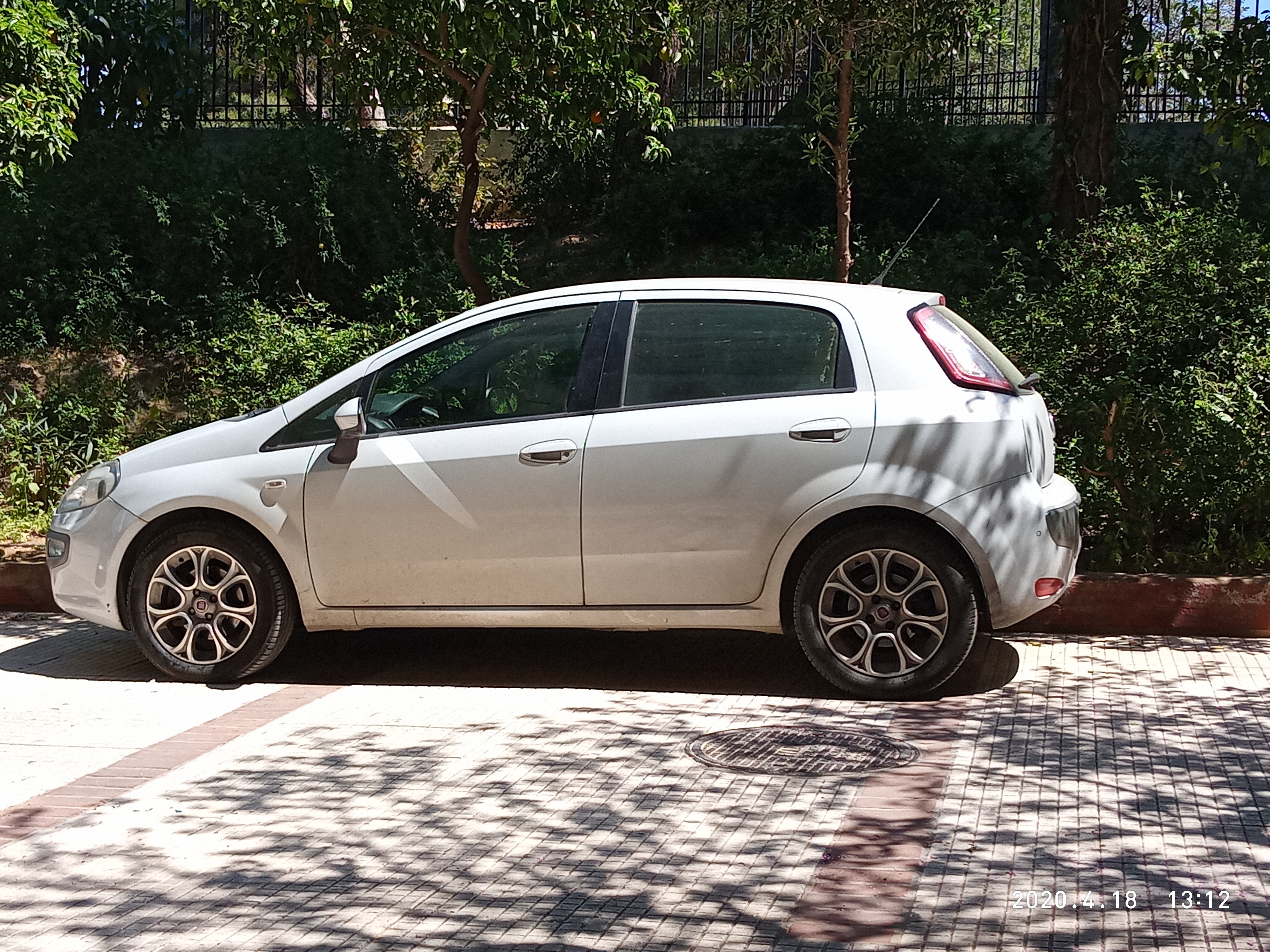

About 6 days ago and done 2000 km from my last oil change at March, "change engine oil" and oil light comes on....:( -I believe they forgot to reset it-so I was searching how to reset it all these days....
Well...:)
Confirmed yesterday! (y)
Pedal trick works on my Punto 1,6 JTD 2010 model! :)
Well...:)
