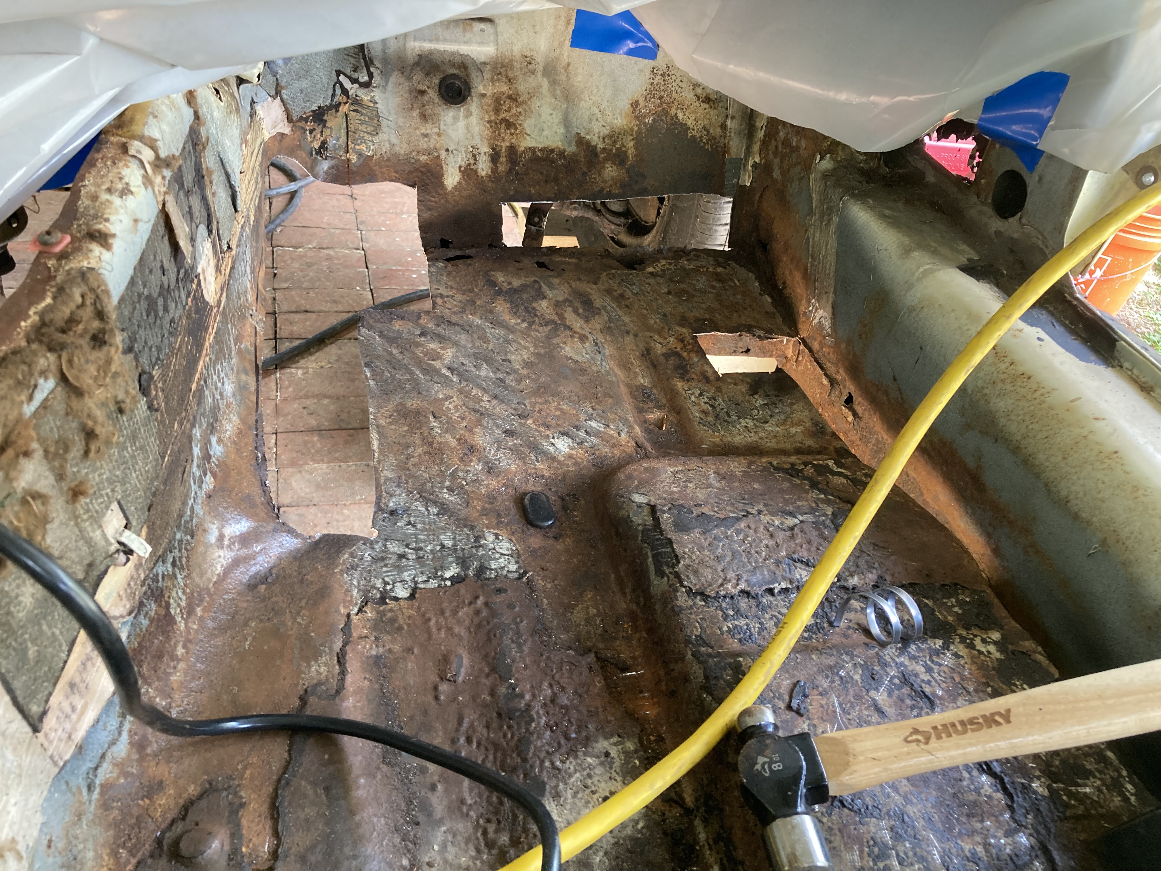

Piecemeal or buy new pre-made floorboards?
1978 124 CS1- and I’m slowly addressing rust issues. I’ve started on the floorboards and would like some opinions as to my next best step. The video is of the passenger side:
Thanks in advance!

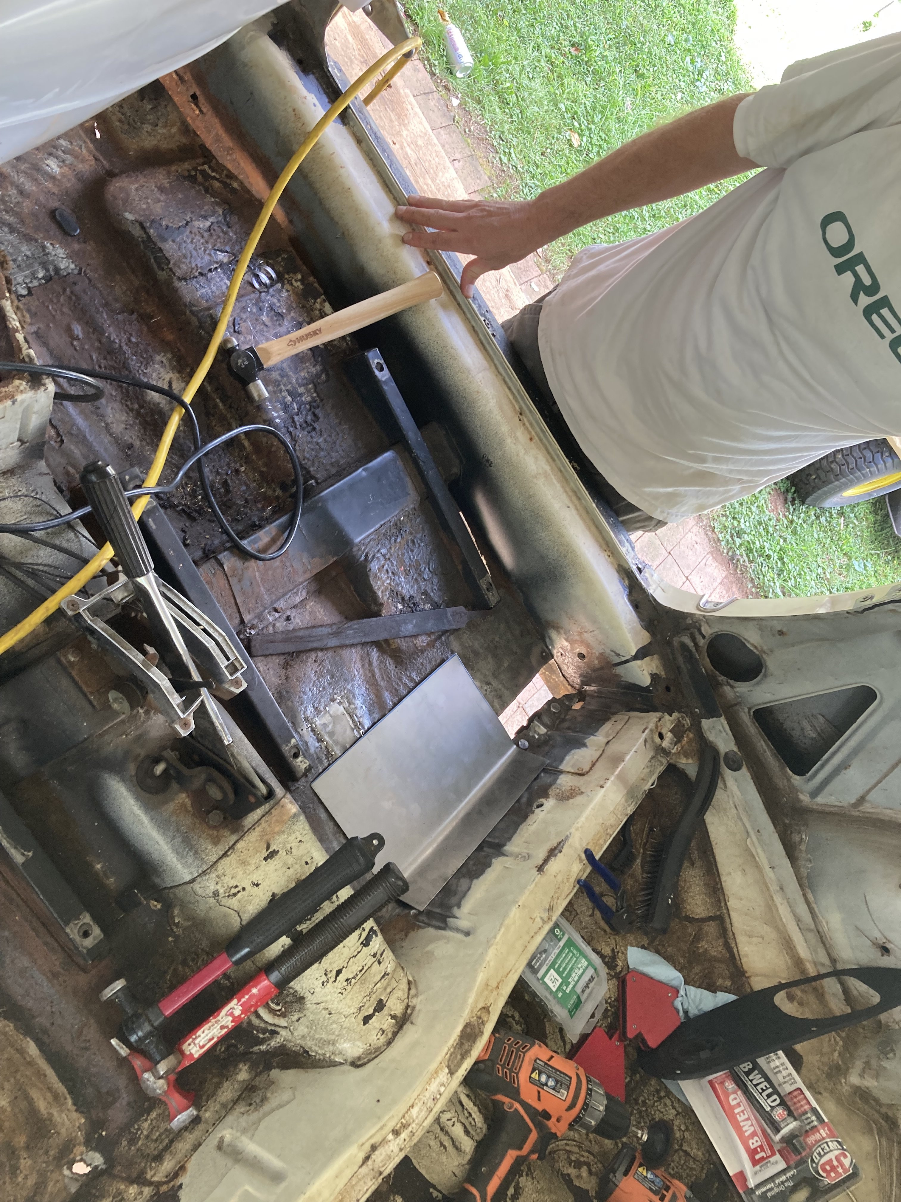

Update: so….. we attempted some welding. It was rough going. My buddies helped - which was great - but in the end we wound up cleaning more, cutting holes to good metal, cutting plates of new metal, forming to fit, using JB Weld and self tapping screws and will follow with seam sealer. It was ugly work! But - it will all be more solid than it is, and will be covered up.

What you are repairing needs to be structurally sound. Self tappers may be ok before you tack weld but dont rely on them for strength. As for JB weld if you cannot weld the parts it is unlikely JB weld will bond the parts
Practice Practice and you will get there!
Yes, as Twink80 said, don't use JB weld for anything structural...., structural areas need to be welded...practice, flip what you just welded upside down and check for penetration, if you burn thru a critical spot figure out how to fill it back in, your welds dont necessarily need to be pretty but need good penetration, with JB weld I've filled pin holes in autobody , and a cracked marine engine block, as well as drilling and tapping it, and in stripped bolt locations with great success , I was just pointing out the marine version is a great deal tougher that the regular version, I was given a lecture about it by a movie stunt driver who said they use it all the time to fix stuff on the set.
As far as the argon/ Co2 you should be ok, I'm not an expert welder but I've chopped a top, done custom body work, and lots of general patch panels with good success with it, I've never had the opportunity to use anything else but i wouldnt mind trying straight C02...dont give up , practice, if you can find some old body panels close to the thickness of your spider in a friend's back yard, cut pieces and weld them back together, in time you will get it! , a lot of time you will be doing tack welds, practice that a lot, it's pretty easy , tack pieces of scrap every half an inch , this is often how you start with a patch...develop a pattern with the tack welds to get the patch in, and avoid warping, giving the spot time to cool in-between welds, then come back to fill in .
