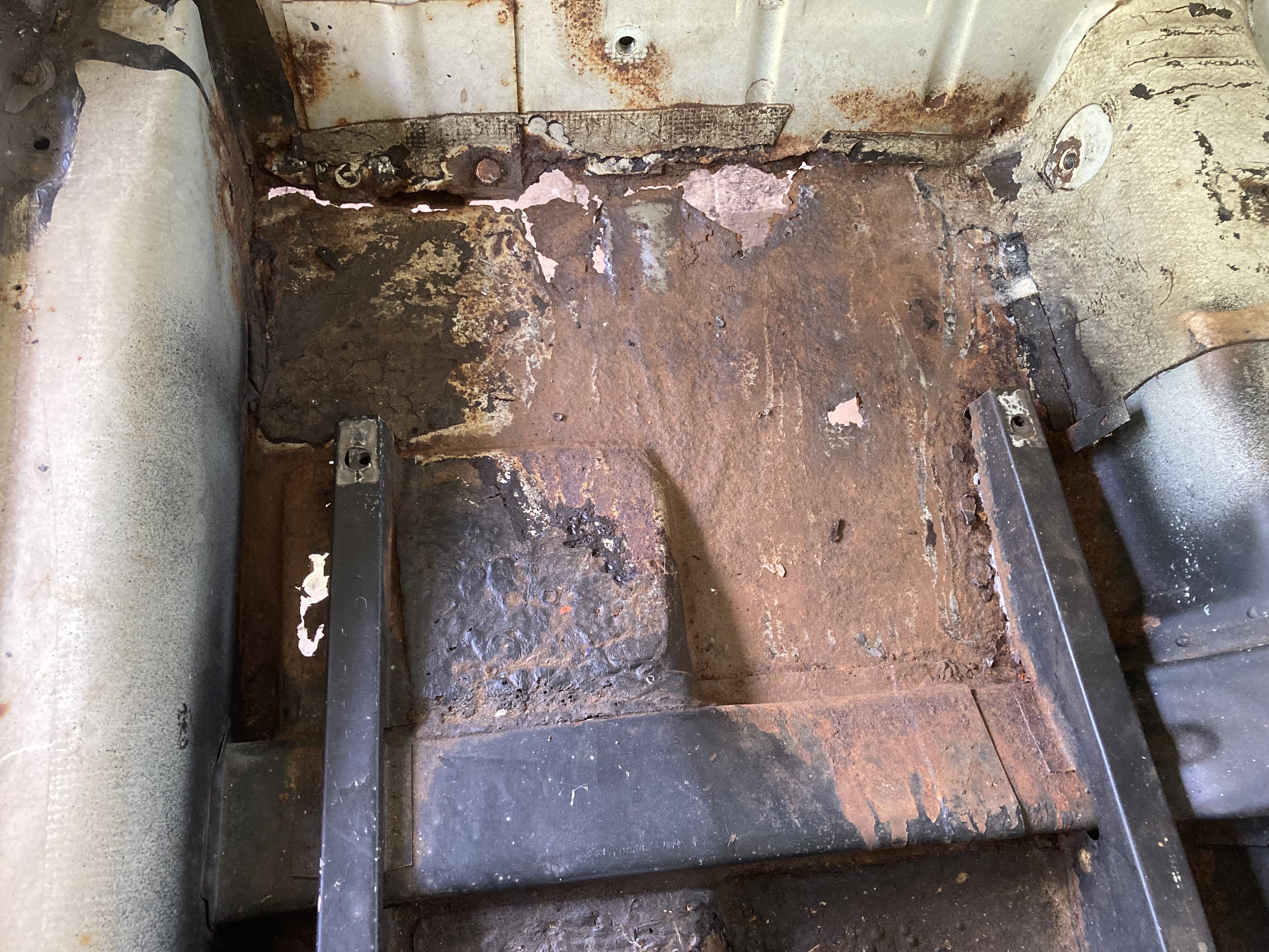

Piecemeal or buy new pre-made floorboards?
1978 124 CS1- and I’m slowly addressing rust issues. I’ve started on the floorboards and would like some opinions as to my next best step. The video is of the passenger side:
Thanks in advance!
I would say if good quality replacement floor pans can be sourced of similar thickness to the original, so you can cut away cleanly all the rusty metal , maybe using a plasma cutter, then a good welding job followed by rust treatment and sound dampening like original you will be well pleased with it.
Much better than trying to patch up or bend steel to the factory shape.

The usual cost vs time vs quality weigh up! I don’t know what replacement panels are available and if they will cover all the area you need.
Looks like you could cut around the crossmember and seat mounts to maintain some datums. You may need to temporarily weld some braces in like the gearbox mount to maintain its location
You can also make cardboard templates for the more complex areas eg curves where the floor joins the sill etc
You might also have to consider which side to weld from as the weld side is sealed the otherside is open and craggy so a good dirt/moisture trap. You can get automotive body sealer on eBay (similar to OEMs use) to seal the seams after welding. Its like a mastic but sets with a skin

To remove the original (factory) bitumen coating on the floor panels inside the car, I used an old wood chisel and mallet (I was hardly going to use a new chisel, was I? and note I did use a mallet, not a hammer - I'm not a heathen!), this took a long time but was controllable and I didn't sustain any injuries.
Some people recommend using a hot-air gun to soften the coating and then remove as much as possible using a decorator's scraper. Some say that using 'dry ice' will make the coating brittle allowing it to be shattered by a hammer blow. Others might recommend using an air chisel or maybe an air-operated needle de-scaler but these will likely punch holes in any weakened metal, plus you may injure yourself... Experts will say sand or soda blasting is the only way but I realise you're working at home (strange that these experts are the one's offering this service for a fee....).
I'm always in favour of minimal cutting out when repairing rust damage (have gotten myself into mucho trouble by cutting out large chunks:rolleyes:) and tend to tackle one relatively small area at a time. Remember that and depressions/hollows pressed into the floor pan are there for a reason e.g. to allow big feet to operate the pedals (Jaguar made this mistake on the early, so-called 'flat-floor' XKE types and had to incorporate a step down for this reason - strange that collectors will pay a lot more for these very early cars, I hope they've got smalll feet). Also, if you omit these depressions, the original carpet may not fit so well.
If you do however decide to buy and fit replacement floor pans, check if they are high enough at the sides to attach to sound metal - the rust often extends above any original perimeter turn-up/attachment, so you might have to make up repair sections to install at the sides before fitting the new floor pans.
Afaik, floor pans are usually installed from above - under the floor pans are various pressed steel strengthening members which will need to be retained or remade if they don't come with the new floor pans, plus consideration has to be given to the seat rail mountings etc.
Before cutting away any metal, it's a good idea to support the sill/rocker-panel ? to prevent any sag being introduced as you cut away metal. The sills/rocker panels are critical on a Spider and need to be in very sound condition (afaik, there is a centre diaphragm? panel inside between the inner and outer rocker panels, these can rust away unseen). Some people temporarily weld a support bar across the door opening to maintain correct alignment but I prefer a support under the sill/rocker + careful measurements of the door opening having been taken before any cutting and double-checked again before any welding is carried out.

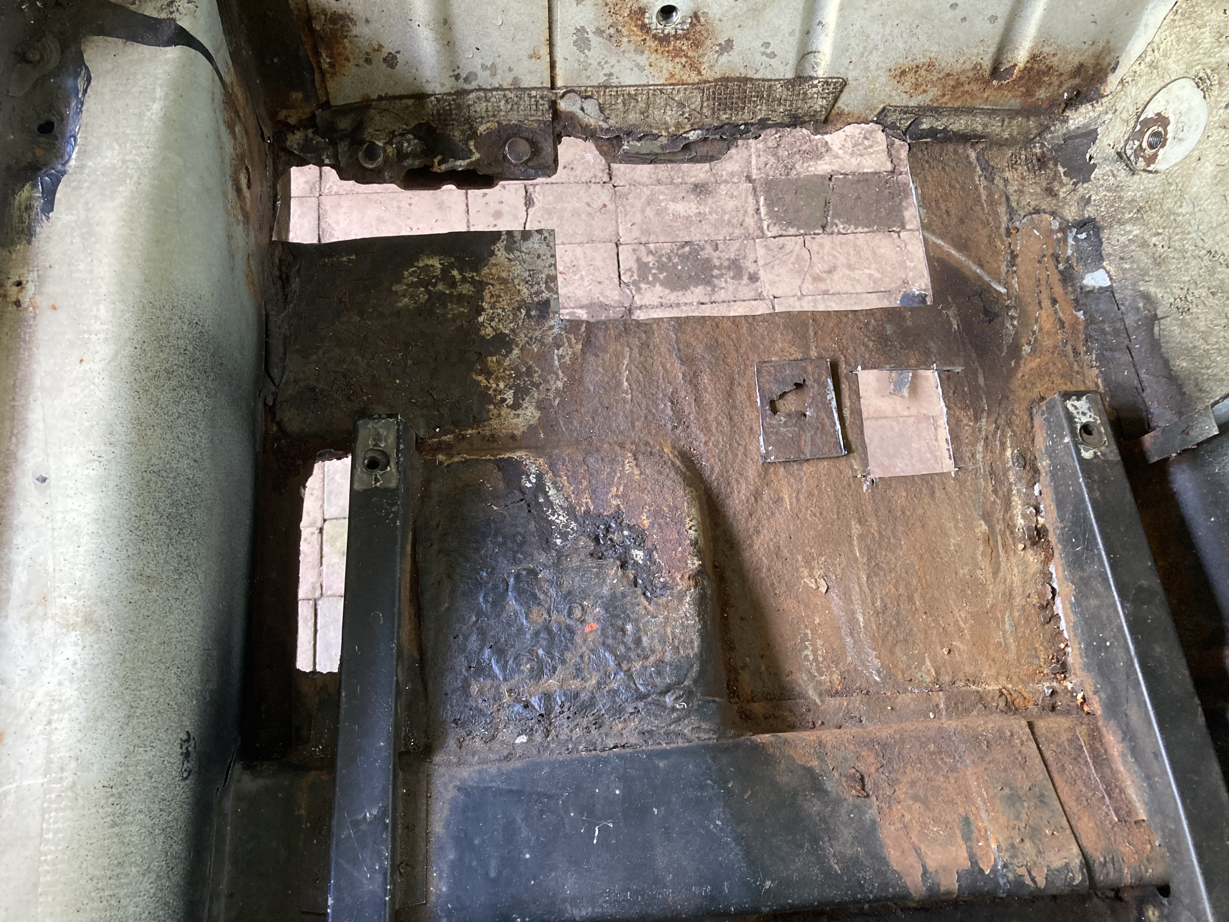

Went with chisel to remove the thick coating. Here is the front of the pass side floorboard. Next I think I’ll run the disc over it a bit, but it seems already clear where I can draw some lines for cutting.
Might I suggest that you try to fabricate and shape at least some of your repair panels to fit before you cut out any metal - this way, the metal to be removed is still there to act as a support for trial fitting - it's a bit difficult, if working alone, to try to hold pieces in place in a big hole.
You could even fabricate a whole repair section for the front floor (what would be under your heels) from individual small shapes, weld them together outside of the car (much easier), trial fit over the rusted area, then cut out the rusted area and weld in your repair section (at least you'll know it'll fit and is the correct shape/size.
Alternatively, you can temporarily hold repair pieces in place with welder's magnets, pop rivets or sheetmetal screws.
I've learned to try to keep the repair sections as small as possible (consistent with cutting back to sound metal and a solid and safe end-result), i.e. don't get carried away with the cutting out.
P.S. Get plenty of practice in on Mig welding (iirc, this is what you intend using) before attempting to weld in repair sections - it's very disheartening to keep blowing holes...

Passenger side rear: more cleaning with wire brush and ailing areas were clear. Note the eroded bits on the trailing end of the seat rails…
After drilling and marking around areas, and cutting and grinding. I’m trying to make things as square as possible - just to make the fabrication easier. Not done with the edge across / under the rear main support structure - working to keep the supports for suspension solid while removing and replacing the rusty stuff around. Comments, laughter and exhortations welcome. (First time I have ever done this…)

The small angle grinder with twisted wire, wire brush attachment would bring the metal back to shiny steel , which if MIG welding, is what you need to get a good weld, then once you have metal cut to shape , tack it into place where you want it and then just move along to different areas to join the "tacks" together without too much heat distortion which can happen if you try to do one long smooth weld.
It also gives you time to check underneath to make sure nothing has caught fire.;)
A reasonably powerful Mig welder even on a low setting will do a better job than a cheap one on a higher setting and a bit of practice on some similar thickness steel will help get the welder settings right before you start the serious stuff.
A good "reactor" type welding mask and of course welding gloves and other protection will be important too.:)
