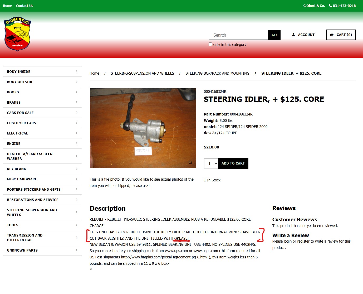

People on various forums recommend using grease instead of gear oil in the steering box and idler box - I suspect this is to try to prevent oil leaks. Would you install grease in your shocks as a solution if they were leaking oil? I don't think so.
The correct solution for oil leaks is to strip and rebuild the units, replacing any worn bushes/bearings (so shaft's don't wobble around and impair the seals operation) and then fit new seals.
Steering box rebuilds can be very costly (if you can source the parts), so-called rebuilt/overhauled boxes supplied on an exchange basis depend on the ability and integrity of the person doing the rebuild...
I've seen mention that internal parts are not available for the idler box but that the oil seal is still available.
Some resort to fitting the other type of idler box that was used on various Fiats (+Ladas), i.e. the non-hydraulically damped unit that has simple bushes.
This I regard as a retrogressive change - Magazine Road-testers, back in the day, commented on how much nicer the 124 Sport Coupe and Spider steering was due to having needle roller bearings on the st. box output shaft and a hydraulically damped idler box.
There's another thread currently running on here by S854 ("Don't hate me..." Apr 16, 2026) who has bought an early restored 124 Spider on an auction site, he supplied a link to the site and opening this site and clicking on 'Comments', revealed various Q's and A's about this car - someone from Fiat Plus (supplier of genuine Fiat parts) / C.Obert & Co. provided current info re the idler box/availability of parts/ changing to bush type idler box etc.
Here's a page from FiatPlus concerning a 'rebuilt' Idler box, it mentions the box being filled with grease and the internal wings being cut back.... :-
