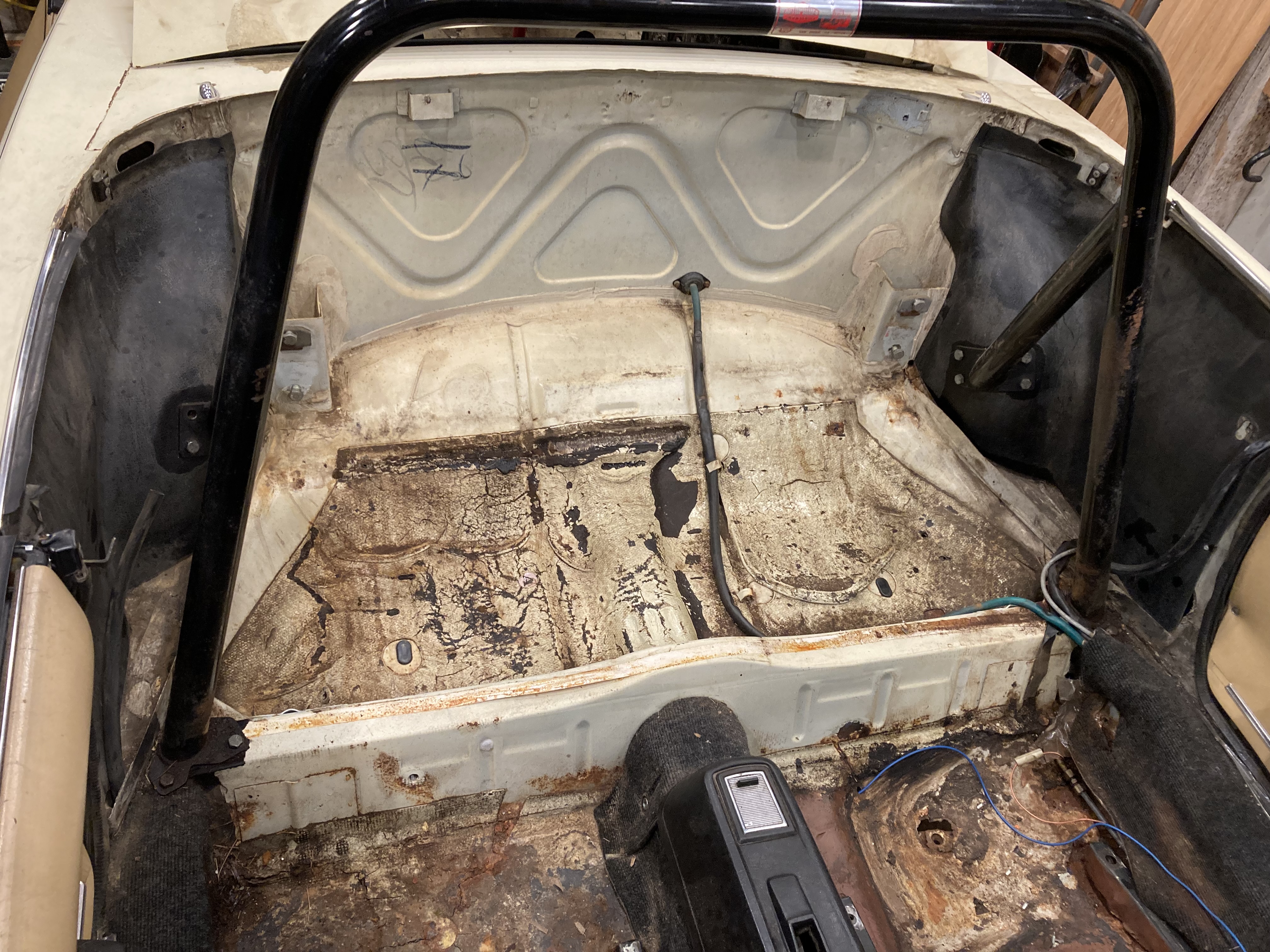

Got the top off today and the back seat out. Doesn’t look too bad - having a bit of a time working out the roll bar bolts though.

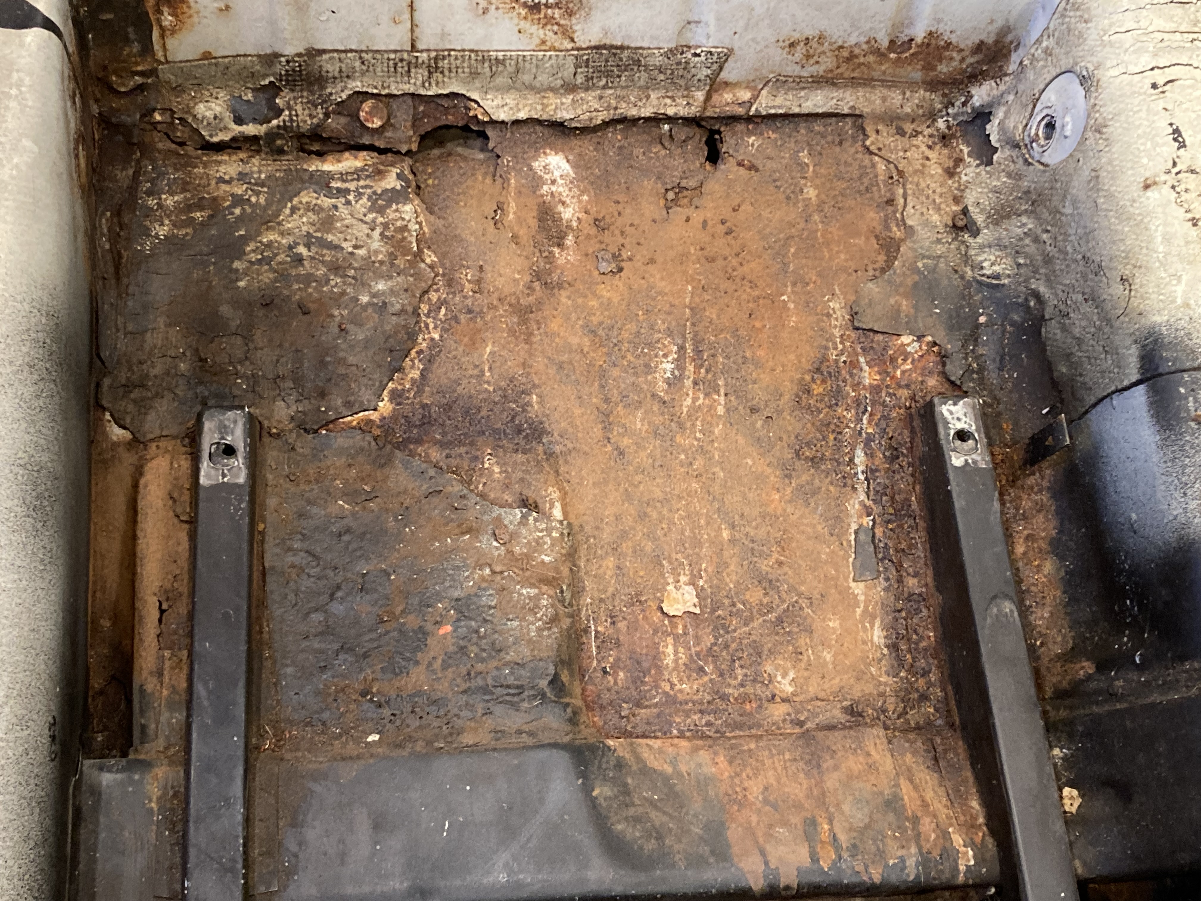

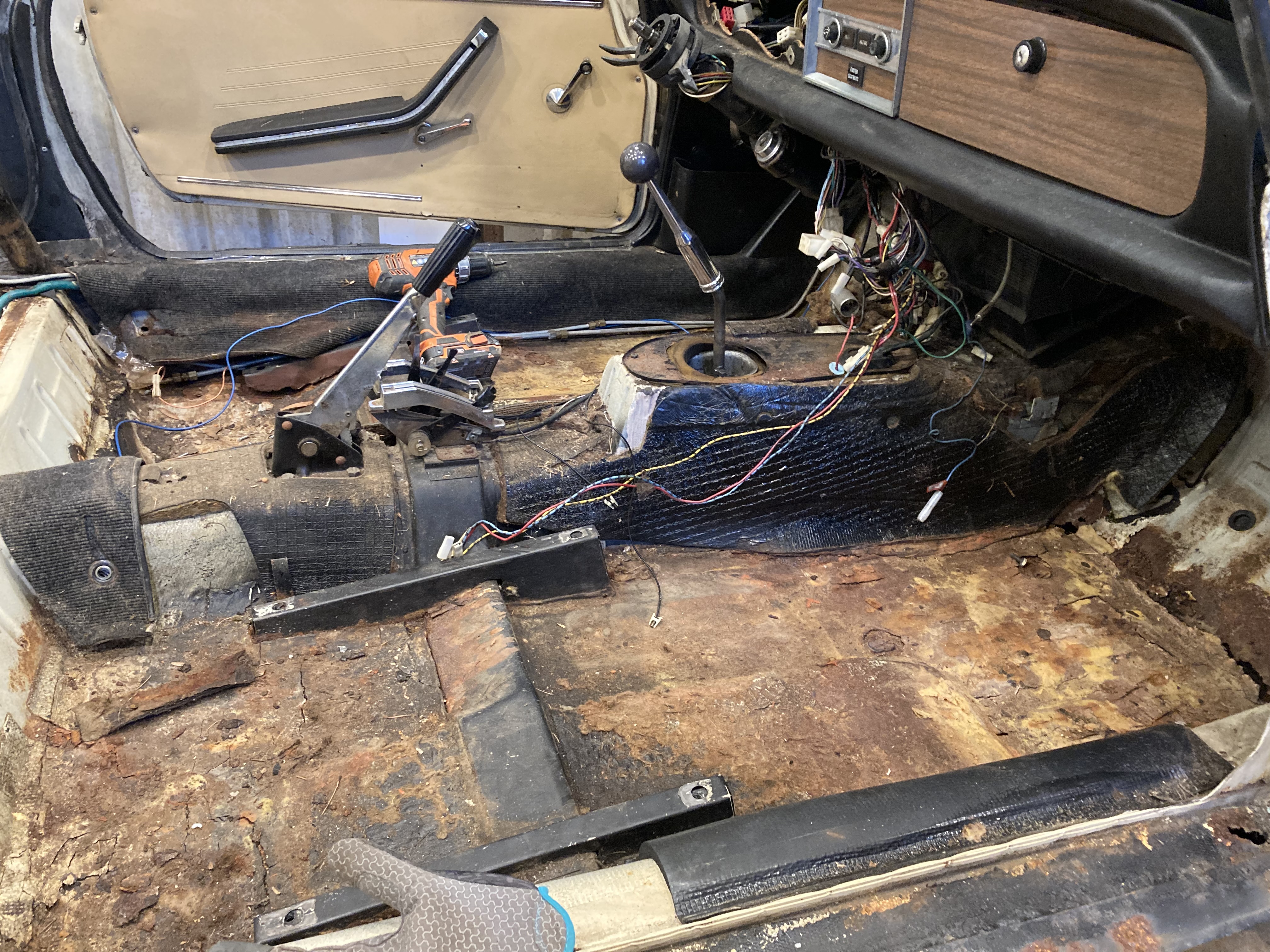

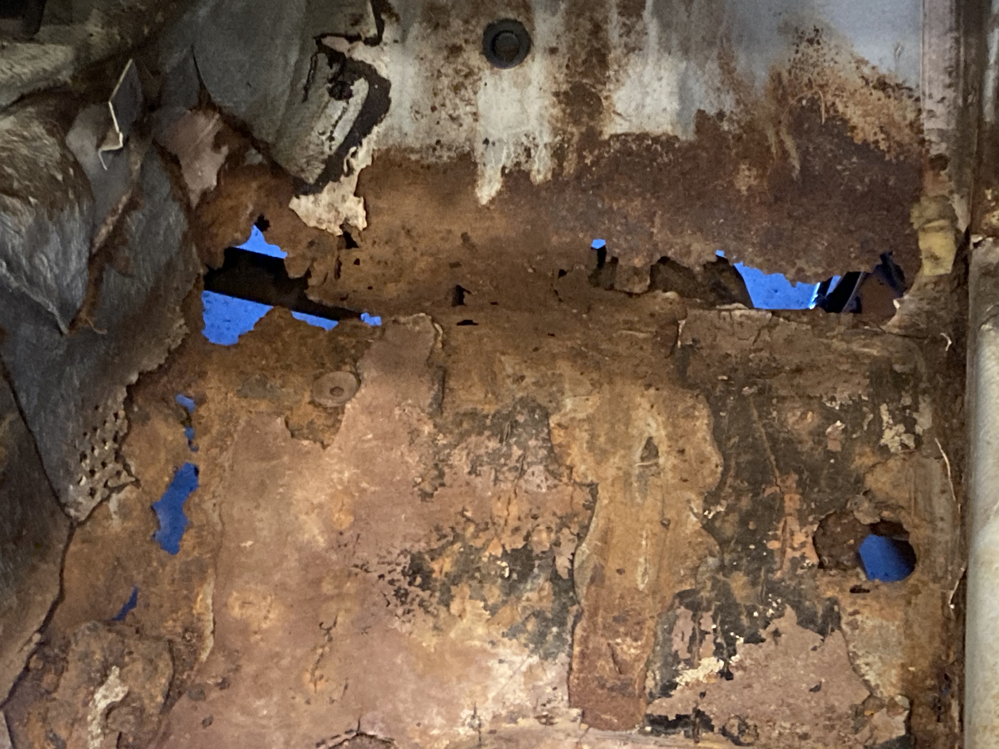

Well - I took the passenger door off and related trim, pulled carpet bits and sub padding and here’s what we’ve got. And you were right Slotman, the layer of what I guess is fiberglass. Removing that revealed holes. I guess my question now is whether the floor panels I can buy will cover everything that had to go. The rockers look good as well as the center tunnel.

I'm looking with a semi old set of eyes on my phone, but yes it looks like your ready for at least one floor pan...if dimension wise you need a bit bigger than the replacement panel then that's where making your own piece to close up the gap from an old body panel might come in handy...looks totally do-able! And it's a bonus if you don't have to mess with the rockers! Looks like you know what your doing, are on the right track and are doing a great job!
Back at it today: I’m clear that front and rear floor pans need to be replaced. I think I can salvage the seat supports (will need to do a little patching).

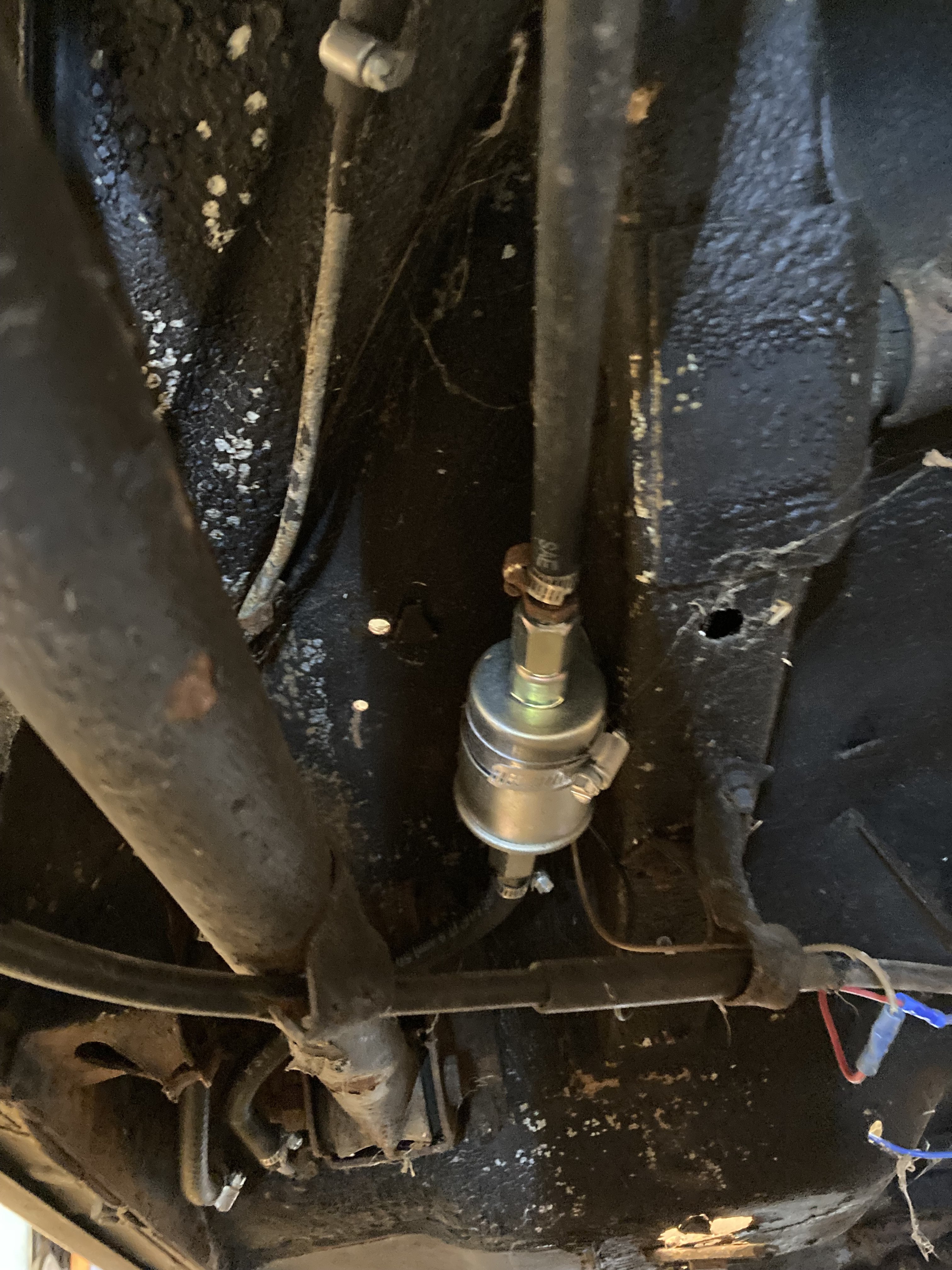

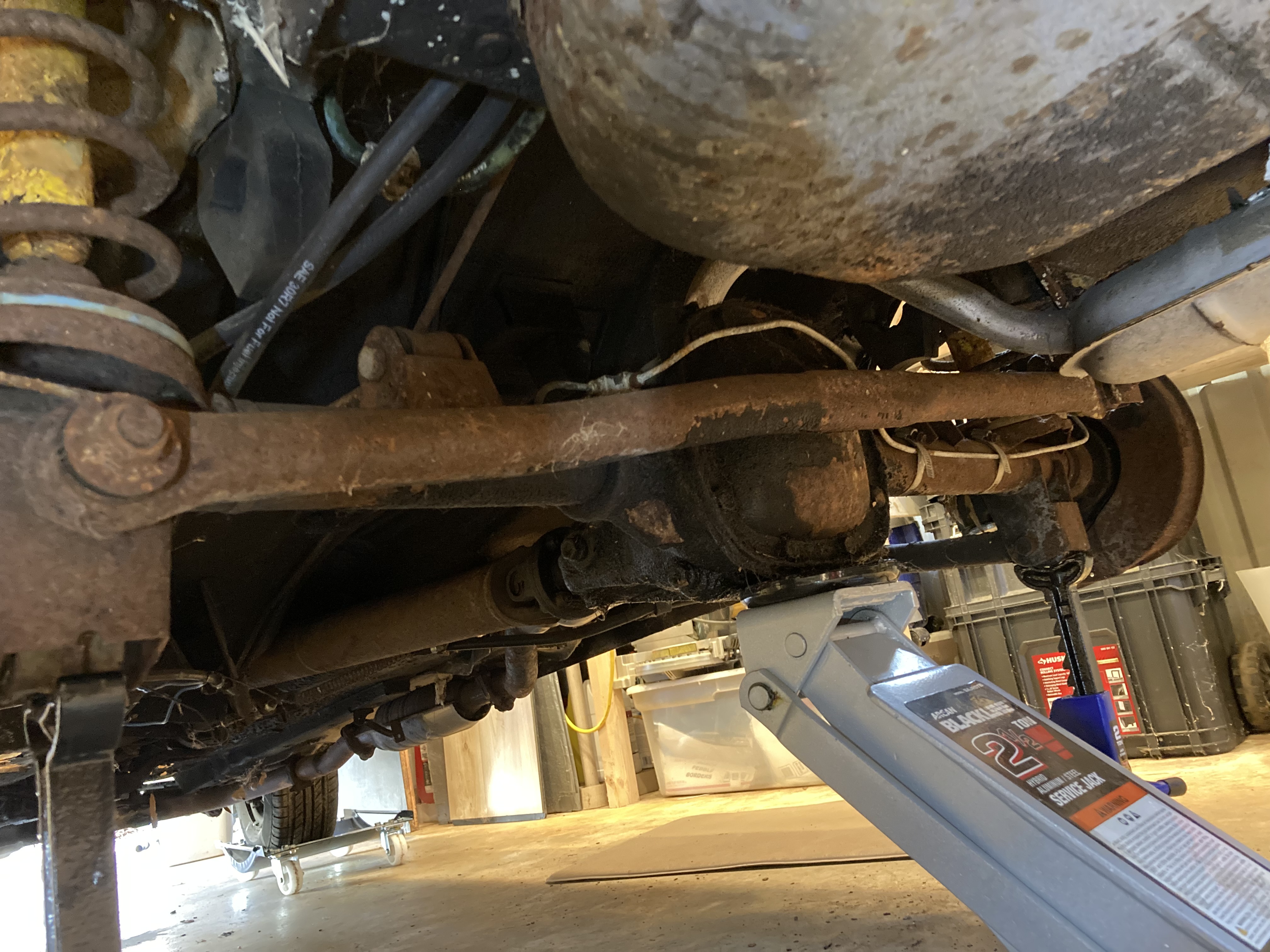

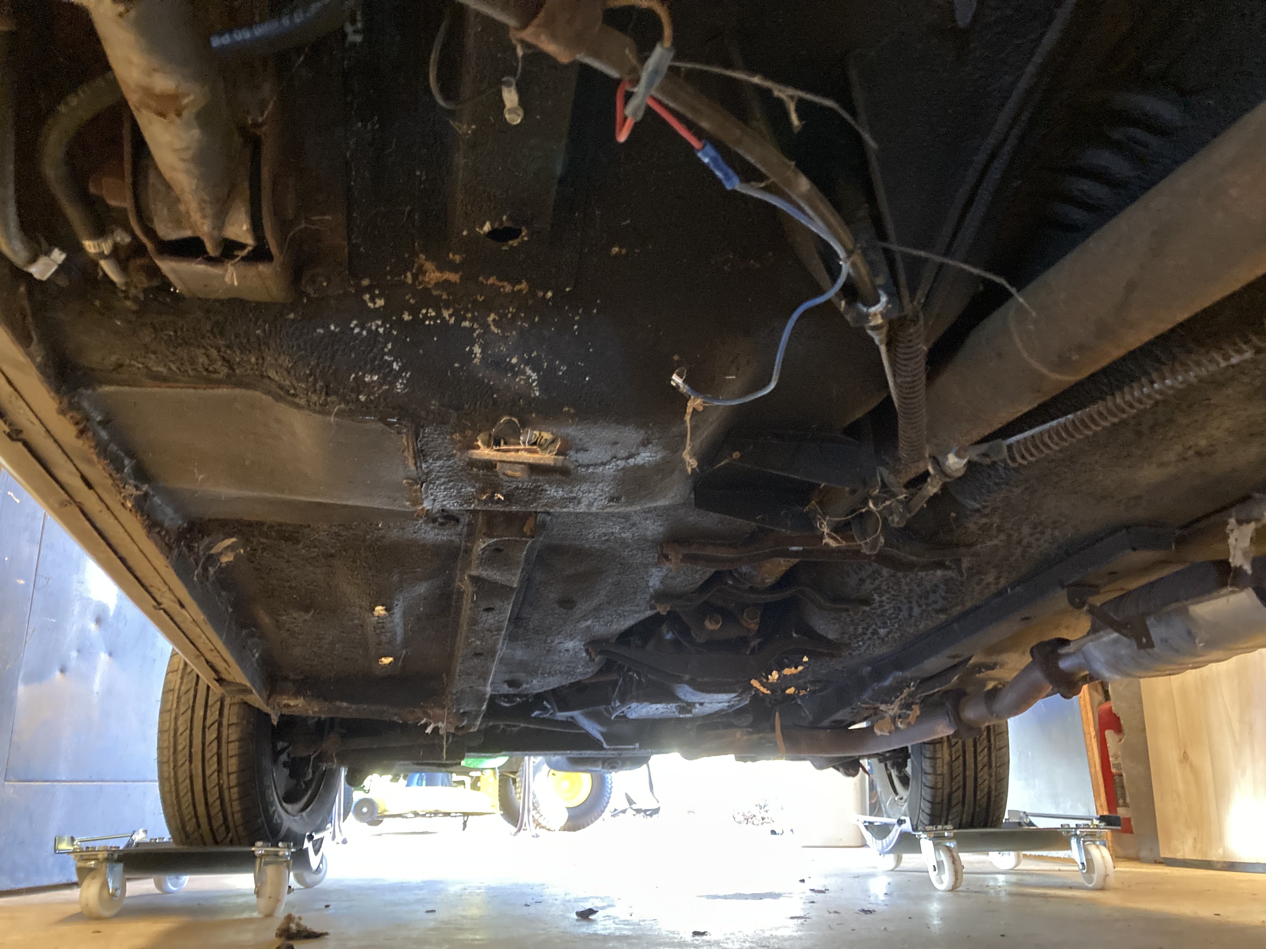

The tear-down continues; first look at the rear brakes - looks like someone put new calipers on. Also looks like an elec fuel pump retrofit?? Also am curious if you fine folk think I should replace the fuel tank. It has been sitting for a couple of years.

With your tank you may have options...I have a color endoscope you can buy cheap on the Chinese websites that delivers a color picture with a light on the end of the camera, mine has its own screen, there are more inexpensive models also that use your phone, look inside, there are tons of videos on YouTube where people load a bunch of stuff inside the tank to scrape it, then wrap it in a comforter and let it go in the dryer for a time, then you can use a kit to recoat the inside if you choose or not,
Or if it looks pretty bad inside you can do what I did with my lowrider 68 mercury wagon, wagon tanks are impossible to find so I washed my tank out with dawn, an internet suggestion that completely removed all traces of gas smell, and shipped it to a place with excellant reviews called Moyer gas tank renew or something like that, and they redo both the inside and outside of your tank with photos if you ask, then ship it back to you..I'm betting that would be cheaper than the $800 replacement on ebay...buying another used one might be a crap shoot...just a few ideas for ya...
Terry
Wanted to add, it may or may not fit in a dryer, that method works best on motorcycle tanks, but anything to shake it up and agitate it with something Inside to scrape around...I've heard not to use Chain as it can get stuck inside...check out YouTube for ideas...
