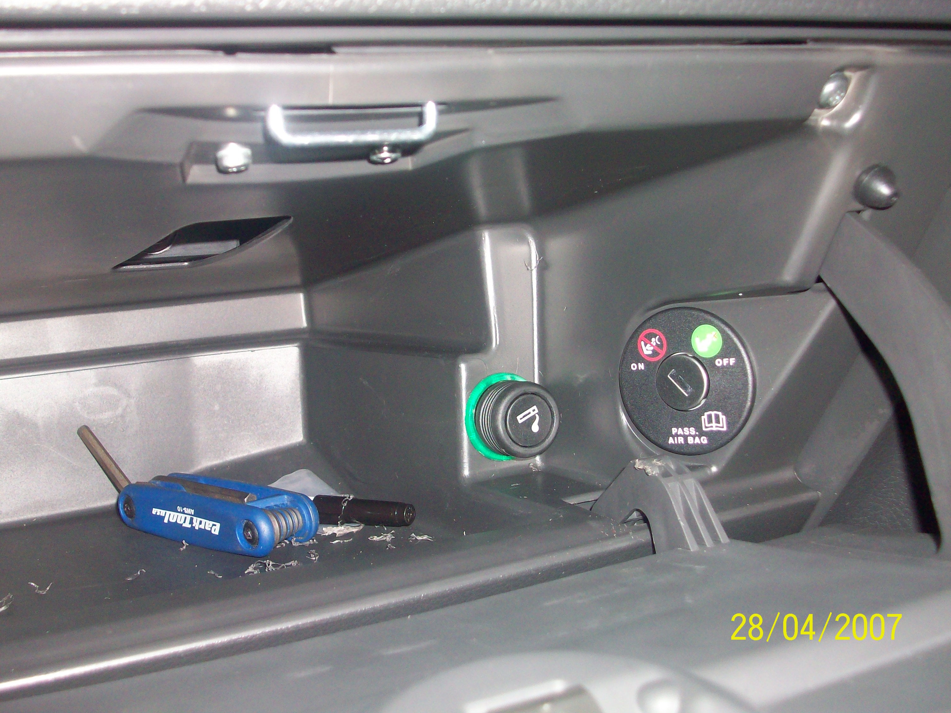

Hi all ive managed to find a different way of fitting a power point /aux socket on the active eco. Rather than going in through the wing and door there is a blanking plate in the middle of the bulk head near the top. Then just ran the wires through from the battery with a inline fuse and fitted power point in glove box . cheers Mick

Most Pandas do, but the base model leaves it out, hence needing this mod. Mine has a cigarette lighter there, not 'just' a power plug -- which I believe was an option.

One thing though (not clear in original post)... make very sure you put a rubber grommit in the bulkhead hole to pass the wires through -- that's the place they are most likely to chafe and then cause a short (and potentially, unless properly fused like Mick's, a fire too)
Looks like you done a good job, i'm trying to follow the pictures but i can't find a hole through which to pass the wires.
Can you clarify if had to drill a hole in the bulk head and if not where is the hole?

A cheaper option IME is to buy a double extension socket. I have 2 lighter sockets plus 2 USB sockets on an extension lead, cost less than a fiver off ebay. clip the plug off the end and wire as above. The socket has some double sided tape on the back but I used a 2 part epoxy to stick my socket in place. (mine's on the shelf above the window in my doblo & I tapped into a spare carrier on my fuseboard so it switches with the ignition.
nope didnt have to drill a hole the is a rubber bung on my 2009 model , i will get another pic if you cant find it cheers mick
