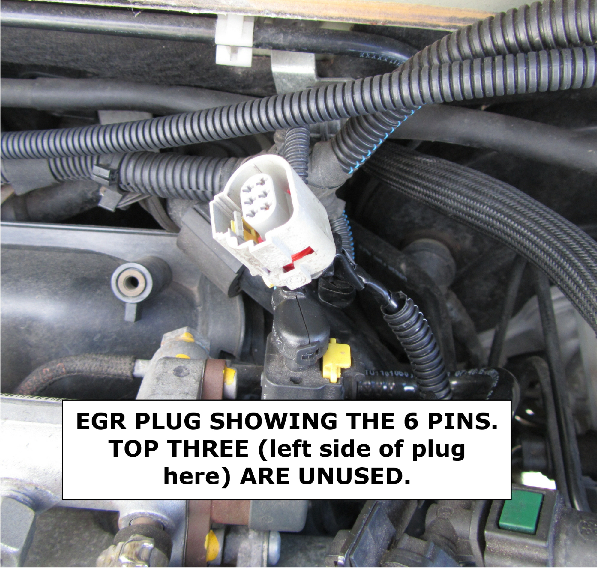

Hello to everyone,on my 2004 1.3 Multijet Panda the check engine light appeard,and on diagnostics show that the error code is P0401 (EGR),problem with the EGR. The car goes normal,like before,no smoke,nothing has changed.Any ideas how to get rid of this? Thanks!

Pretty common issue with the earlier MJ engines, but no DPF to worry about fortunately.
My EGR died.....started to run really rough at low revs.
You might get away with spraying some EGR cleaner into the intake.....although I wouldn't imagine it'd be a long term solution.
The EGR valve is a pig to get to.....so if you're going to go as far as taking it off to clean it, I'd seriously consider fitting a new one.
Or.....technically illegal (modifying emission control system), and some members on here are very anti......but you can block off the EGR valve and/or.....buy/make......an EGR simulator.
The above quoted thread shows how to do the wiring.....or on ebay there is a Polish seller who has a plug and play box that just plugs in and bypasses the EGR completely.
