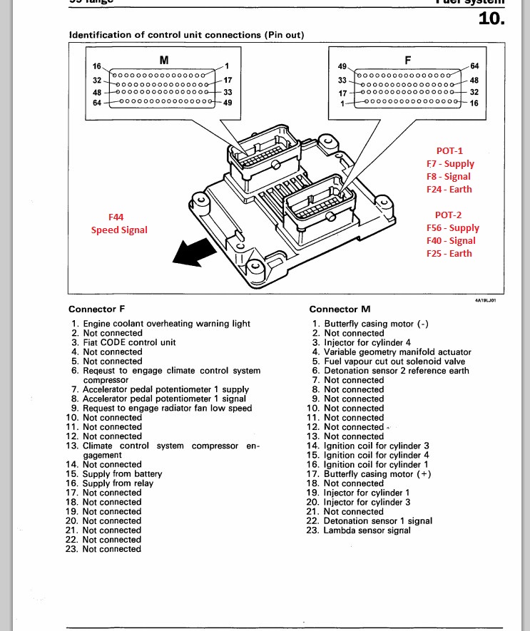

I decided to do it myself.
I am researching information about the accelerator pedal potentiometer.

The pedal unit is two potentiometers if I remember correctly. If you make pedalbox, you need dual digital pots with right values (measure yourself, Im not sure if it).
One reason I just connected servo to it, no direct electrical connection to the ecu and I can override the servo just by using my foot (more throttle or disconnect the linkage incase of unwanted acceleration).

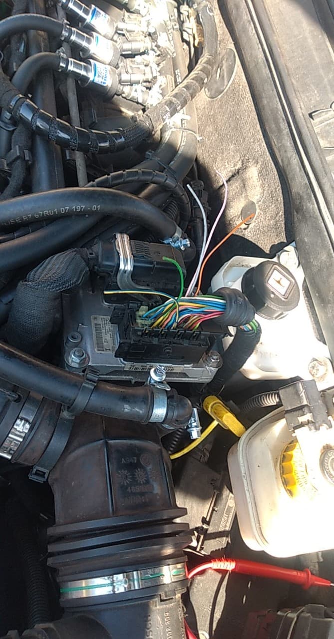

Is it direct connection pedal potentiometer with ECU?
