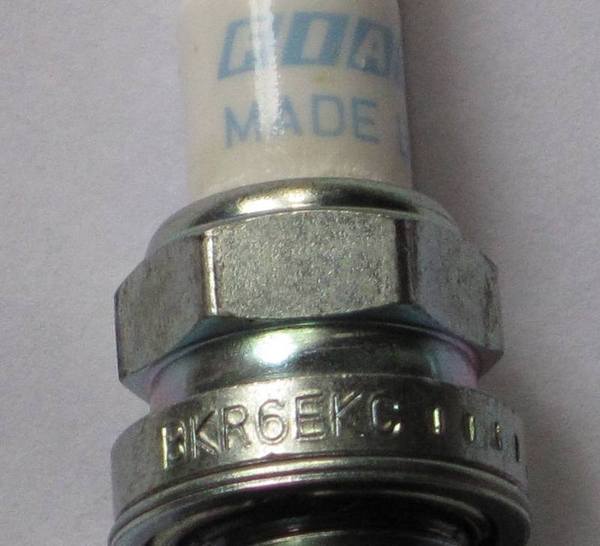

Most of the sellers suggest based on the engine code plugs with one ground electrode. One offers NGK BKR6EKC (with two ge) which was installed by the Fiat service a long time ago.

Probably the only difference between NGK BKR5EZ and BKR6EKC is that the first one has one ground electrode. It seems that the two ground electrode plugs are a little more expensive.

The numbers 5 and 6 in NGK spark plugs are for different heat codes. The R is just for resistor type plug, I used to have all the NGK books but now retired and most of my vehicles are diesel, so I haven't kept up.:)
After working for a Mazda Dealership for several years and finding them reliable I would only use NGK spark plugs after trying many other brands.
I totally agree with Mike ngk plugs are excellent. Just get the recommended ngk plugs .
Yes, I know there are hot and cold plugs, and probably some in between. So this means that the Fiat service installed a little colder plugs than recommended. That took place in the 40,000 km maintenance.

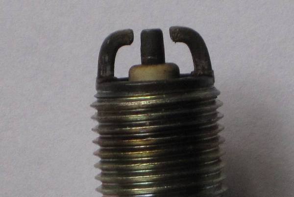

I still have the plugs, and one of them still looks quite nice after 41,700 km.
Naturally there are signs of worn.
I may be wrong , but to me it looks like slight burning at the electrodes indicating the need for a cooler running plug.
Any one else's thoughts?
Hard to tell from the photo.
Goodness knows if the fiat garage followed correct procedure with plugs . Check eper for fiat part number then cross ref to ngk?
Just fit the ngk recommended plugs and look again after 10,000 miles.

I have no hard information on that. my thoughts are no the heat rating is most likely the same unless the thermostat opening temperature is significantly different. Heat rating mostly about the rate at which heat moves through the porcelain at the tip through the plug body into the cylinder head.
