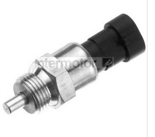

It is odd, the switches appear quite different in length and design, so I suspect the gearbox it's self has been revised.

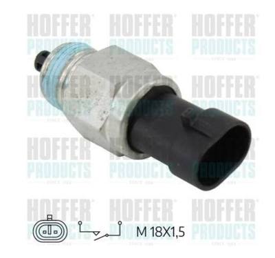

It could also be this M18 one. There are several spare part manufacturers each having their own idea of what a part should look like. Who knows who manufactured the original one.
