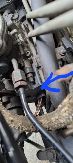

Hi again folks, I've started to attempt the immobiliser by-pass but am reluctant to do any uneccessary damage in the process. Could you confirm please that the black plastic box shown in the attached photo is the bit that I should break off? I've already removed a plastic cover from the end of this. Also have you any advice on how to remove the anti-tamper screws once I get to them?

Hi Jon, Could you confirm please that the black plastic box shown in the attached photo is the bit that I should break off? I've already removed a plastic cover from the end of this. Is a Dremel the best way to get rid of the tamper proof screws once I get to them?
Sorry for late response only just seen this, yes that is the one, and one of them 3 wires coming out of it was a ignition live which you can use to power the solenoid once you expose it, hope this helps

Thanks for the clarification. I didn't actually go in deep enough to have to remove the tamper-proof screws. Using a Dremel with a circular cutter and pliers, I very carefully cut and broke the outer cap off the black box without damaging the wires. This revealed a circuit board which I prised loose. In the top left corner of this is the wire which leads to the fuel solenoid. This was confirmed by touching a wire from the live feed to it and hearing the solenoid click. The circuit board is obviously redundant now so I gradually nibbled most of it away until just the area around the solenoid wire remained. I then soldered a new wire to the blob of solder for the solenoid wire and a permanent connection was made to the ignition-dependant live feed. Under the circuit board was mess of silicone type material so I scraped all of this out and cleaned the whole area with a small paint brush and aerosol brake cleaner. As the live feed to the solenoid would be exposed and subject to vibration, I gradually built up layers of JB Weld Quick packed into the original housing to create a solid support for the wire.
The engine fired up on the first turn of the key, putting to an end weeks of worry, so many thanks to all who contributed to this subject.
