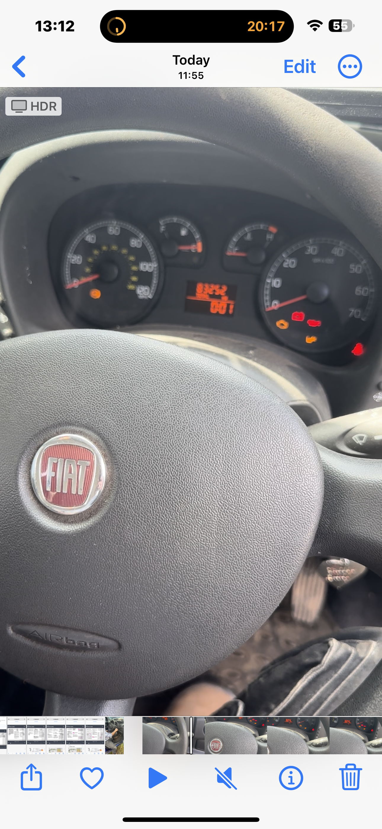

Take a pic..or 2 of the dash
Then we can all see :)

I managed to try and the ignition and the lock symbol came up and went away and then there was some sort of fan noise I haven’t heard it make before.
Anyway my picture is a screen grab from a video. Not very good but here it is…
Picture does help :)
No obvious key -lock symbol for immobiliser
But the yellow one bottom right..below red oil can.. I dont recognise that!
Is yours an auto gearbox?
