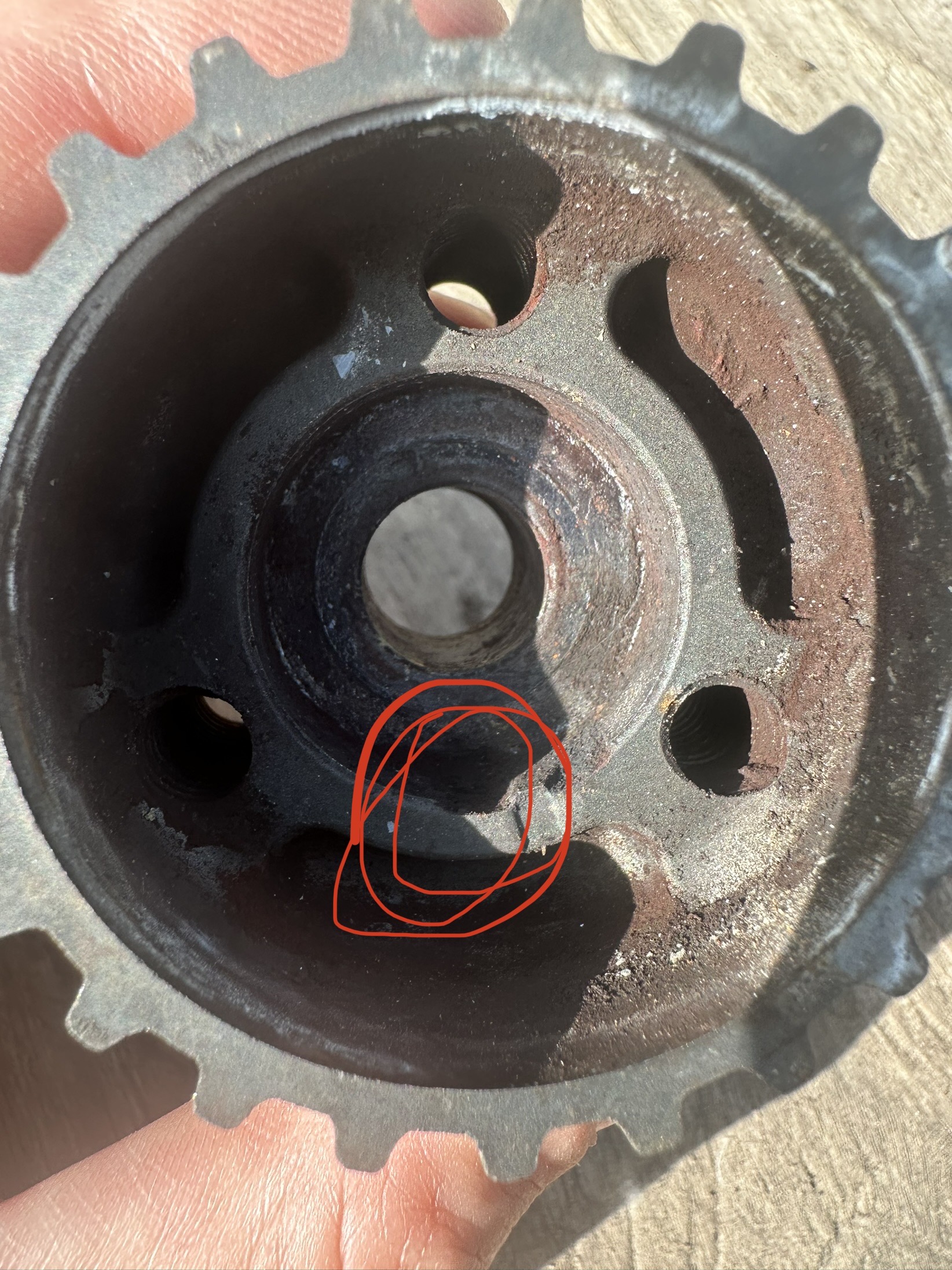

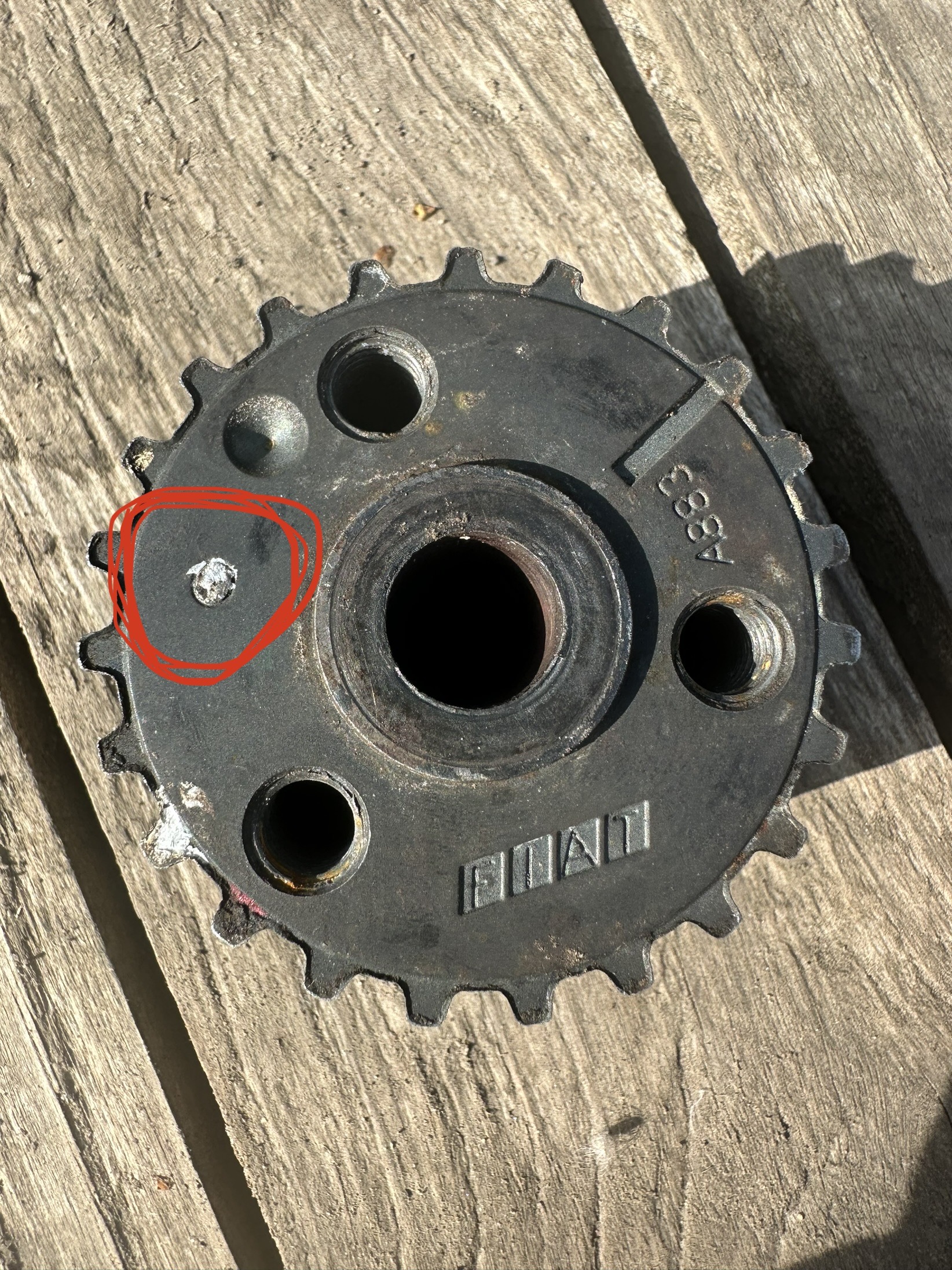

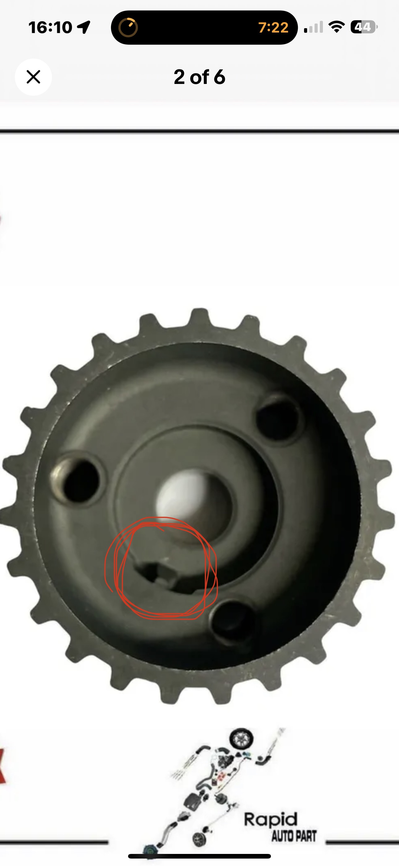

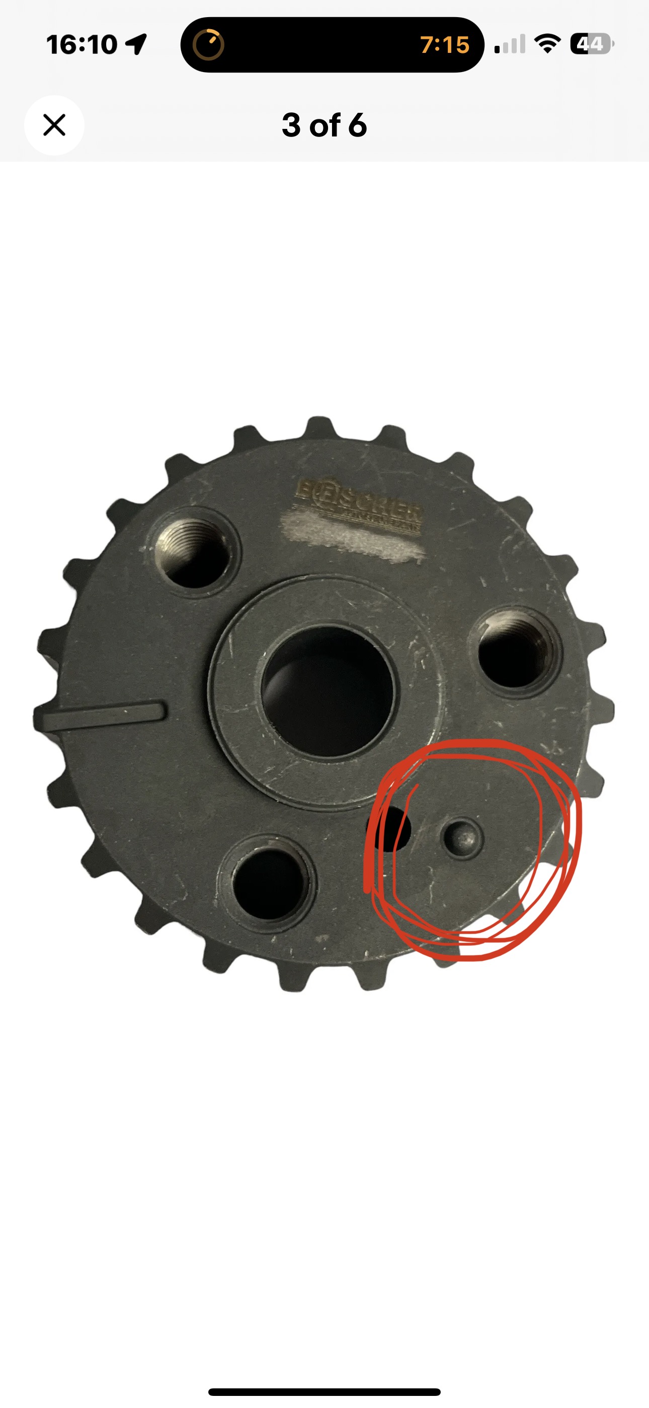

The old one has lost a knotch of metal in the centre and a little bubble on the other side. I have circled where they should be and then I have circled them on the picture of a new part too. Hopefully this will help a fellow doblo owner in the future! :)

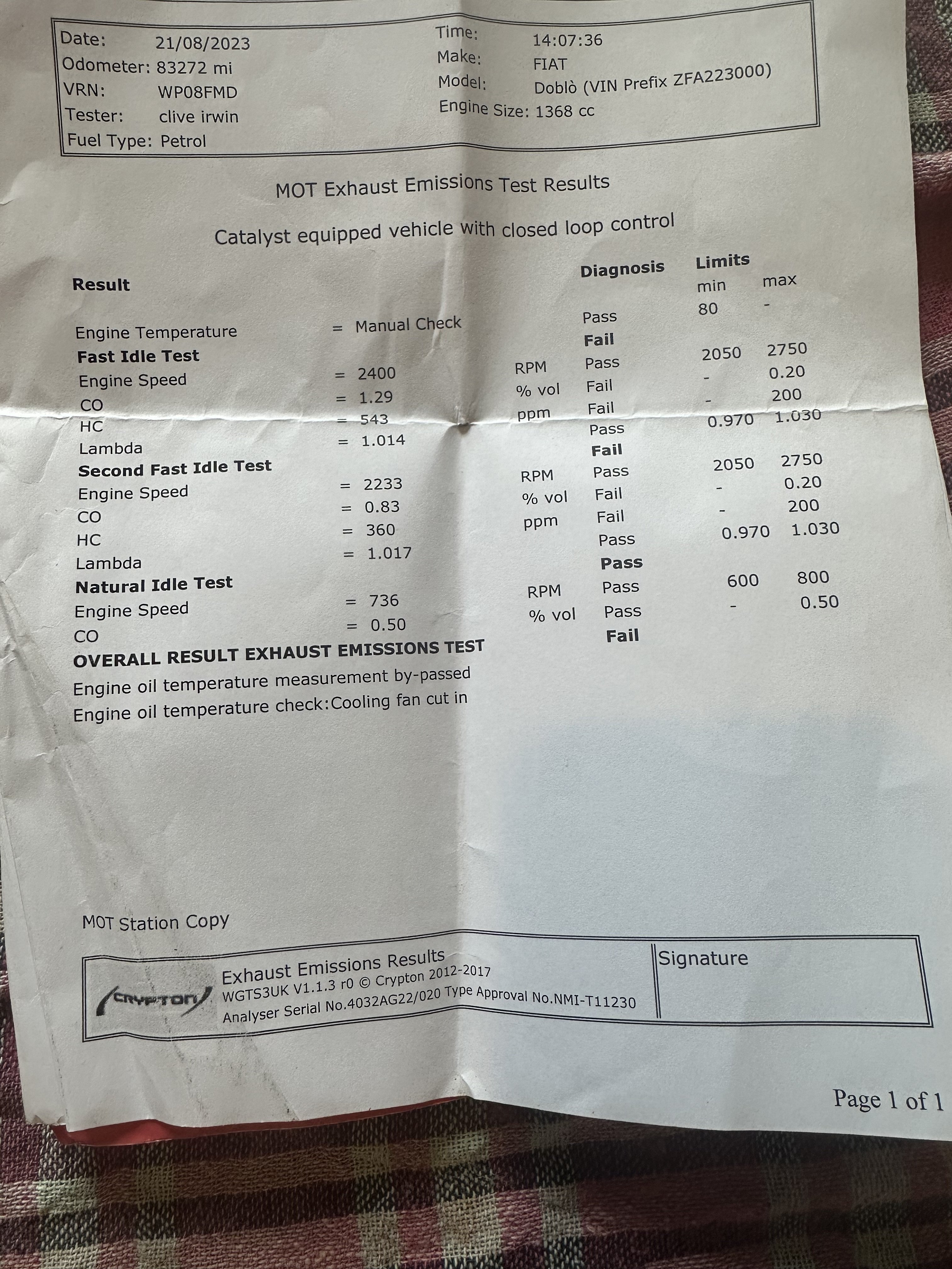

Put it in for a MOT and it failed on emissions :( they told me to give it a run about and put in some cleaner and bring it back. I used this stuff called stP ultra 5 in 1 petrol system cleaner. They think it’s because it’s been sitting but I asked my boyfriends brother and he has had a similar age Fiat fail on emissions before. Said it needs to go through a full emissions test.
Any advice?
Hi,
There are a few options there...
Given the history of it's non. Starting
1.Double check timing
2. Check for loose hoses.. Etc drawing air....., AIR FILTER CLEAN..?
3.Check the state of SparkPugs
4. Get it REALLY HOT... then drive it fairly hard
I'm not too familiar with the 1.4..
Maybe they get marginal figures anyway .. 🤷‍♀️
UPDATE! My lovely doblo has now passed its MOT! My boyfriend put a new catalytic converter on it in the end. Common problem I’ve heard.
