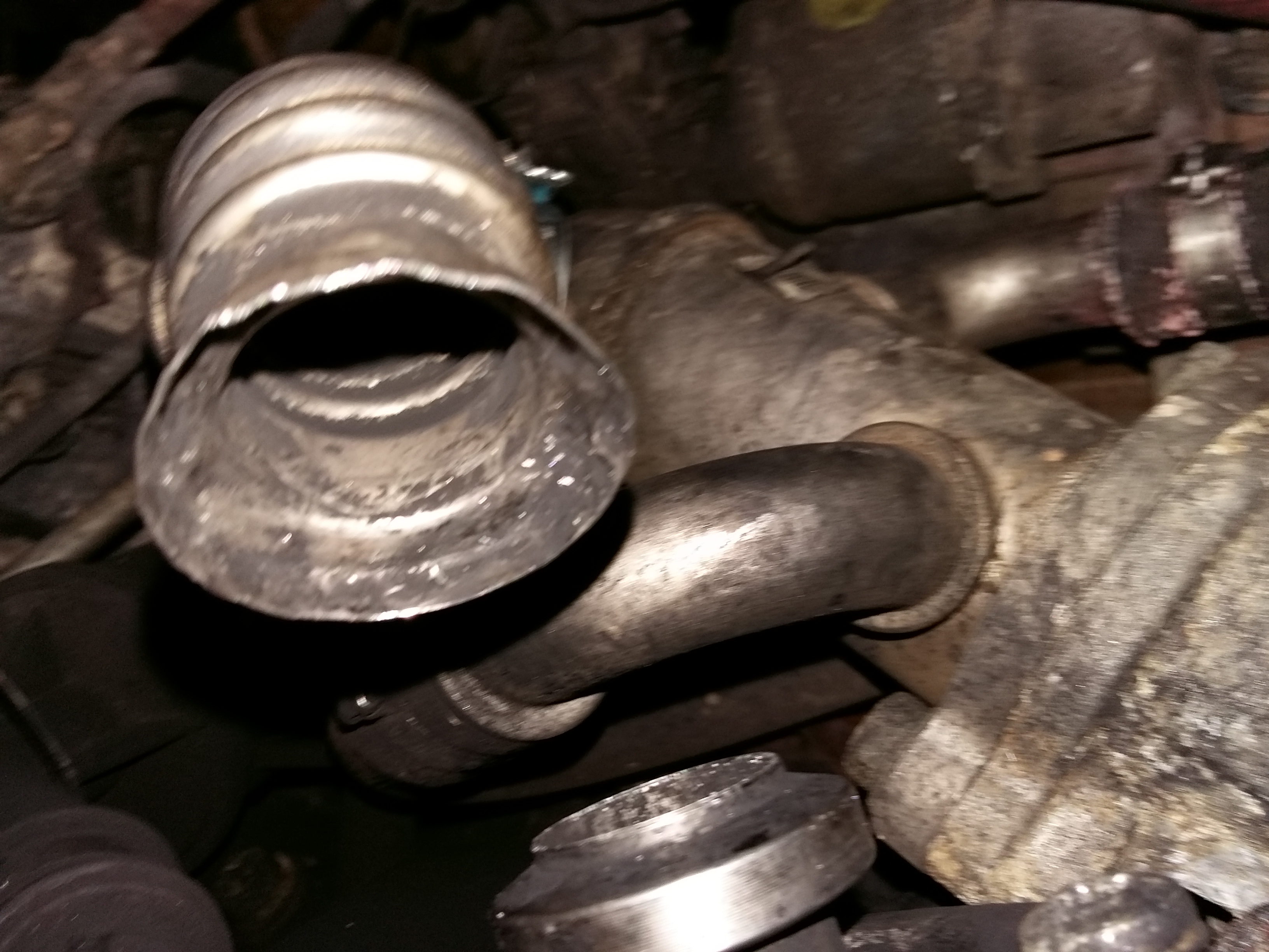

Are you sure that you mounted everything back properly after cleaning the manifold and refitting the new EGR?
Any air leaks around the manifold area could cause boost leaks...
Also what year is it? If you have the Euro 4 engine(first 1.3 mjtd ever came out) check the pipe that runs from the EGR cooler into the intake manifold. There is a clamp and a metal gasket that joins two pipes together that could have been mounted improperly because of the tight working space...
Are you sure that you mounted everything back ...
Its a nightmare to mount square..
Mine was on badly.. just leaked..so bad fumes
Here is an image:
I have to take pics to check how it mounted.. :eek:
No errors though..
2007 grande euro5 iirc
