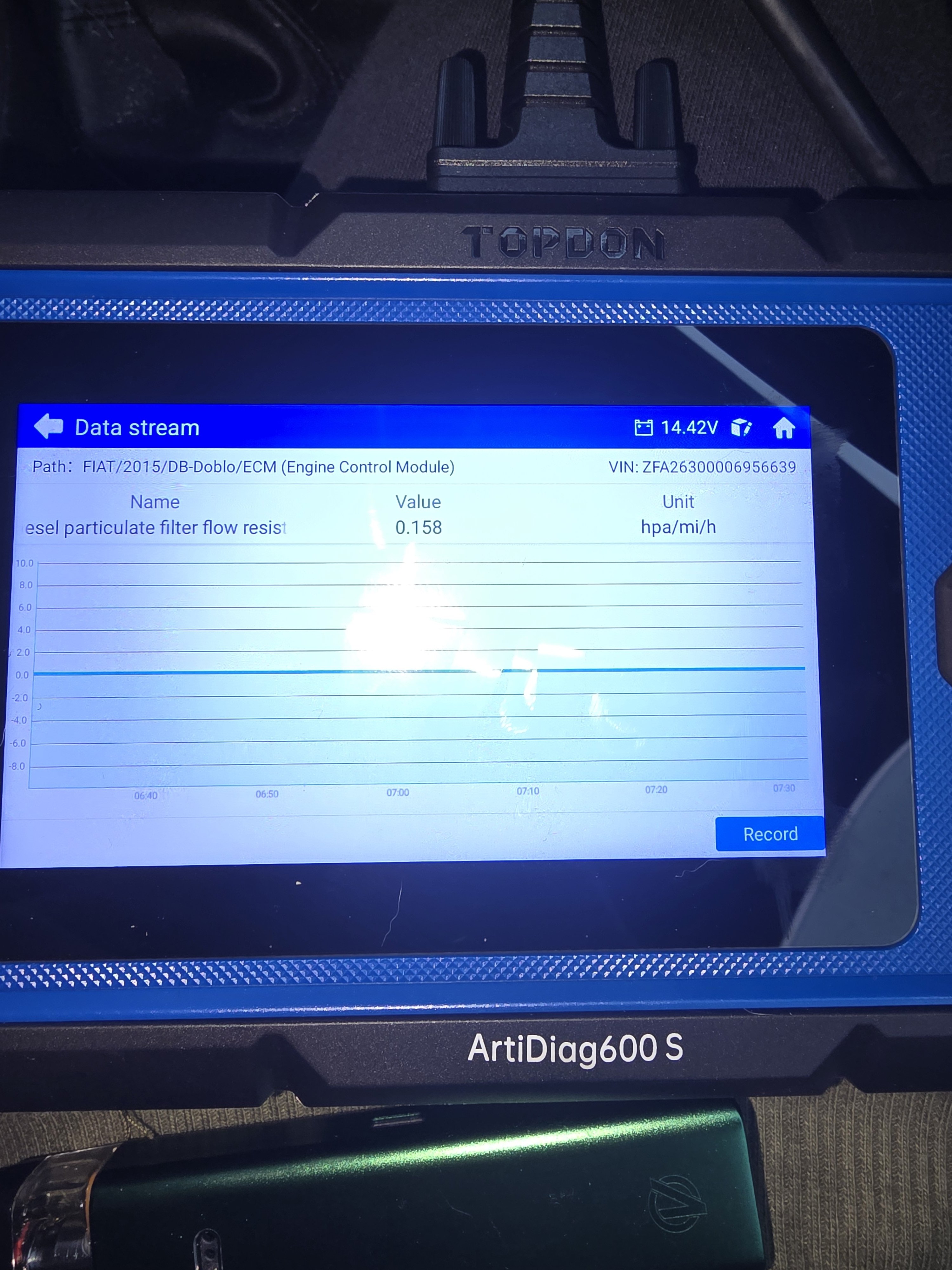

The key reading you need is differential pressure - can you please report back (pref in millibars or hpa) what the reading is at idle and at 3000 revs ?

Not sure if that's correct pressure you mean flow rate ?
