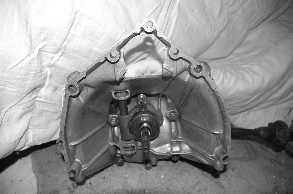

Found these two photos of the different bellhousings. The bolt pattern on the box case proper looks the same.
Is the ring gear on the flywheel the same between the two models, that is, are the starters interchangeable?
Chris

500F to 500R / 126 starter motors are not interchangeable because of the flange mountings but you can get and swop the ally castings. The 126/500R has a different little cover plate where it mounts to the bell housing plus there should be a rear support bracket on the stater motor that connects to the gearbox . Sounds like you will have the right bits to do the job and if you use the original box you will have to split the diff housing to swop the bell housing so you in a great position to fit the 500L/R drive shafts . Starter ring gear is not a problem I am running a bored out 500D crankcase , 500 flywheel , starter motor , 500 bell housing and a 126 synchro box and I know of others who have done the opposite by matching up a crash 500 box to a 126. You can mix & match (y)
I found that the 500 bellhousing won't fit the 650p engine. There is no cut-out in the 650 engine block to accept the 500's top mounted starter motor so the starter can't be installed since it fouls on the block. I'm pretty sure the bellhousings are interchangeable although one has studs whereas the other has bolts but it's simply a matter of extracting the studs and using the bolts - or vice versa?

Another mix 'n match is to obtain a 126 BIS (the watercooled version) gearbox, put 25mm 500 drive-shafts into it and an AIR-cooled 126 bell housing (or 500 bell housing if you are using a 500 engine, it also fits onto the front of the 126 gearbox) This way, you end up with a slightly higher final-drive ratio--which a tuned engine will pull and makes for more relaxed cruising. This is the way that I am going with my 695 engine, which will be based on a 126 '650'.(y)
This is where the starter motor clashes - so you can't use a 500 bellhousing on a 650 engine (or a 650 bellhousing on a 500 engine). The gearbox will fit either bellhousing.

Thanks for the photos. I will post some photos tonight..... i just received the engine and parts yesterday.
