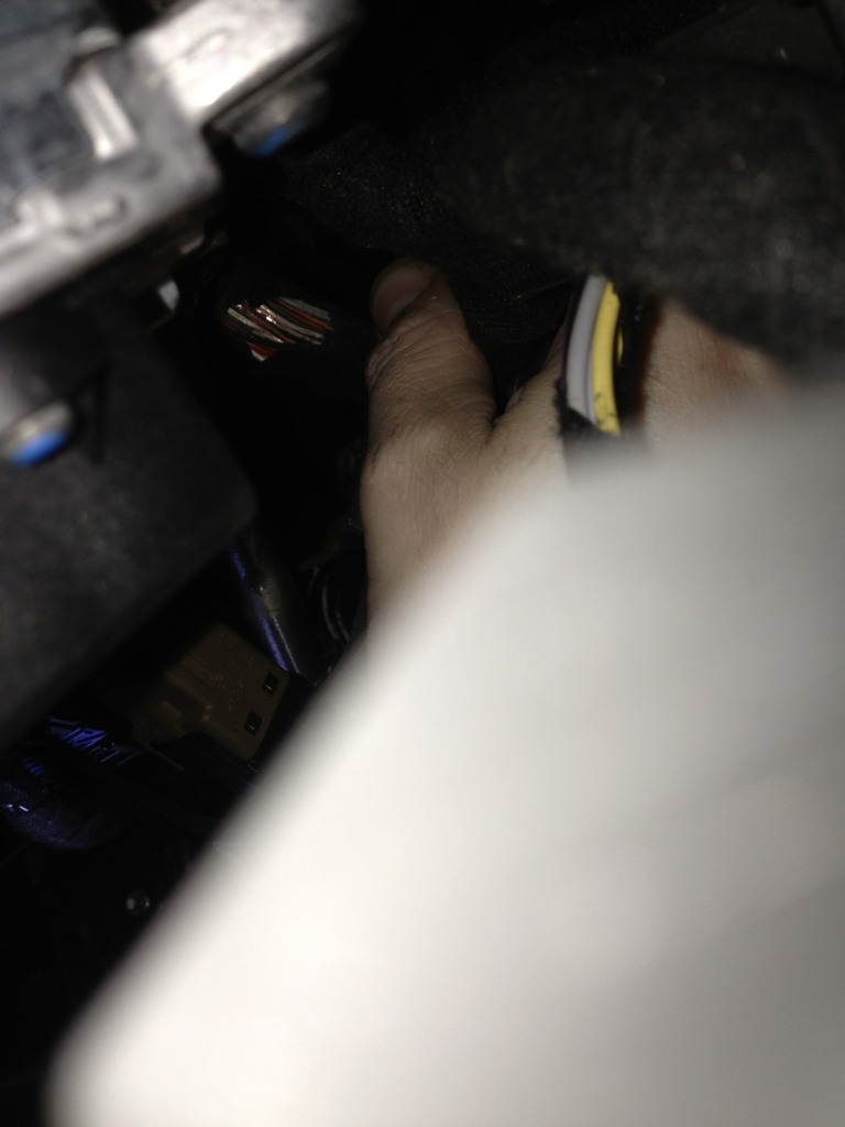

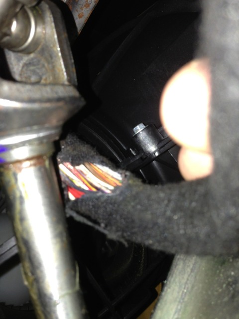

I ****ing found it!! Wiring loom behind the steering wheel
Was resting on the universal joint of the steering column. This had worn through the insulation and was shorting as the Joint turned. See below!! ImageUploadedByFIAT Forum1369592875.939604.jpgImageUploadedByFIAT Forum1369592904.699145.jpg
And tested and working. I cannot see if anyone has ever messed around behind here before so it would be interesting to know where this section of loom should be positioned.
I'm so relieved. Clockspring was most obvious cause so I've no regrets there so long as it works. Plus I've got a perfectly working clockspring to sell. Lol
