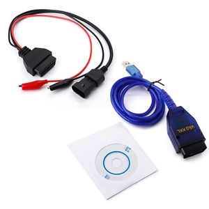

UPDATE:- You mention "You should buy a ELM 327 interface lead with ADAPTOR 3 (sometimes called a "yellow" adaptor)."
Having difficulty finding this, can you give me a URL where I can purchase or see this item

Forget about my ramble about where can I get the Adaptor 3 gizmo
Can I just get a diagnostic elm327 with a USB interface that will work
ie
http://www.ebay.co.uk/itm/381340272225?_trksid=p2055119.m1438.l2649&ssPageName=STRK%3AMEBIDX%3AIT
No, that one will not work, its for older model Fiats.
For adaptor only see ebay item 271547983086 or 161755545049
For an adaptor and interface see ebay item 281712496622 This interface has had the resistor removed so will work OK.
I've no connection with either seller.
Robert G8RPI.
