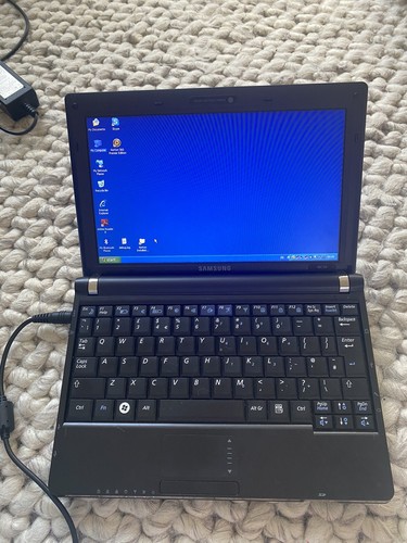

Go on eBay and look for a Samsung NC10 circa 2010, more than enough power to run MES, and very small screen about 9.8inch something like that. They came with a fabric cover to keep them from getting scratched and protect them a bit. very small Atom Power PC that is perfect for MES.
I think they came with 1Gb of ram so worth sticking another 1Gb in there to maximize. They can run windows 10 but are best served with windows XP, which is a security risk these days, unless you never connect it to the internet, then its perfectly safe.
@AndyRKett makes a valid observation / pointer that second hand Windows devices can be had for little money.
IMHO assuming all works then reliability would be my next concern. Old PC devices can pack up with little or no warning and if you need toyr MES/other diagnostics as the same time the PC packs up then you have a problem.
At £10/£20 a shot for second hander older kit then I may be tempted to purchase two.
