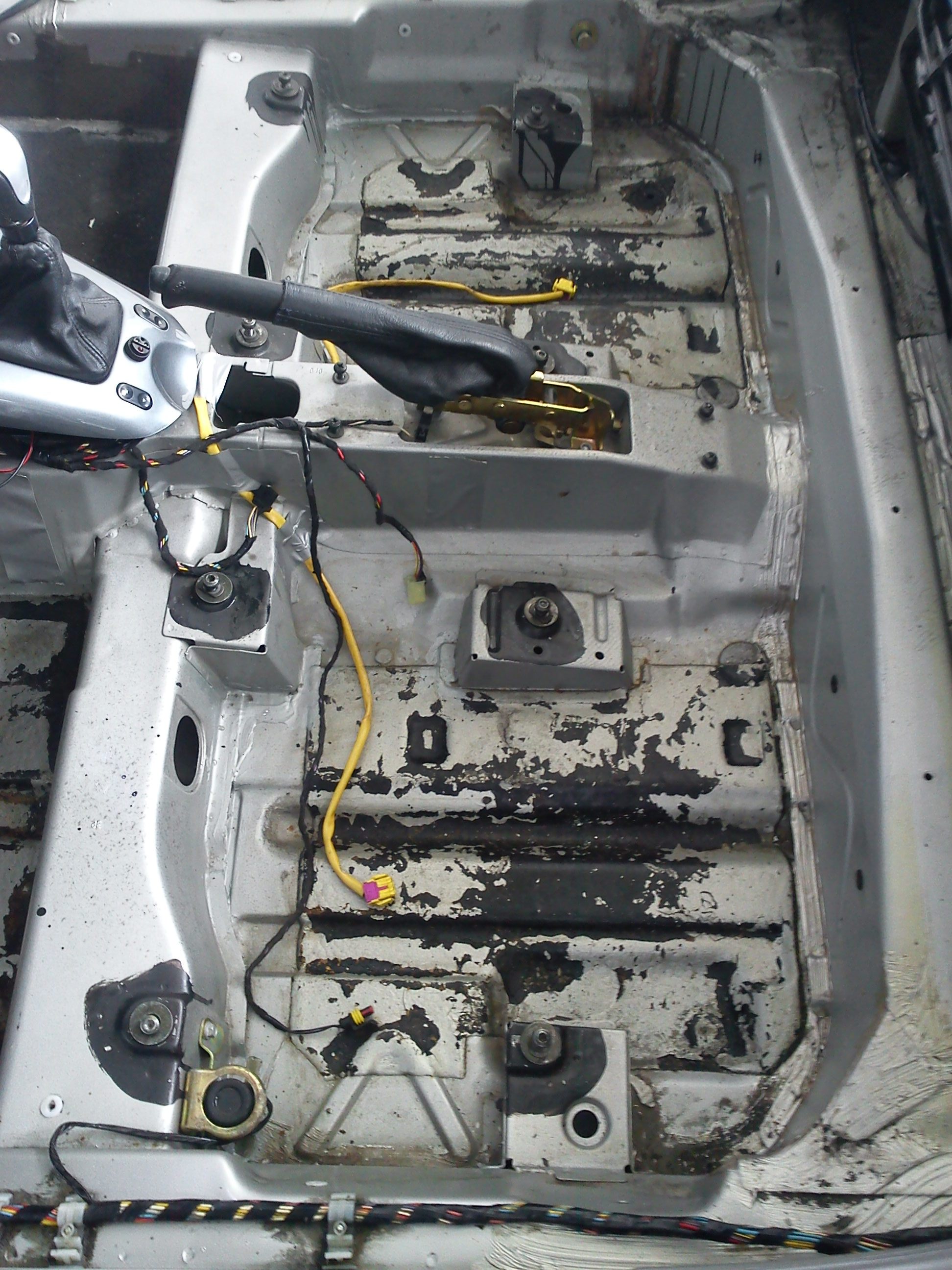

there was few gallons of water under floor-mat. in the begging it was only small HHH and look now. shouldn't somewhere be some drain holes?
Yes there are moon shaped drain holes a bit further where your finger is.
See from under the car, of feel with your nail.
You probably need to open it.
Hi Guys,
F4ust, Where is your water comming in from?

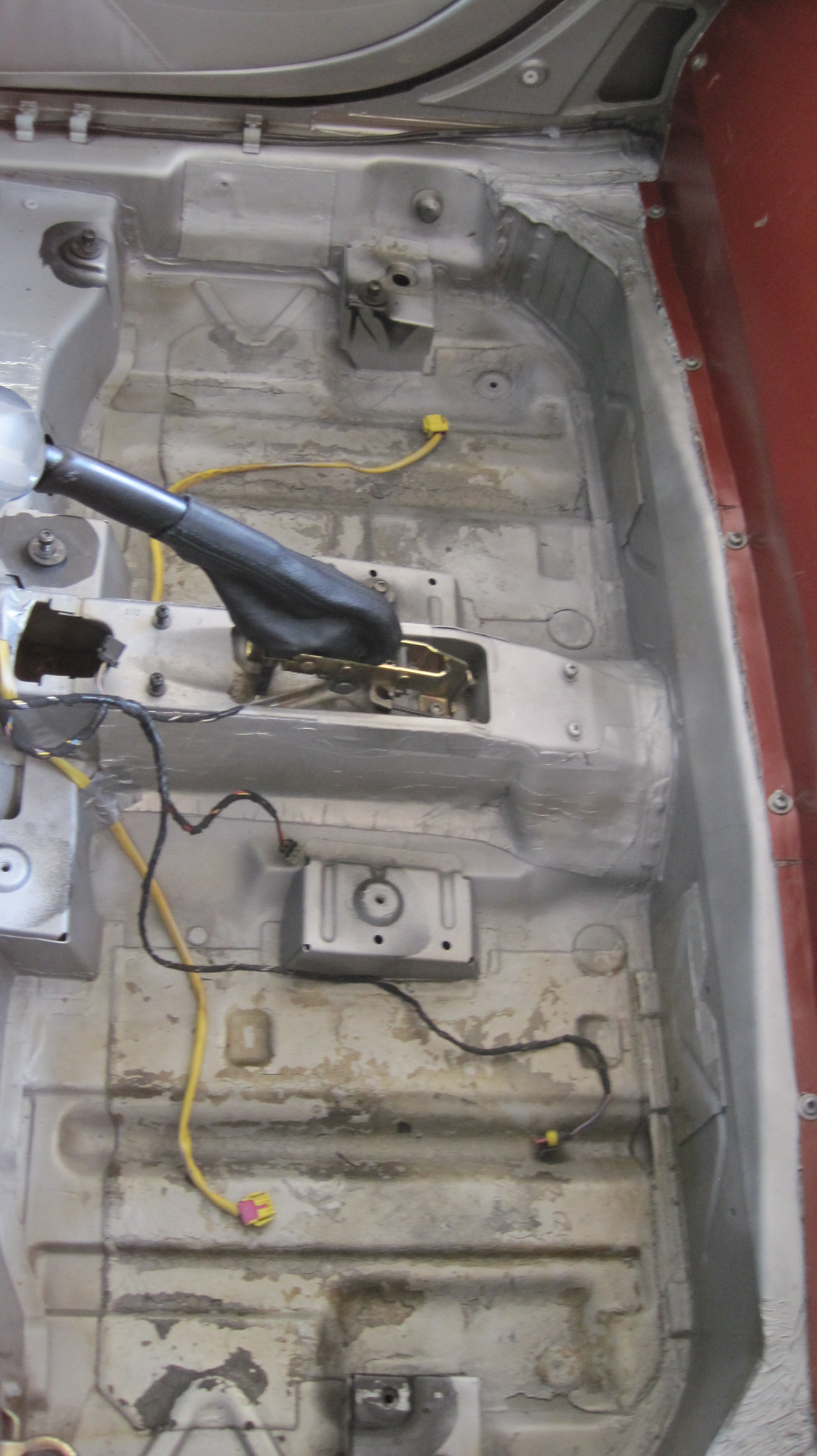

Since my floor has been up, I was lucky there is no sign of any water or rust and the floors seem to be in good shape although my car has never seen much driving in the rain.
I,m curious to find out how your water is getting in.
As a precaution I have just resealed my joins with joint sealer and also used a spray cavity wax on the floor area to seal it.
Also added a few more bits of dynamat to the floors and area behind where the fuel tank is to lessen the vibrations.
Oli, Where are these drainplug areas, are they needed as I would imagine my floor area is totally sealed now.

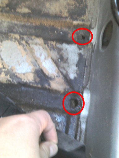

You can't see them on your pictures THey are only in the feet compartment. In the other, where the seats are there are none.
There are 2 on each side, in the lowest rail towards the mid section.
to bad i don't have picture without that protection. but here i are some holes.
not sure where goes that middle one... i will check, but that rain is really annoying. when i'm in office it's sunny, when i'm at home it's raining. why is not opposite?

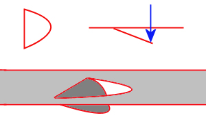

i found those "D" shaped drain holes, it was hard to see them. i open them by pushing with screwdriver. so all water now could go out.

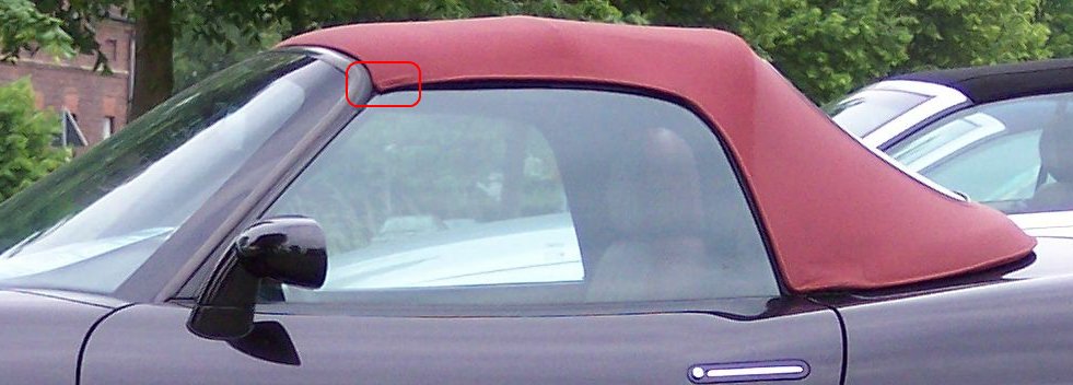

here is where is leaking both on softop and hardop. i tried with watering can yesterday to find leaking points.
Any luck with the gardening? :) I keep a cloth on the window sill to soak up drips when it rains.. I'm even wondering if water is coming in under the windscreen rubber surround at the circled top corner of your picture :confused:
