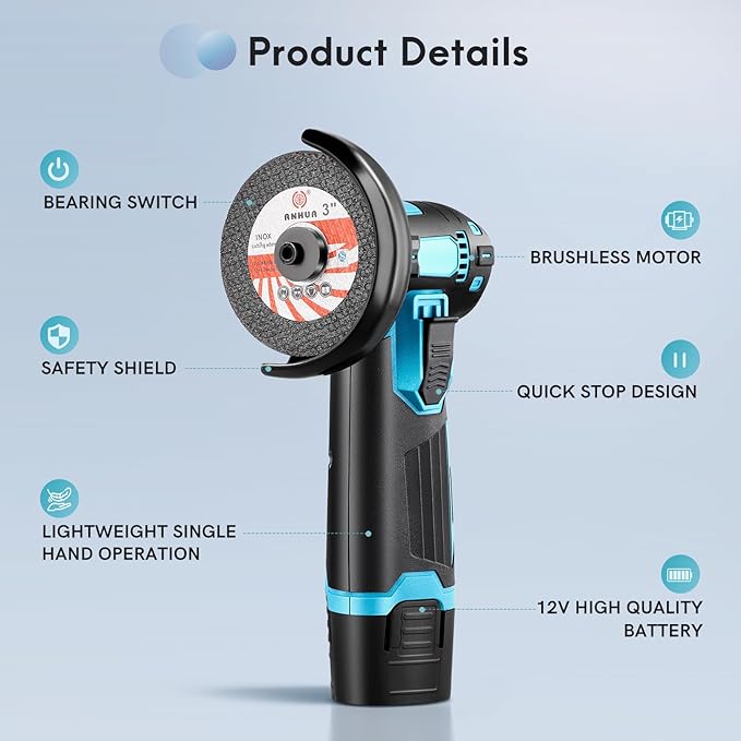

I'm currently looking at buying a 3 inch angle grinder, the one i have at the moment is 4.5 inch. One like this;

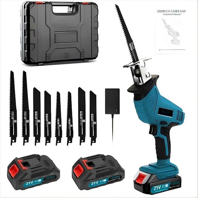

Or maybe a saw like this;
Any idea which would be best?
The reason i'm thinking about buying a tool, is that i can well imagine myself fighting with this for ages, and its kind of cold out there lol
saw unsuitable!!! You have to hold its shoe agains tge work, or the blades twist ans snap!! Good for rough cutting timbrt and cutting down fence posts to get through nails, but notfor automotive in the main. I have used mine to cut tgrough exhause pipesbut nothing smaller / fiddlier.

Its interesting you say this, because I bought a few dozen discs but when they disintegrated after a few minutes i thought they can't do any big jobs. But looking at it now i should just factor in losing loads of these and it might get a job done. I'll keep this in mind now. The worst case scenario is that i get rid of the discs, which just sit around in a drawer :)
Takes longer to keep changing disc than cutting the bolts but it will win out. Trick is hold the tool very steady, be gentle and take your time. ron at half speedif adjustable. This makes it easier. Once ¾ through cold chisel it off.
I was wondering if it was suitable, and somewhat discounted buying it after I saw the size of it. The one I was proposing to buy was an arms length long and i might have lost a limb trying to use that in a confined space lol. I'm also glad someone has said its unsuitable, i've been somewhat tempted to buy one to cut the branches down on an errant tree I have, but that's probably it for that tool.
Righto. I have been meaning to try to cold chisel, something, anything for a while but not had the right circumstance.

I have a garden pruning saw too that is very similar, but that has a set of jaws that hold any branch to be cut, so the rip saw is not ideal for garden use as it will just skip and jump on wet green wood. Aldi periodically do a hand held mini chain saw which is truly excellent for garden work, I cut down 20 trees with mine, taller than the house I am currently working on,
I'll keep an eye out at Aldi for that, and make sure I don't take an eye out while using it ;)
