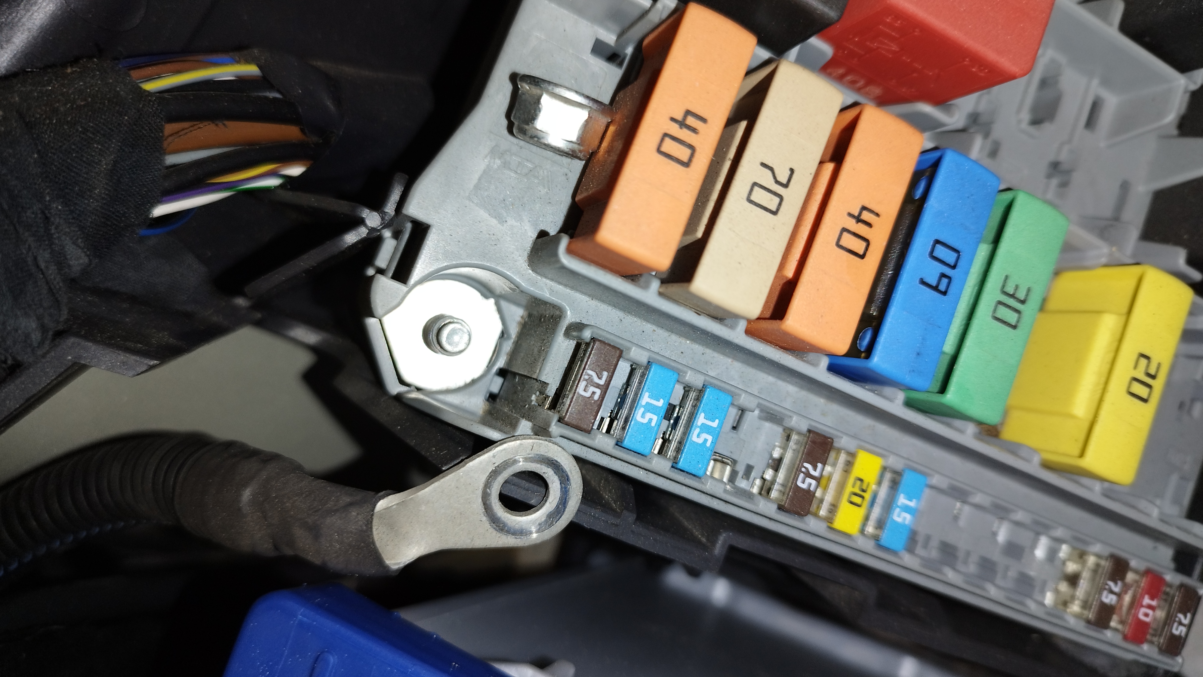

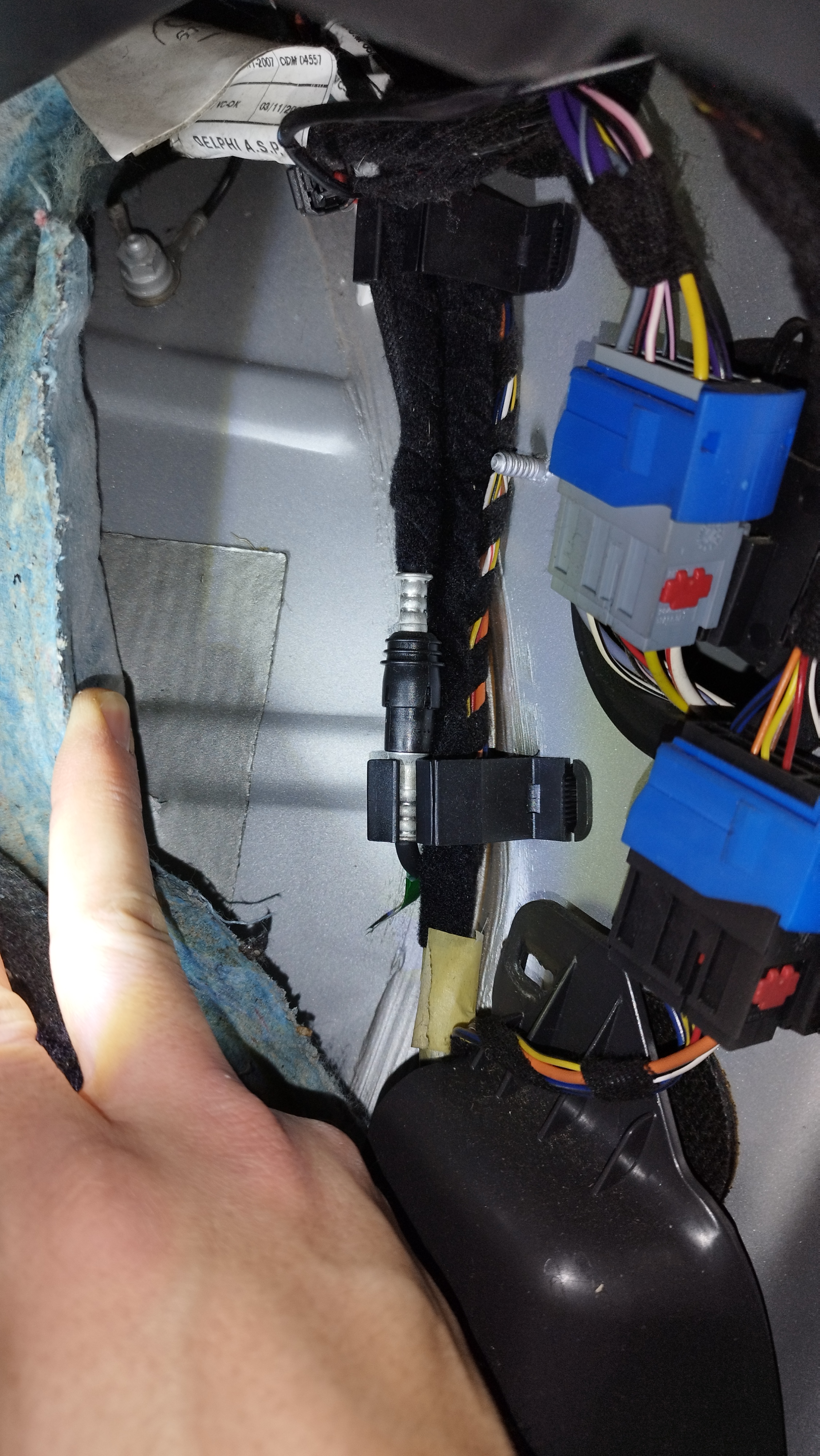

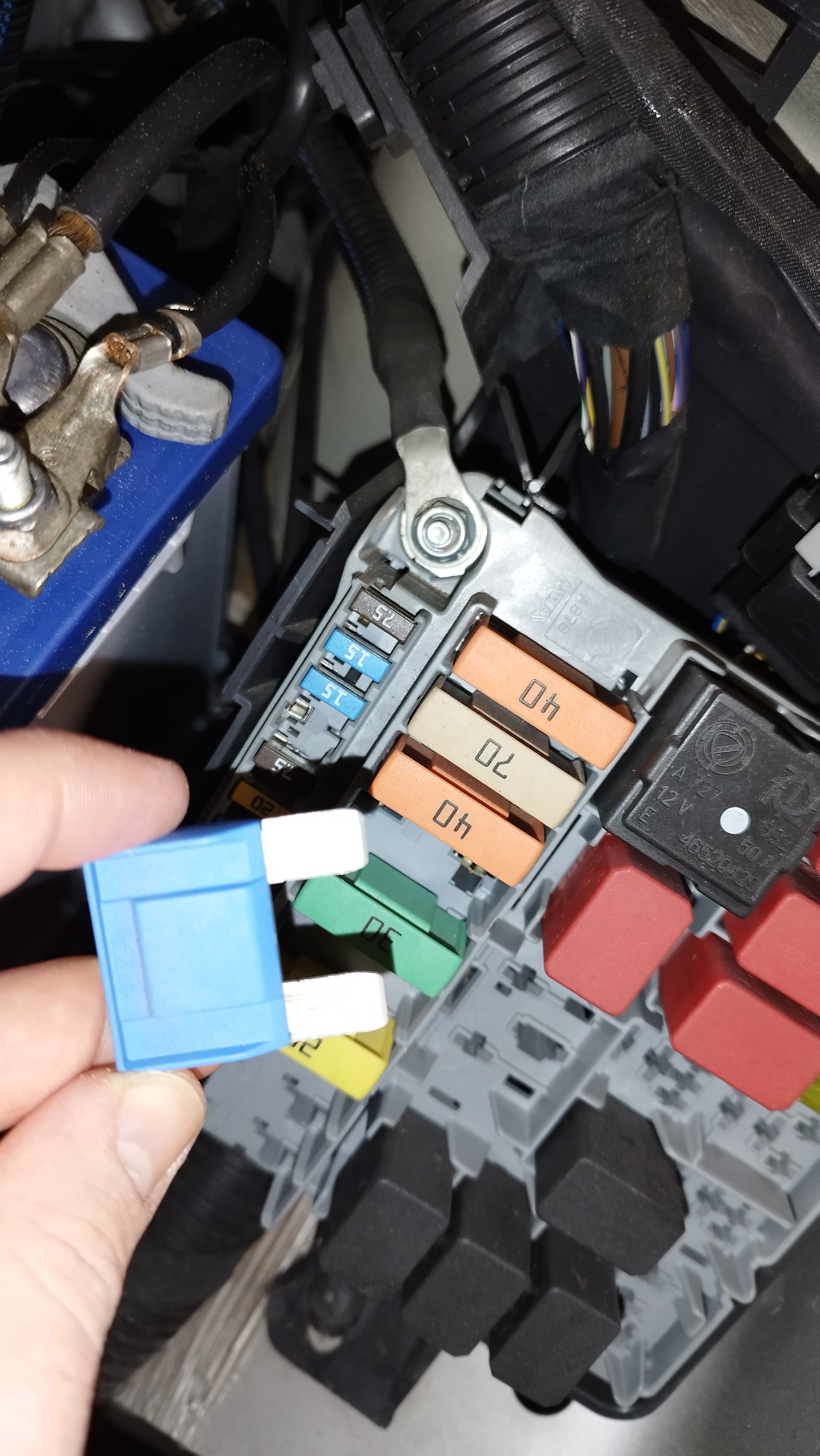

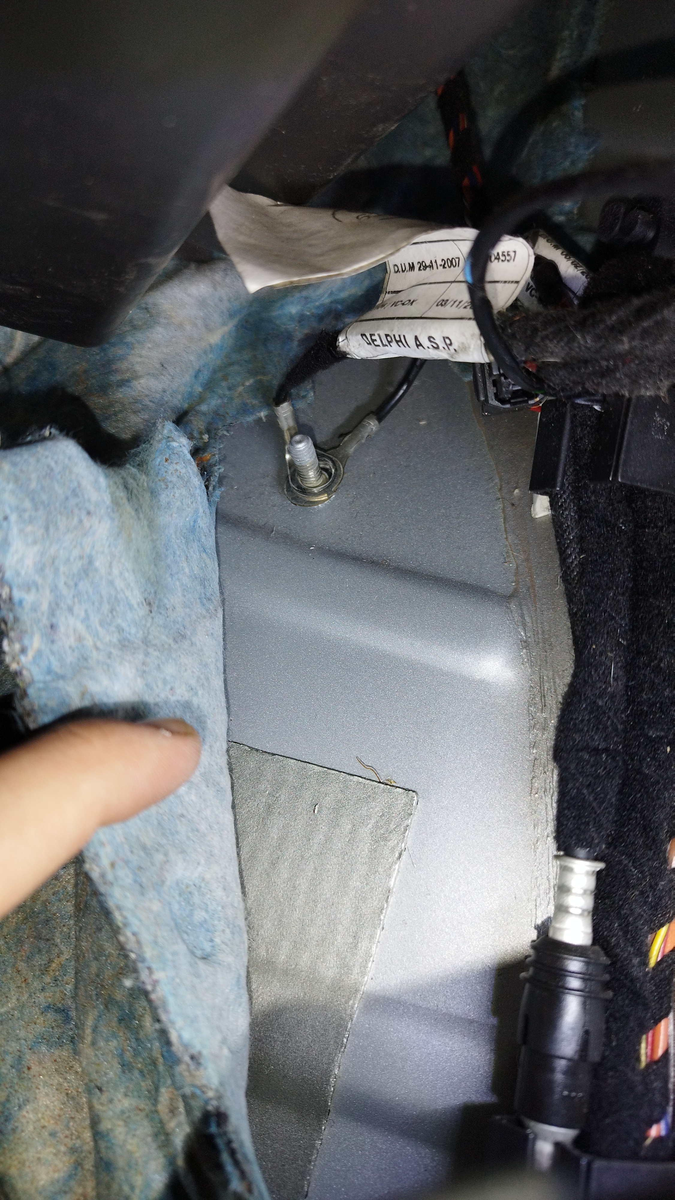

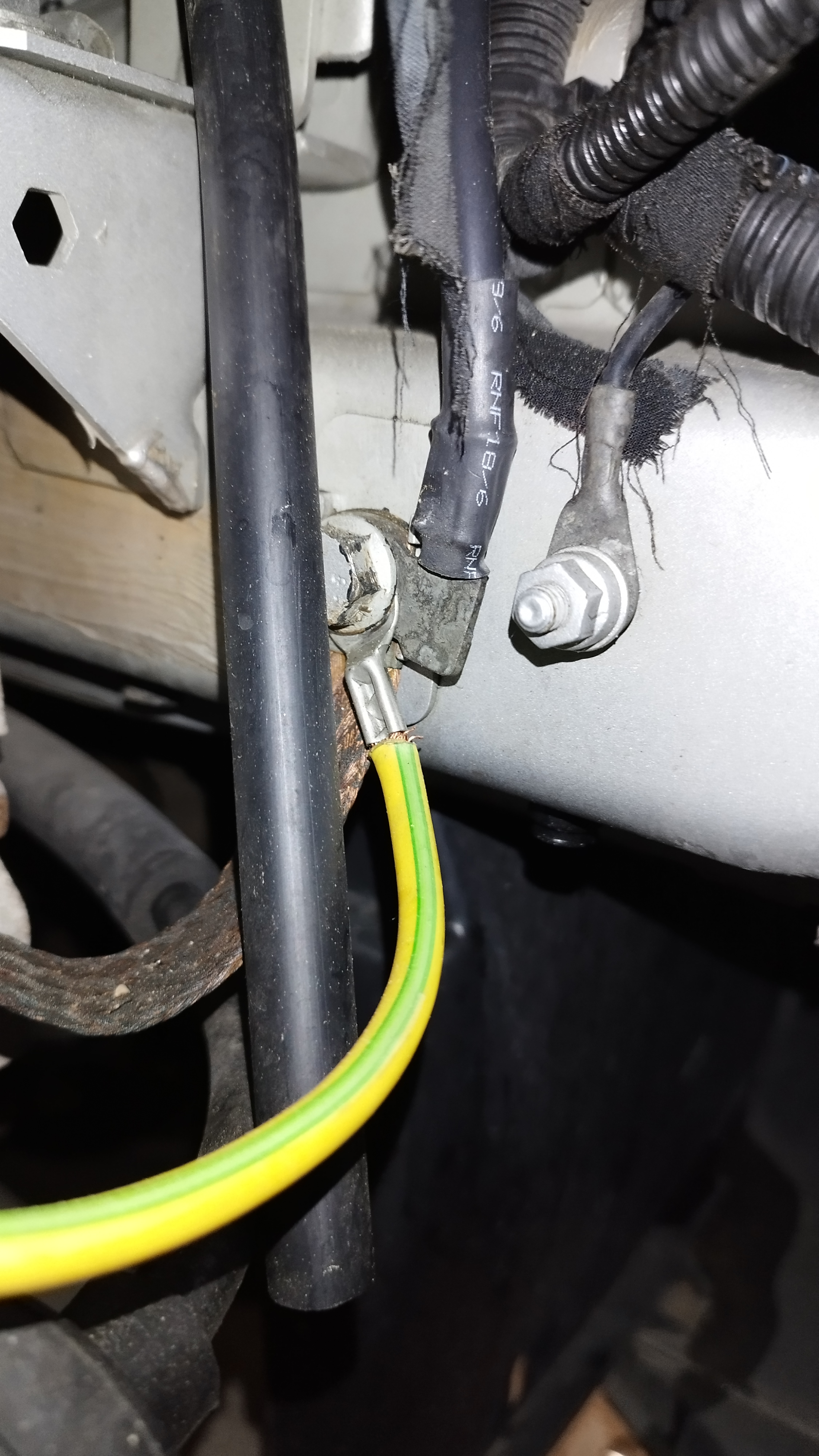

I checked the Fuse and bolt, I also removed the A pillar cover and i could not find a terminal that is shown in the Diagram but i found another ground with DELPHI written on it.
All the bolts and connections looked corrosion free i nevertheless removed them and the bolts, cleaned everything with emery cloth and sprayed contact cleaner, wiped it and retighten the bolts. I will try again tomorrow but i do not think they are the reason. Everyconnection that i check on the car until now is either looks like new or only slightly dirty. I could not see any rust or something. I do not have car battery charger but as i said resting voltage is 12.6v. i think it is fully charged.
Yep they have changed it slightly, using stud and nuts
Yep look in really good condition everywhere, I don't see anything obvious

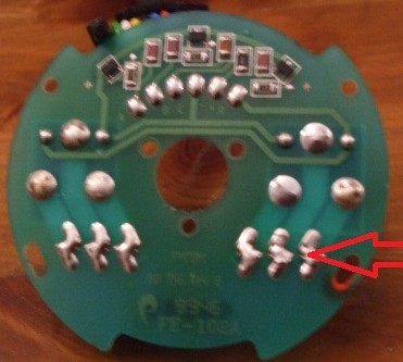

Over here, in The Netherlands, the faulty electrical power steering is a common issue. There IS a fix, however... but it does require getting deep in there.
You'll nee to remove the dash-covers around your steering wheel to access the electrical pcb of your power-steering unit.
The red light is mainly caused by a faulty soldering of the power-leads to the steering unit. Hence you'll need to desolder this board carefully. Resolder the power-leads to the board and then solder it back onto the steering unit.
It does require some squirming into the bottom well underneath the steering wheel, and you really need to know how to solder properly, but many fix it this way and drive thousands of miles with this fix applied, without another fault-warning.

Are you talking about these joints
Don't know yet. Have to figure it out myself still. But from what I see, I would say yes. Those are the ones I'm talking about.
