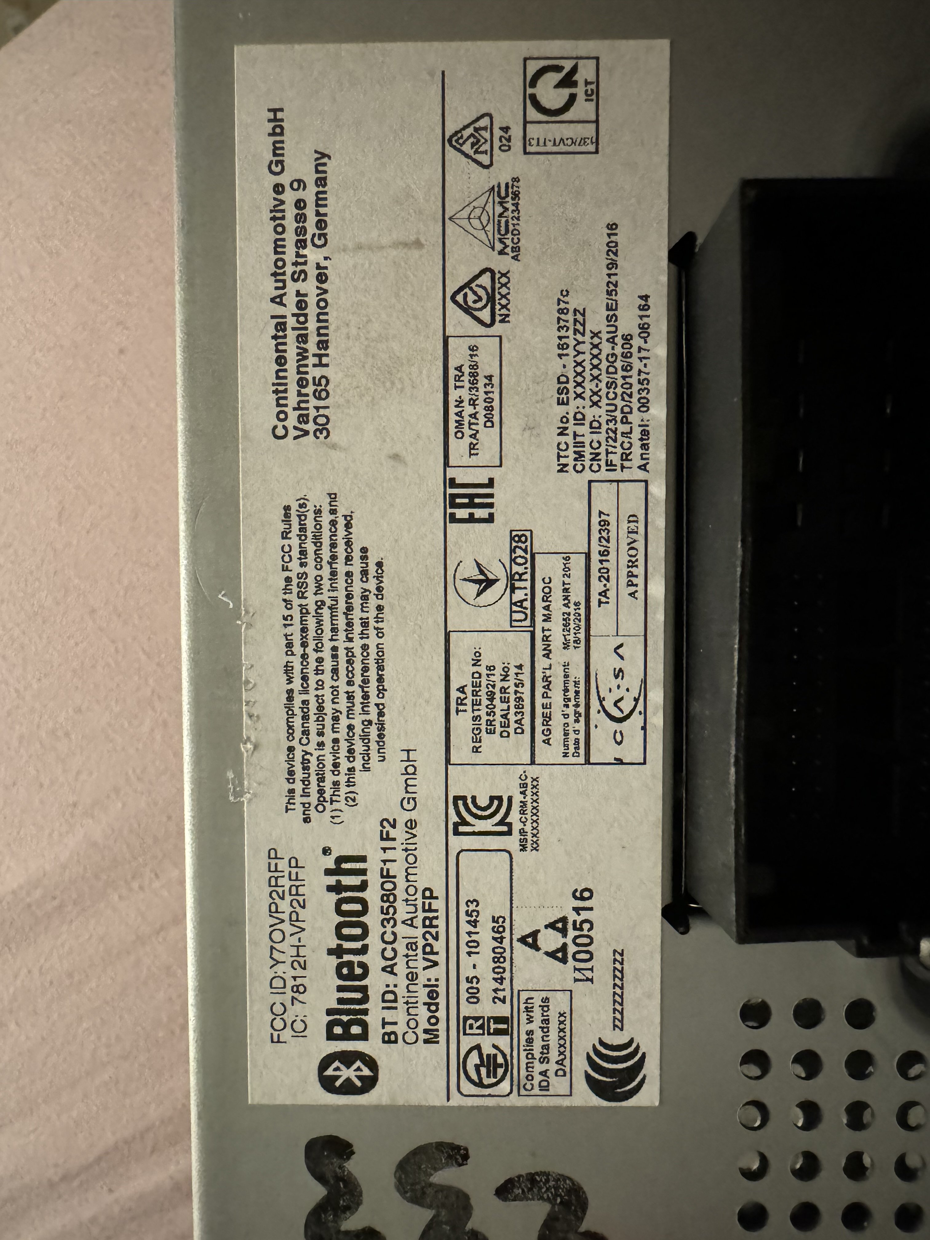

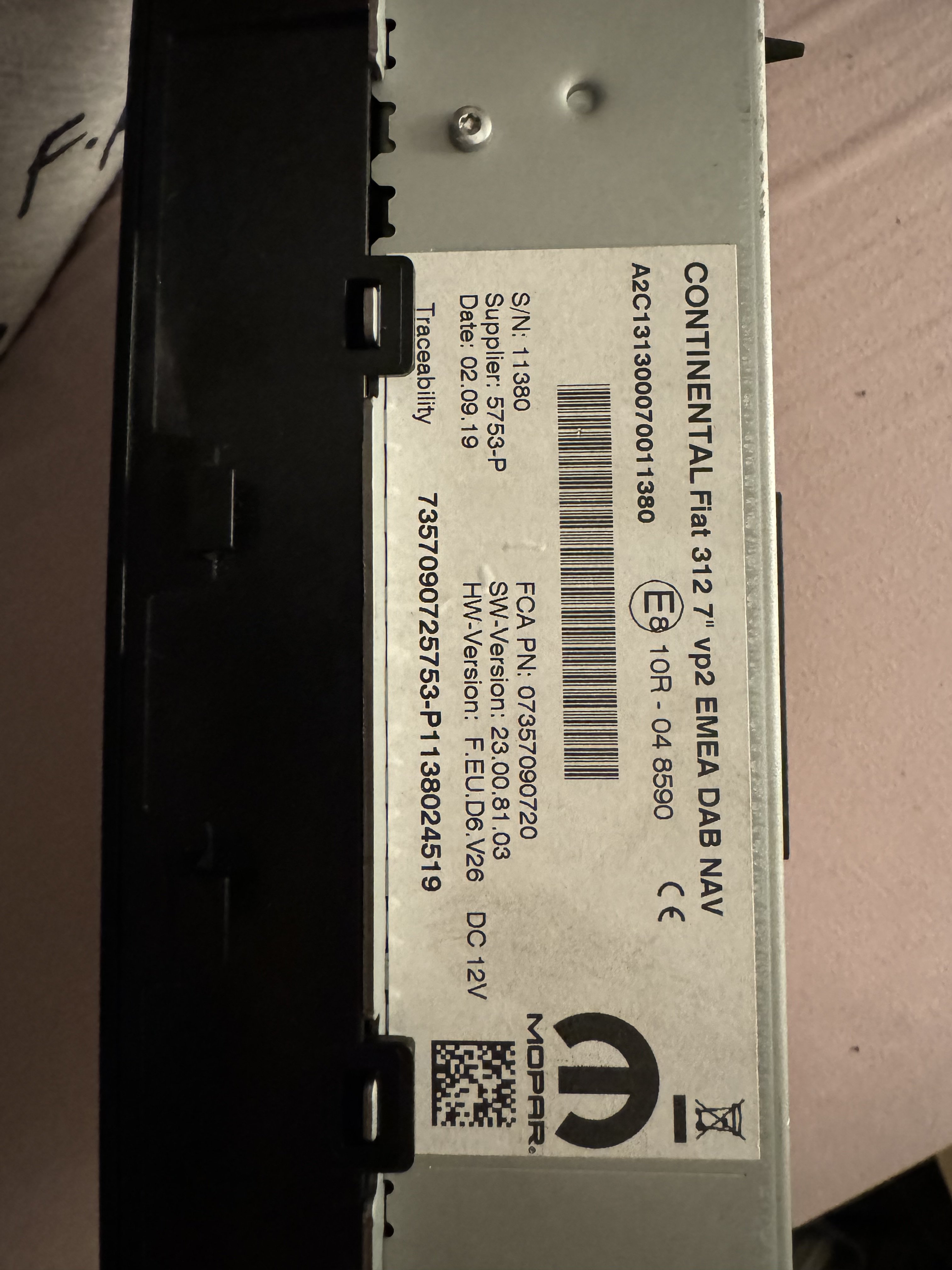

For Information this is my cars scan log, and I will attach
a photo of the radio that is now fitted Thank you!

By the looks of the label on the back having a Bluetooth logo I’d assume that means it does have it built in but I am not entirely sure I will research that further! please correct me if I am wrong but I have a 66 plate 1.2 lounge (information I should have provided sooner!) am I right in thinking that model no longer has blue and me and was replaced with Uconnect? My original 5” radio screen was Uconnect and so is this new 7”
It may depend on when your 66 plate was made. There was a facelift in 2015/16 and depending on what the new infotainment system came put of, it might not be compatible with your car. too new for the car to know how to speak to it.
The label on the back of the radio I took out was dated around 20th June 2016 off the top of my head if that is any help!
