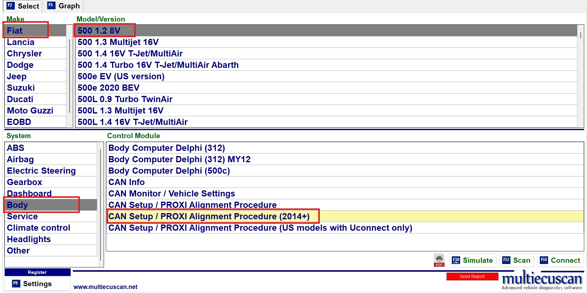

In MES
Pick your make Model and engine
Pick Body
Pick Can Setup / Proxi Alignment
Daughters 500 is a 2015 so I picked 2014+

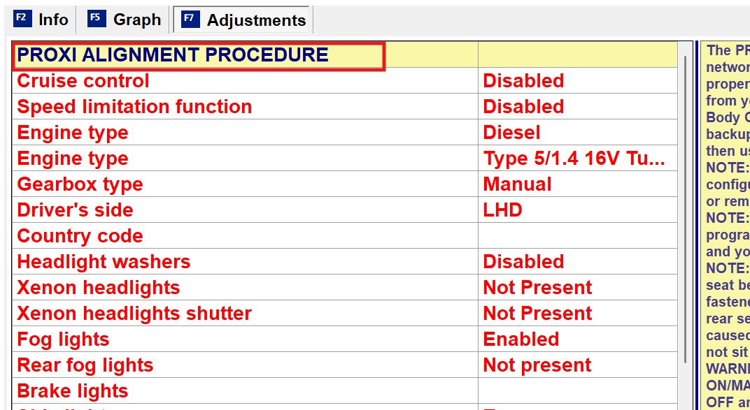

Click Connect
Click on Adjustments
Proxi Alignment should be Highlighted
While on this screen

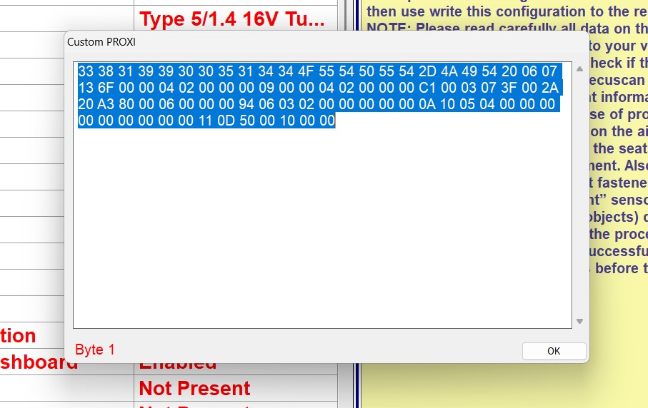

Now make a back up of the Proxy alignment
On your keyboard press Ctrl + Alt +C at same time and a new window will appear
Drag your mouse over the numbers and highlight all of them
Right click and copy
On the PC open Notepad
Right click on the notepad document and paste the text
Save the notepad doc somewhere in case there are any issues
Close off notepad

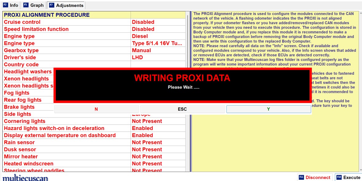

Go back to MES and click on Execute on bottom right
Follow prompt's to ensure ignition is on
Hopefully completes without error / Issues

I would imagine
In proxy alignment hit ctrl + alt + c
That will open the custom proxy window
Click in the box then hit backspace to wipeout / erase the text
Open notepad and copy the text from the doc you made earlier
Paste in to the custom proxy window and hit execute
