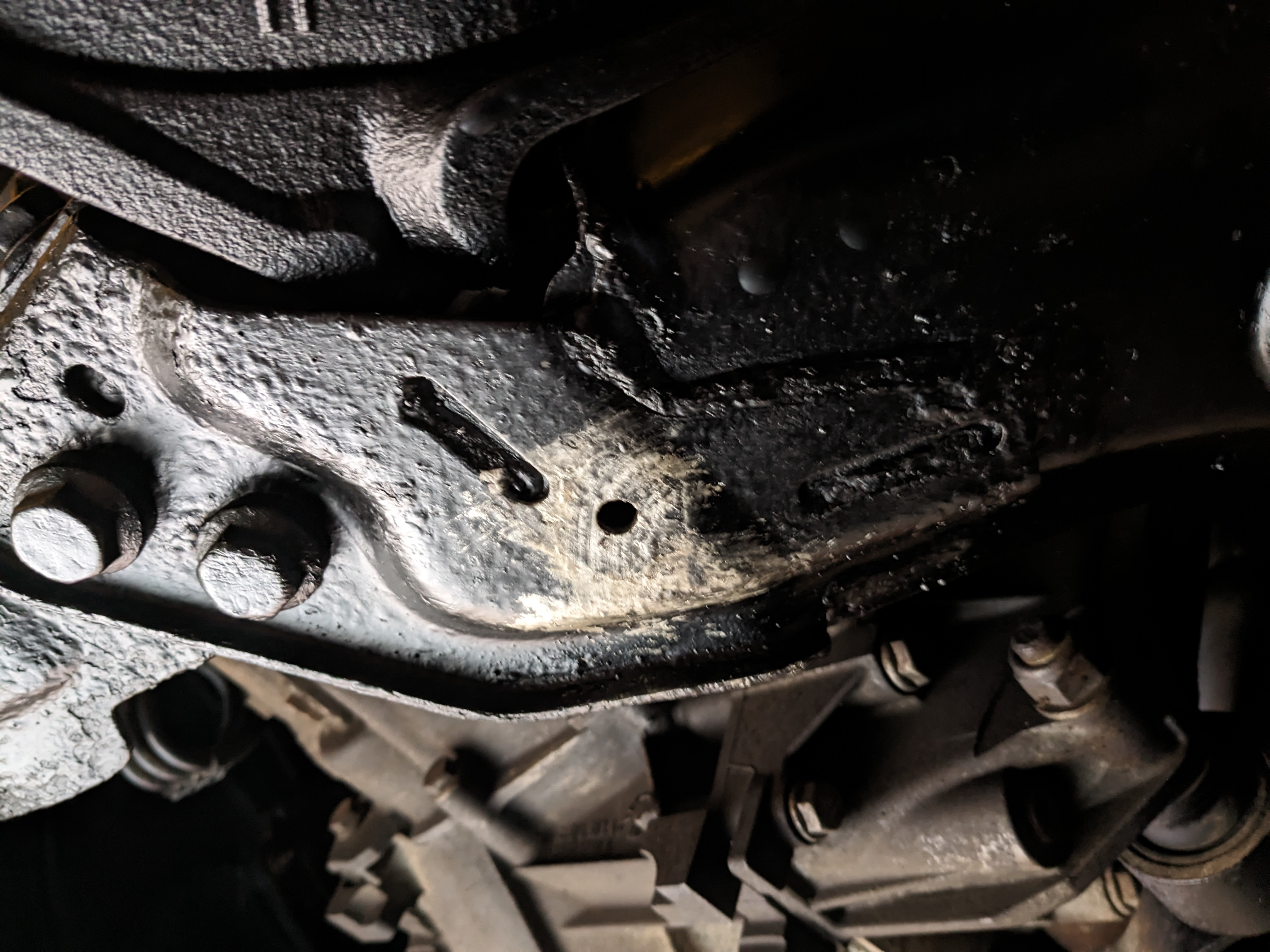

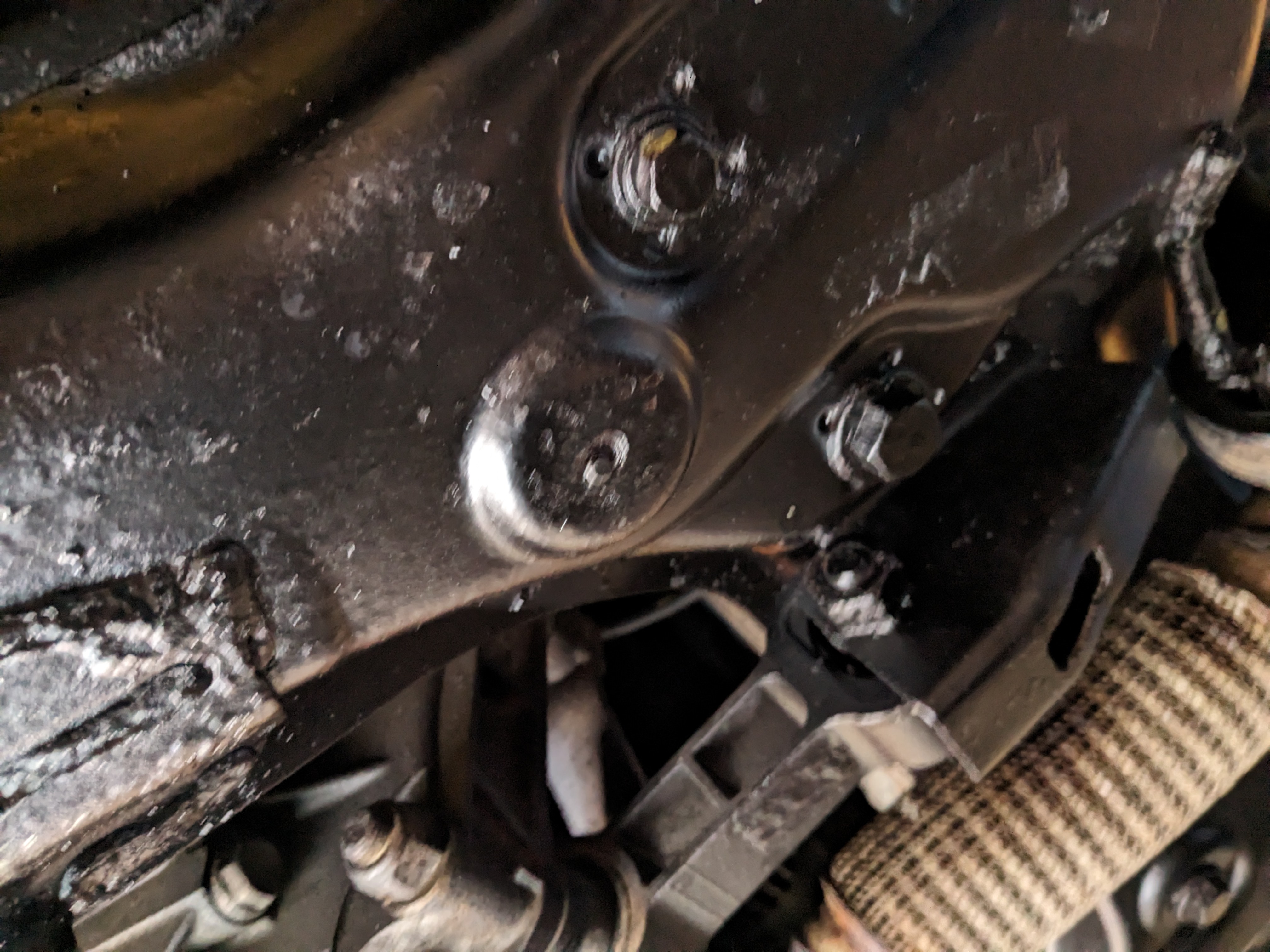

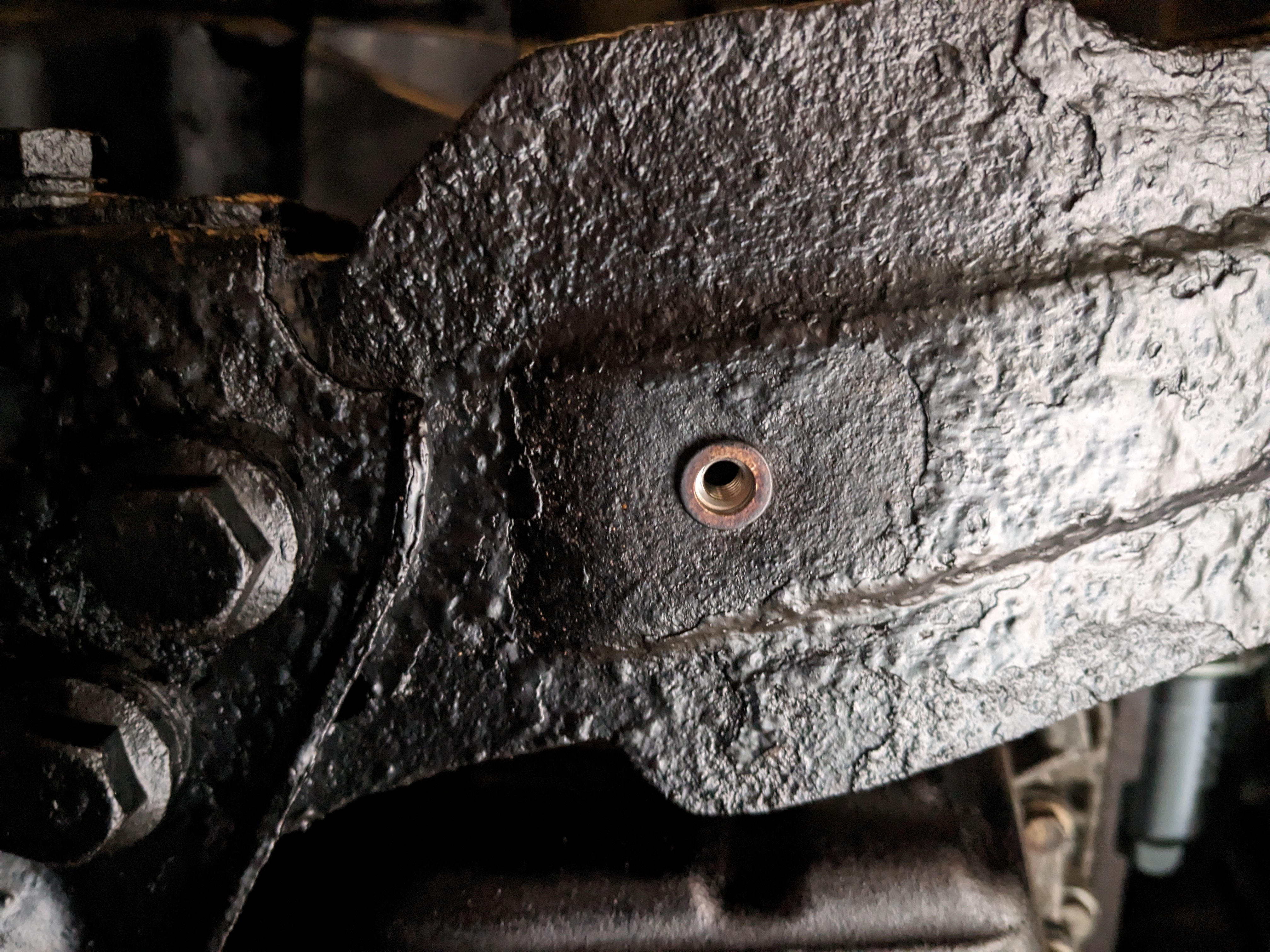

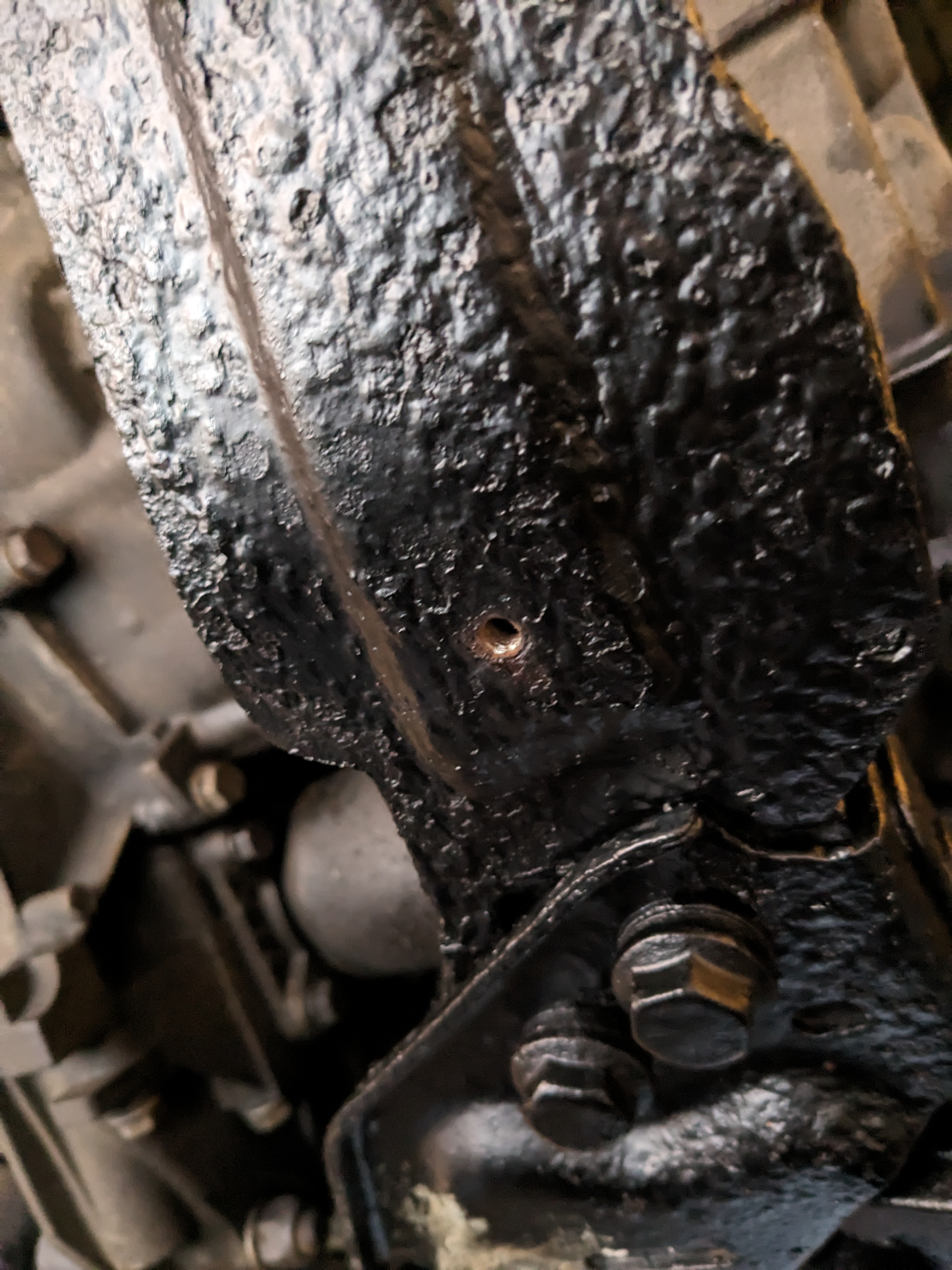

Look or feel at the rear of the bumper support bar for 2 brackets. They are 55cm apart at the bolt holes for the under tray. Bolts to bar are at 53cm.
If the brackets are not there you will need parts 51806279 (right) and 51806280 (left). If you do this check that the holes are in the bar. If not you'd need to drill and nut rivet.
All fixings should be M6 bolts. 2 to bar and3 pairs for the tray. The front of tray simply slips onto the bracket and bolts.
The middle pair of bolt holes have captive nuts. I used the left but had to drill and ultimately insert 6mm rivnut.
The rears are butchered on mine.

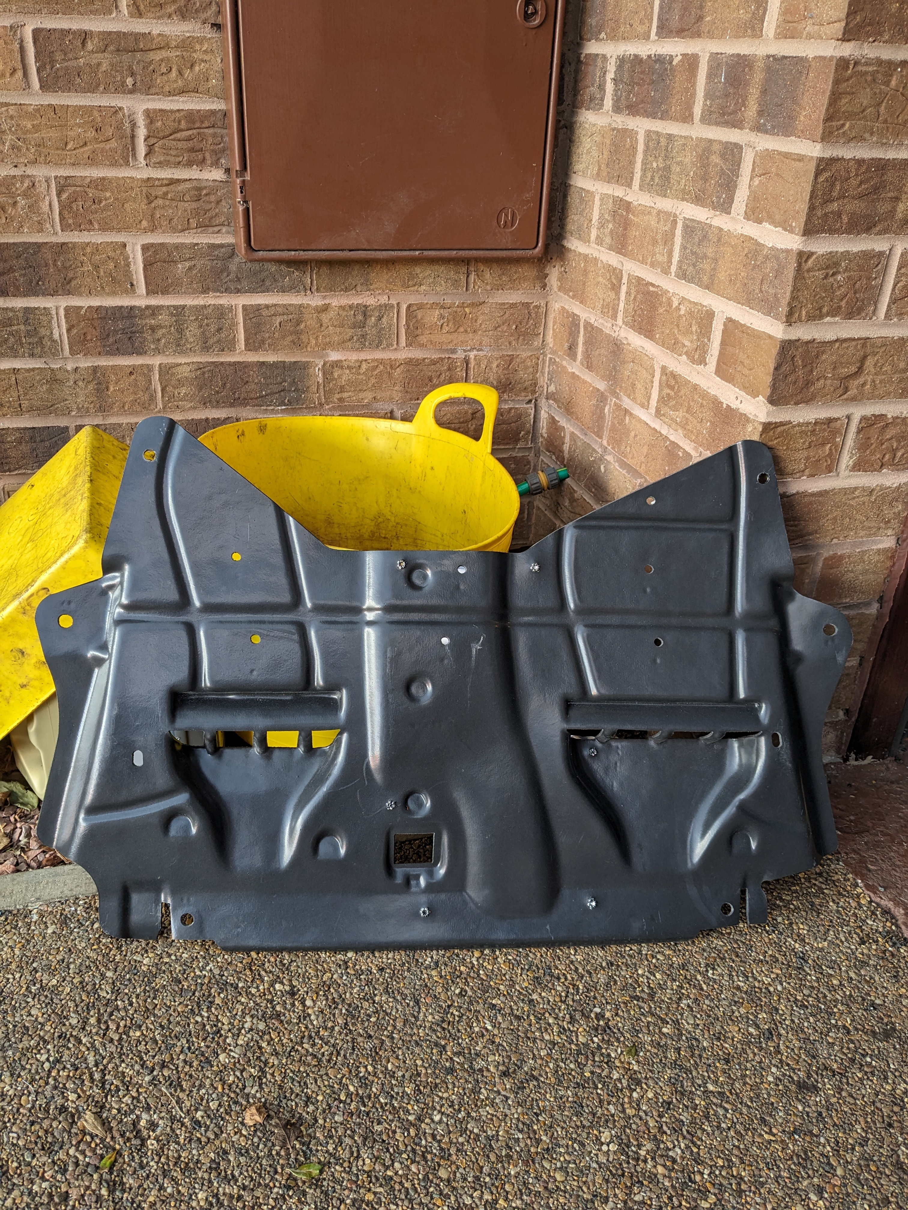

So I decided to modify the tray by shortening it and using 2 other 8mm holes, which I'll plug to fix.
I bought the tray from Trade Vehicle Parts on eBay £36 delivered. Comes with heat shield.
Hope this helps.
