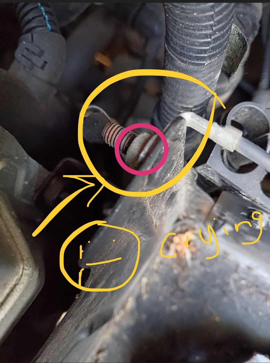

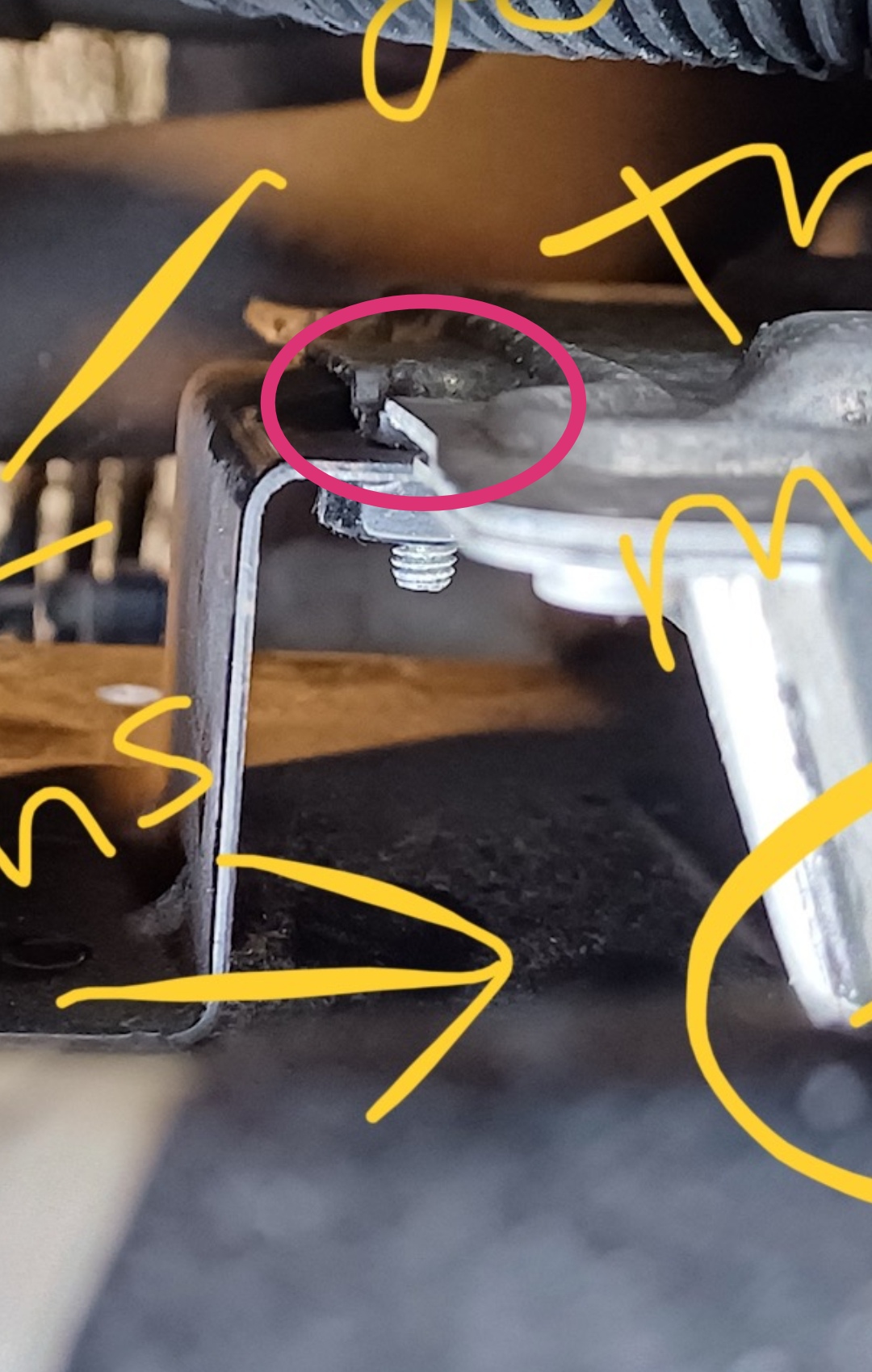

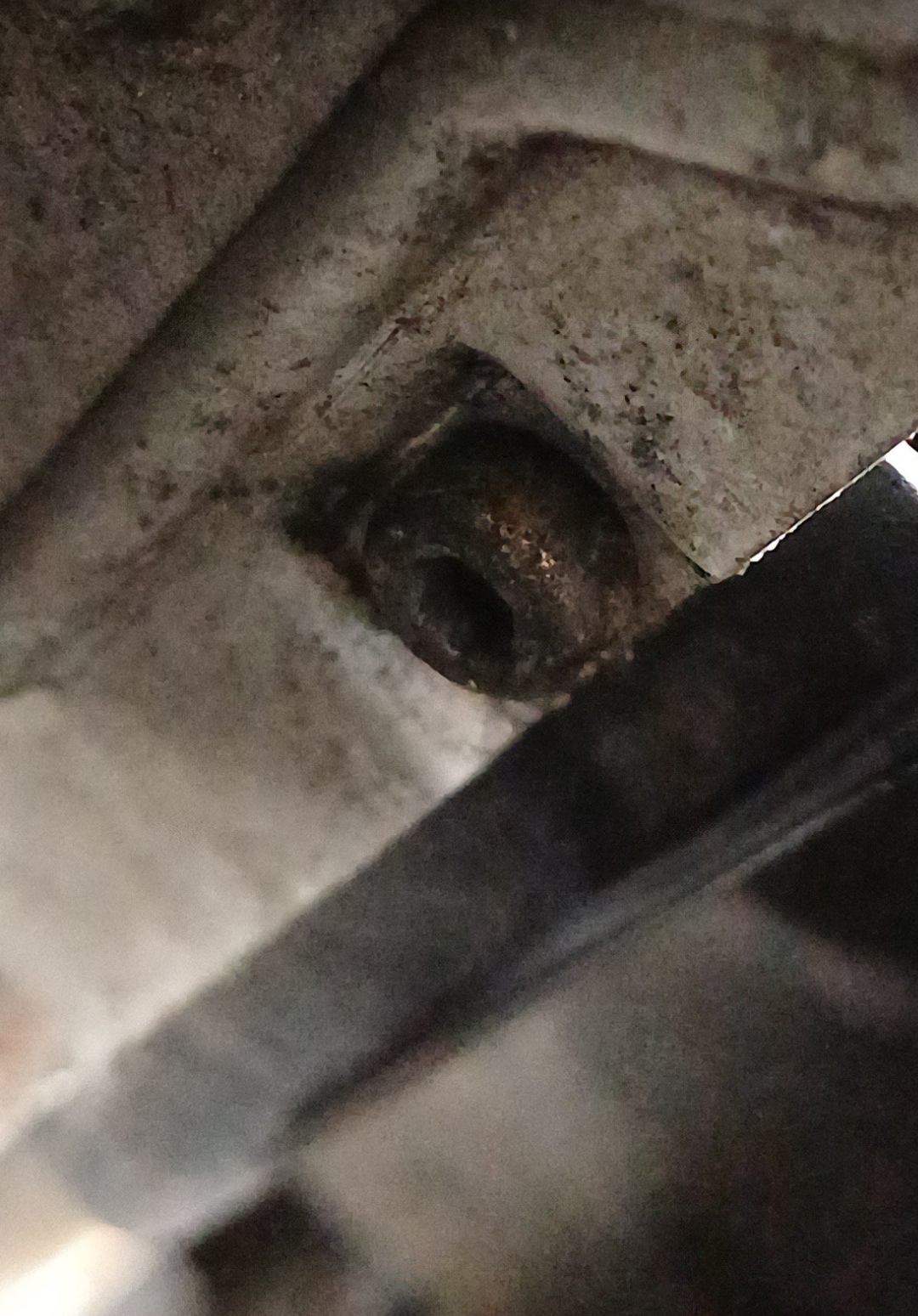

As per John above, this is the head of one of the bolts you need to remove to detach the ecu from the battery tray:
Not the black nut inside the bracket, that is welded on. It's the silver coloured head of the bolt on the outside of the bracket, facing the engine.
I don't know if you can get a spanner on it, might need to be a socket.
You'll need a socket and extension to get the battery tray off.
Unfortunately fiat kept changing the mounting of the ecu, making it hard to cross reference.
Any plastic clips need squeezing and pushing through the holes in the battery tray. Then some bolts and screws to remove.

omg THANKYOU! i had no idea what to do with the plastic clips atall, and was scared of breaking em.
I didn't even notice another bolt, so that's encouraging. I didn't see it when John circled it, I thought he meant the black one. Will have a look in a bit. Thankyou, and sorry John if that's the bit you meant.

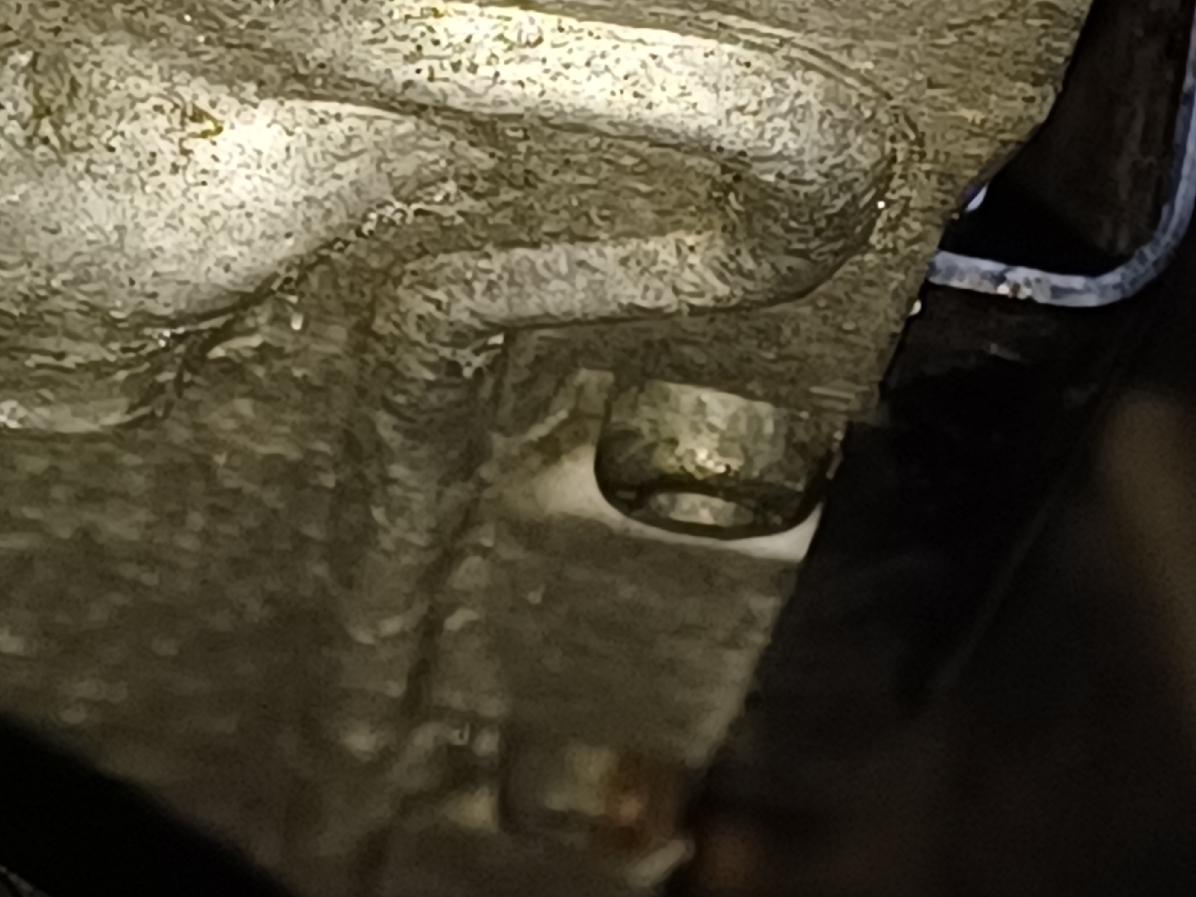

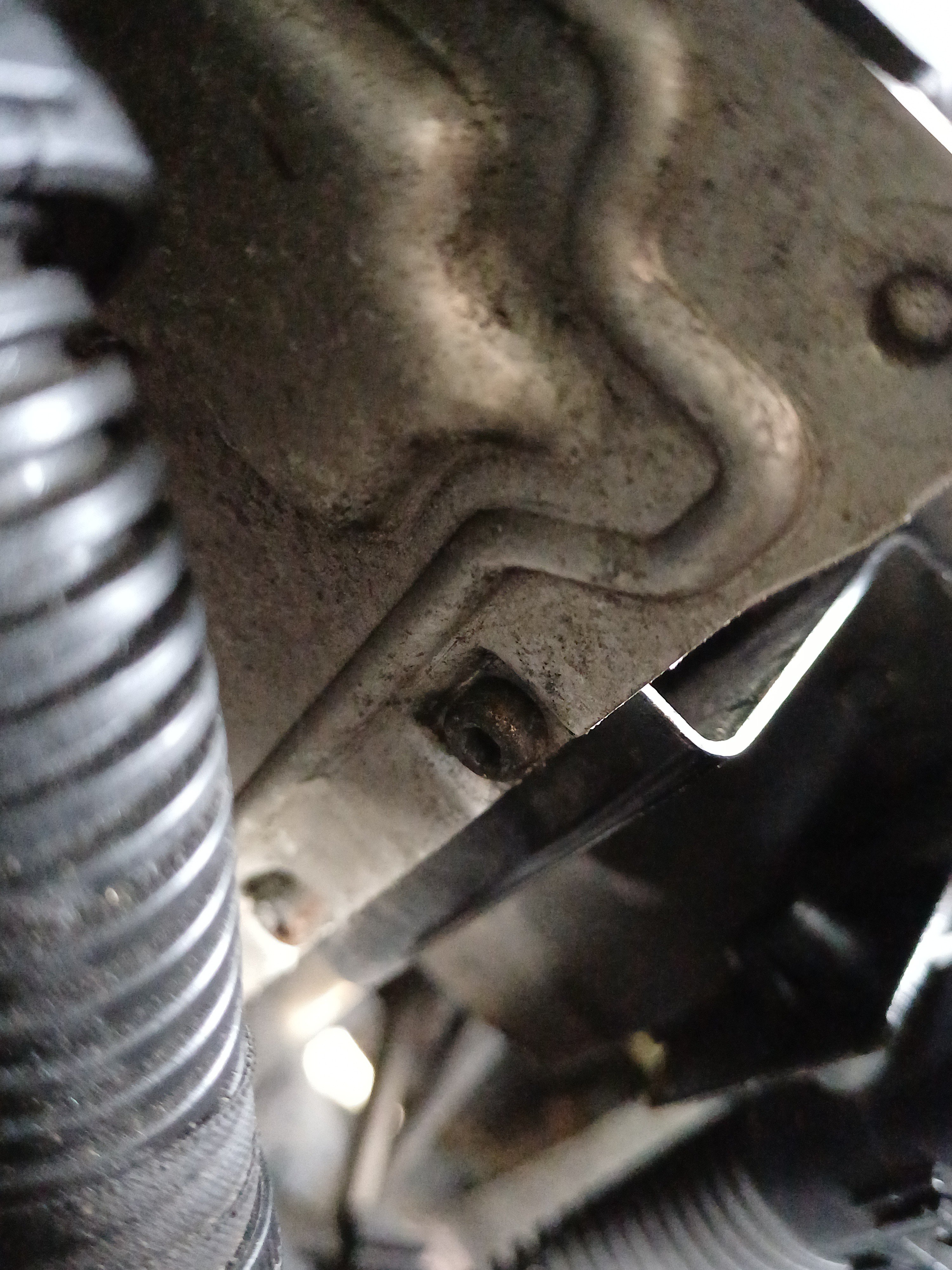

I've just looked. The things I think you are telling me to take off are tiiiiiiiiiiny. @rmjbn1 The look like alan key fixings, that small. There are no other things that I can see that join to the holder thing. There are four of these. The two at the back can't be seen. They look welded on?

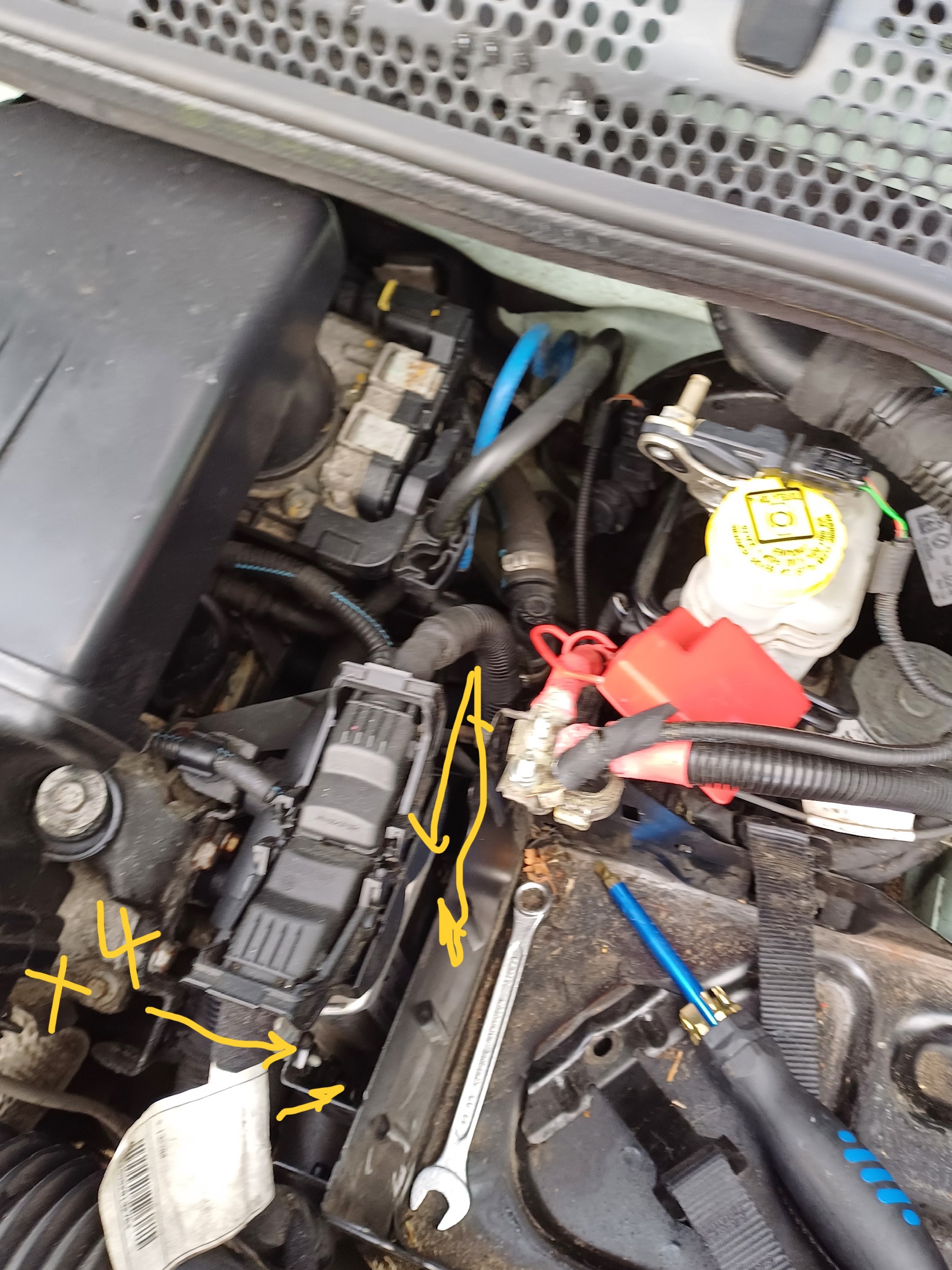

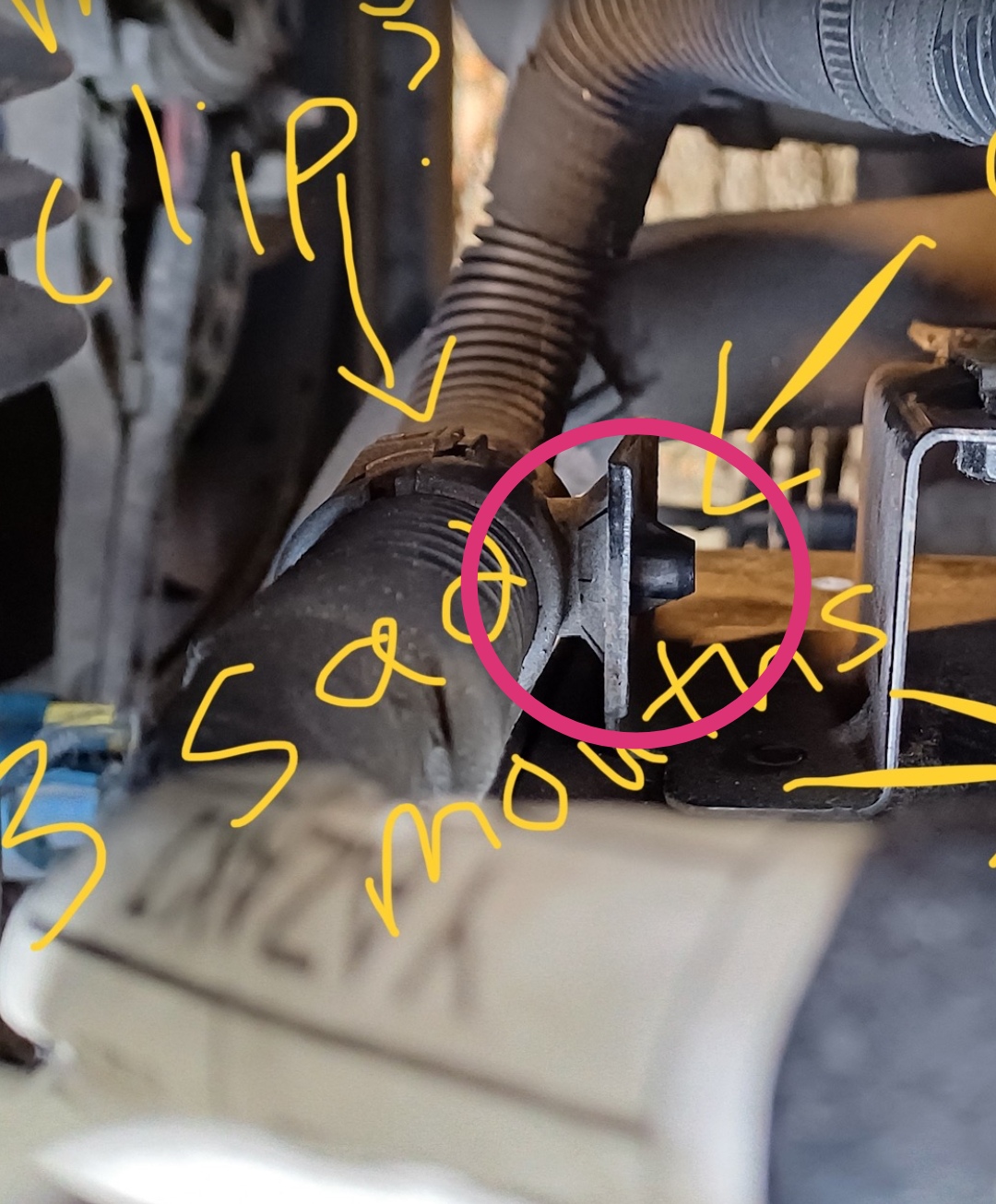

The pipe I'm worried about will still be attached to the unit, even if I get those off. I need to know how to detach the pipe. The clip around the pipe, or is the square thing meant to move?
Do you mean this trunking of wires to the ECU? Looks like you've already successfully unclipped it from the battery tray to me. No further action necessary here.
It's still connected to the ECU of course. Some people unplug them, but I don't like to disturb it any more than necessary.
Ok, so rewatched this vid and that is meant to come off (it's still joined to the metal tray. The bit circled is the tray). Didn't notice yest as was obsessed over other areas during the vid. It does come off where you circled it, so I need to be braver.
He unplugged the ecu, but left it bolted to the tray. 7 mins ish. I have some torx things, but I don't think it's doable. One cos I'm not inspector gadget 😭 and two, they do look kinda melted on. Whhhhhhhhy is my car not like all the other zillion videos I watched?! 😭😭😭😭😭😭😭😭

That video by Love500 is our very own @typecastboy, he knows what he's doing and it looks the same as yours. If he unplugged the ECU and left it in place I would do the same.
Right I'm gonna see if I can get it back together so I can nip out to the allotment. If not I will unclip the ecu in a blind panic and hope it works out.
