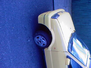

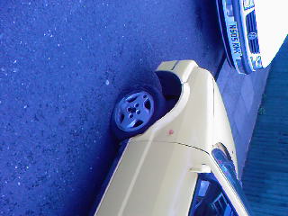

i am going to tri and make a claim becouse i was told its that bit of road and that it happons there all the time
best pics i could get 4 now

my cinq will live i have been told all i need is a new wishbone may need a new driveshaft but just 1bit of it and bend the rollbar back into place so my cinq will live:):slayer::slayer::slayer::slayer::slayer::D(y)
I'd be very worried about the state of the shock and top joint: can't see any way they could have survived. And if the ARB has bent, best replace it or it won't work properly.
Wings, however, are bolt on and very cheap.
A glance might give someone the idea that the chassis is OK, but the only way to tell is to strip out the wishbone, strut and arb and measure, very carefully. The tolerance is about 1mm.
