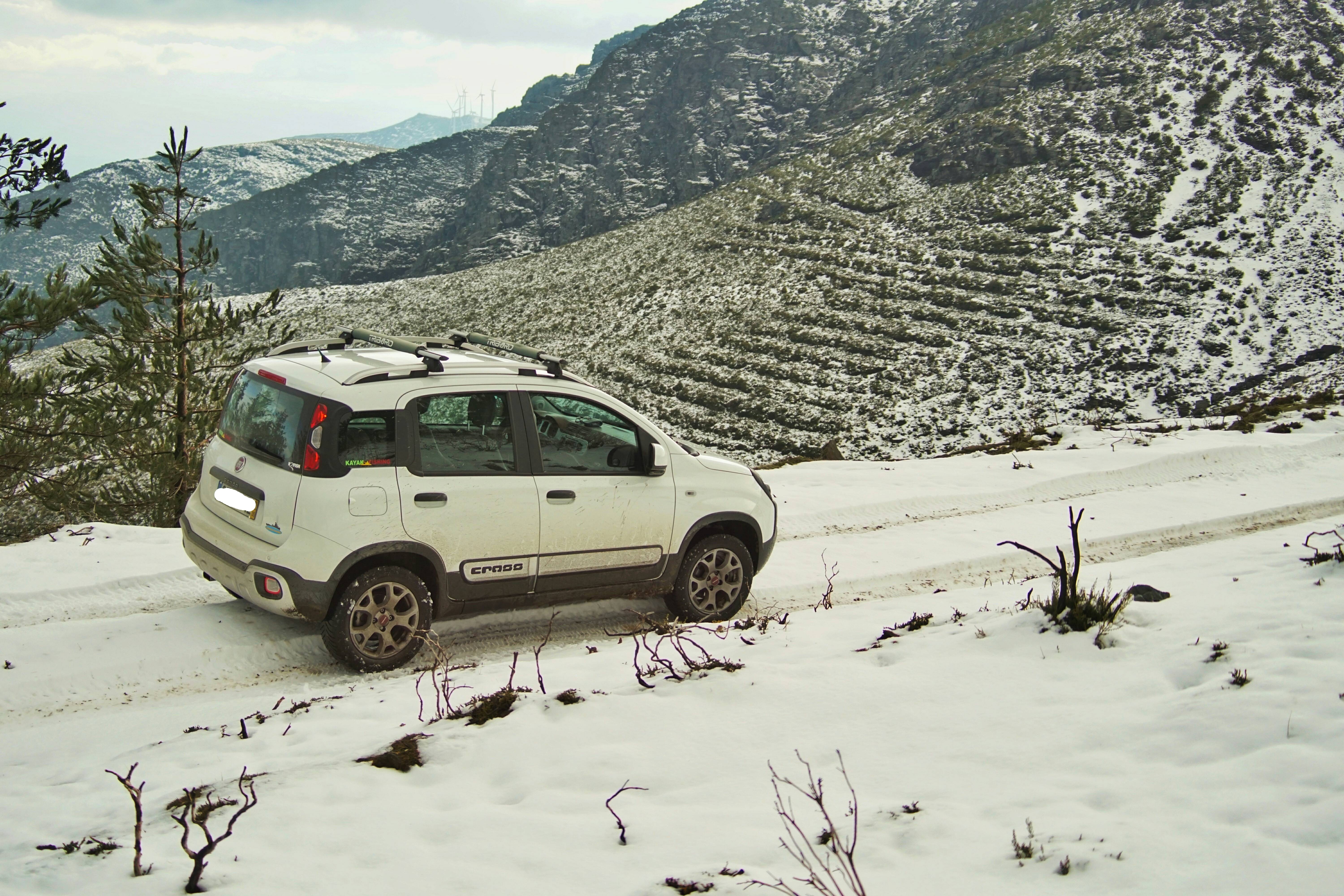

Panda is almost with 3000 kms after puting the new engine and keeps going. Waiting for the quarantine to be over to go into some light offroad experience :D
