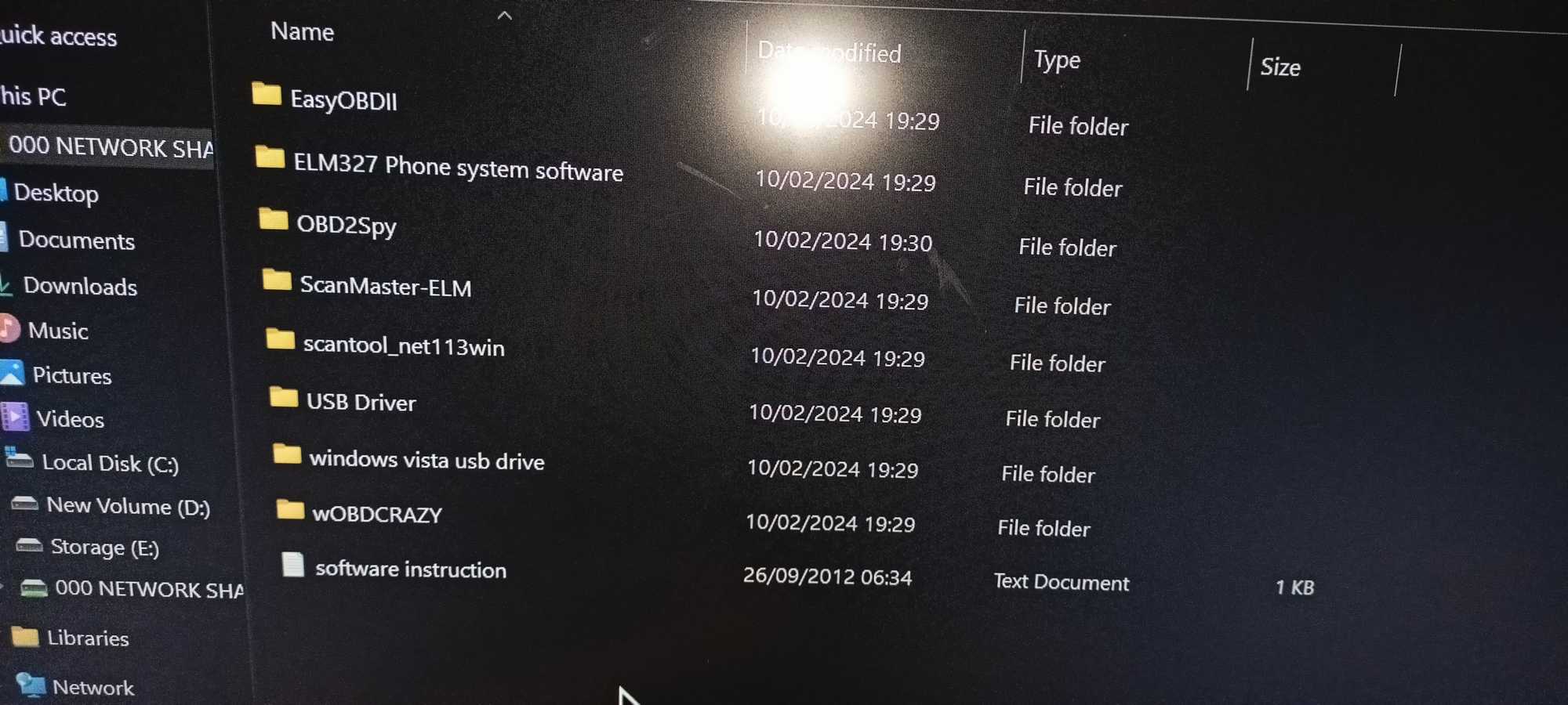

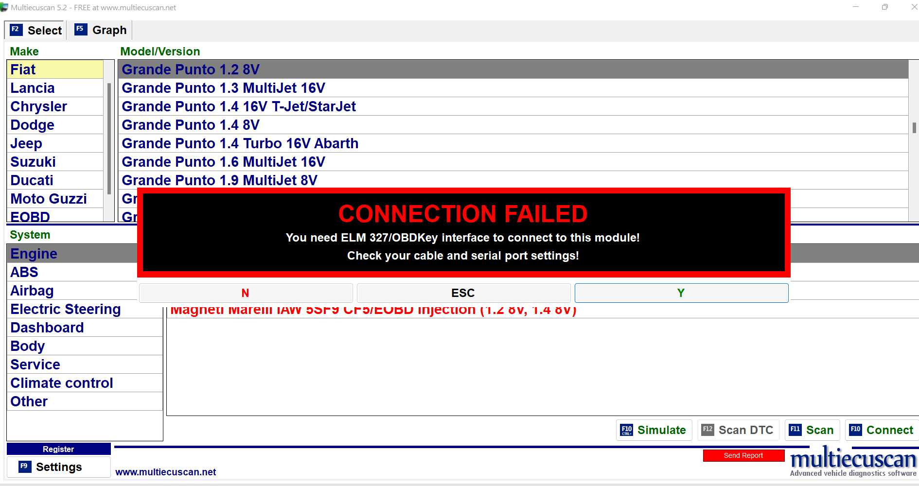

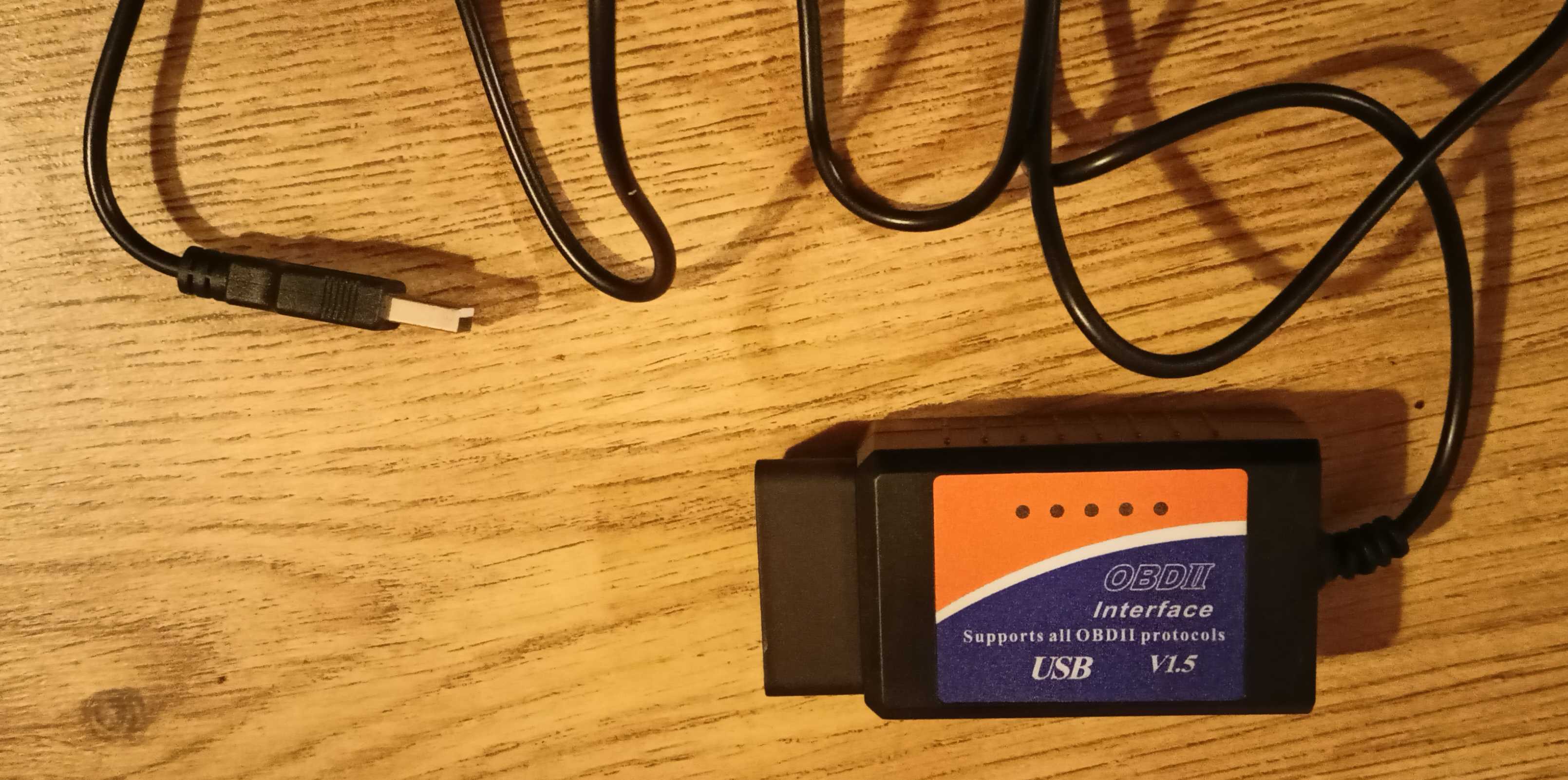

A USB code scanner came today, I can connect the car socket to my laptop and open up Multiecuscan but Multiecuscan gives me an error saying I need an ELM327 or OBDkey interface.
The USB code scanner I bought didn't come with any drivers built in, instead i got a CD with a load of very old scanning programs on it.
I installed some of those basically useless programs in the hope that one of them may put a driver into windows that I could use with Multiecuscan.
I visited the ELM327 website and installed one of their drivers.
I searched on here and found some old drivers for windows xp and vista.
None of that worked, so i'm going to have to send the code scanner back, unless one of you guys know where I can get some modern windows drivers?
This is the error message, scanner, and the list of software programs I got.
Needs to be a modified elm device specifically for fiats. You can modify yourself with soldering a resistor in across particular pins... But I'd just get one that's been done. Search fiat modified elm327 on ebay and the likes. About 30 quid with all cables for all modules on the car.
I have a soldering iron and I'm reasonably adept at soldering, but yeah, i might buy a fiat specific elm327. I'll have a think, thanks for the info.

You only have to look at the MES Forum to see all the ELM devices that do not work. You can try what is suggested there in the long rubbing thread:
http://forum.multiecuscan.net/viewtopic.php?f=5&t=1493
Personally I would go direct to Gendan as their devices (ELM / OBDLINK) work.
From the MES forum I can see I need to short out the R14 resistor. It wouldn't be too difficult if thats all I had to do.
I looked up the Gendan devices and also eBay devices which say they work with Fiat cars but don't want to pay £30-£40 (at this time).
So i'm going to do the following...
Wait until all the petrol is out of the tank and hope the engine light goes off. If it does go off then send the OBD2 interface back and kick the can down the road!
If the EML light stays on after i've next filled the petrol tank, I'll open up the interface and short the 120 Ohm R14 resistor. And hope for the best :)
NO DON'T DO THIS
The 120 ohm resistors are bus terminators. If you short them out then you will short the bus lines out.
The reason most of these ELM devices don't work is because the car's CAN Bus already has the require 120 ohm terminators. When another 120 ohm terminator is put on the bus by the ELM device than the bus now has 60 ohms across its data lines which it does not like.
Read the posts again carefully. In most cases the 120 ohm resistor needs to be removed not shorted out.
NO DON'T DO THIS
Thanks for the headsup, i scan read the MES forum post, so I'll look closer again. Yes you're right, the resistor needs to be removed.
