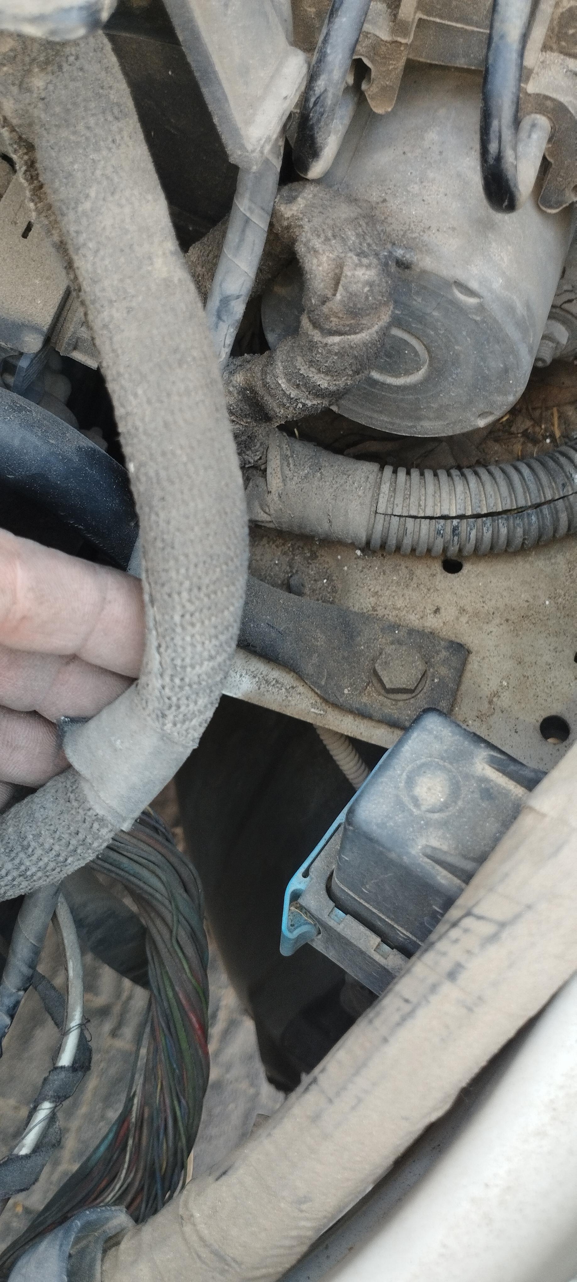

So I took out the headlight and check all the looms. The problematic part of the looms are encased in a kind of clothy mesh thing and there is no evidence of wear through were it contacts the ABS or that metal tube. Part of another loom the wires are completely exposed, but no evidence of damage to those wires...
Next thing I'll head under the dash and start looking around there....

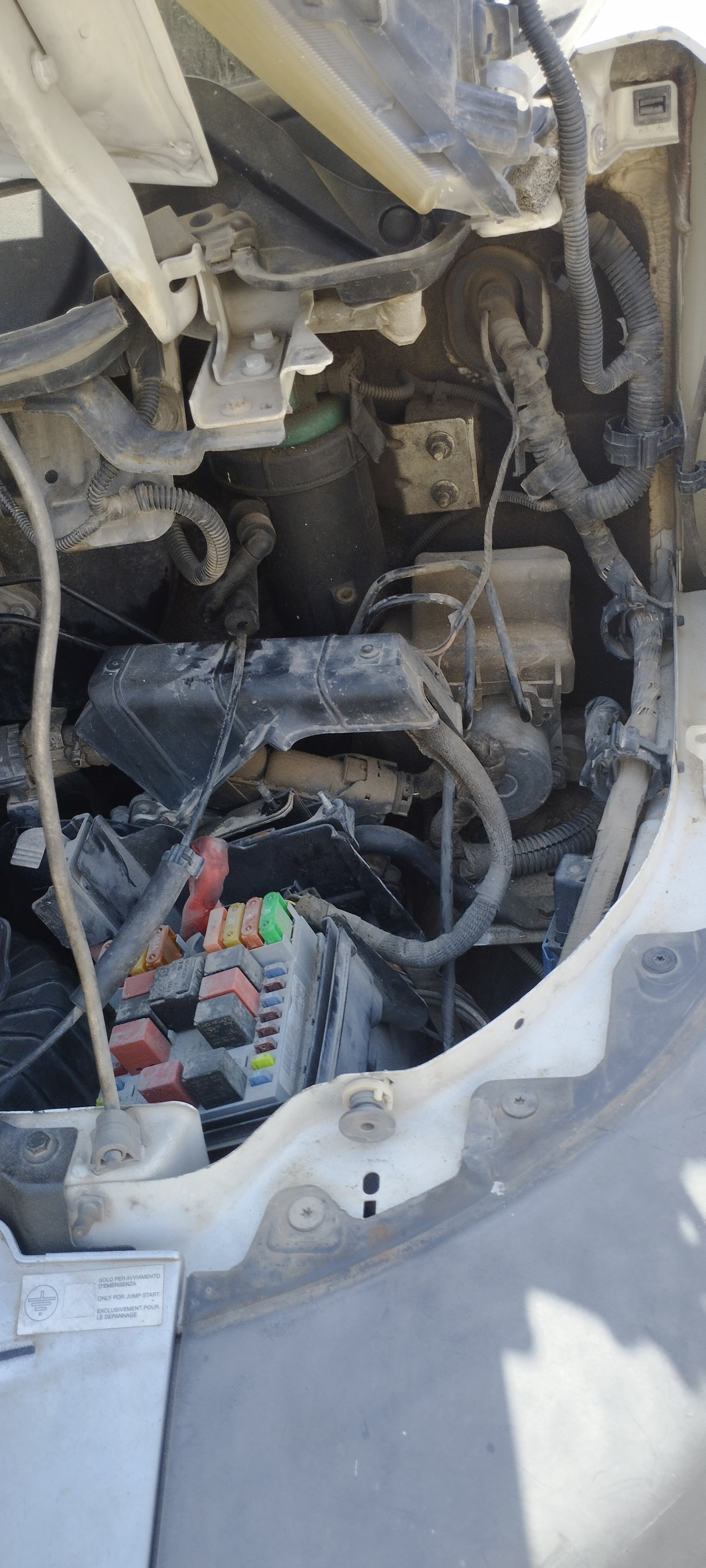

The vehicle has obviously been operating in a dusty enviroment, and the cover from the engine bay fusebox is missing. Dust can cause electrical problems. Given the symptoms reported, and that this fusebox is a common point, it would be sensible to either strip and thoroughly clean the fusebox, or alternatively replace it. Used boxes are available on Ebay, but do check the part number if purchasing. Cleaning a similar fusebox is described here.
