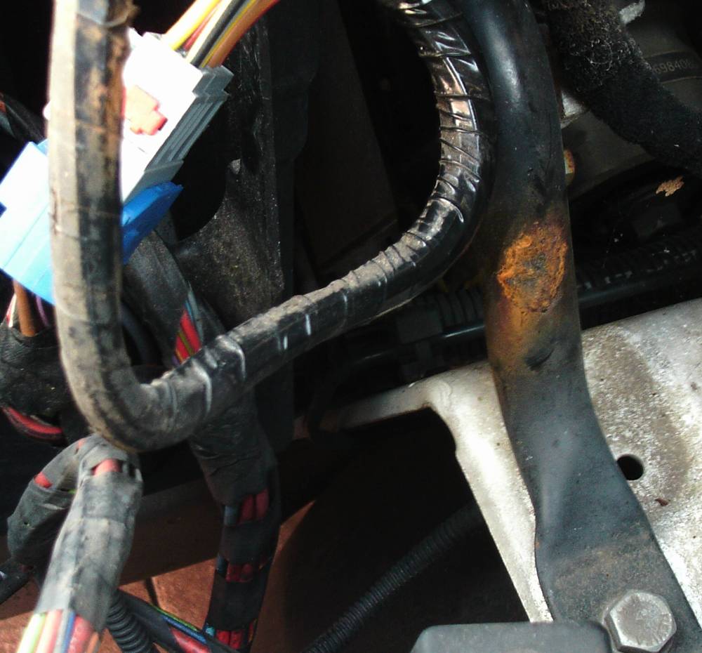

Many Thanks rolopolo for this thread. I took my headlight out this morning and found the loom going to the ECU was chafing on a smooth round metal tube where I wouldn't have expected it. I don't know if this is the same as yours rolopolo. - I will try to attach pics.
The paint had worn off the tube, so corrosion had made it like sandpaper. It had not only worn through the binding tape of the loom but the insulation as well!!
If it had been left to go any further it would no doubt have done some funny things with the ECU :eek:
I have bound it with tape (red for clarity) and wrapped it in rubber hose to stop further chafing.

Peter, exactly the same as mine, mine you could see just a tiny wear on the insulation on a wire, but corrosion had worked its way all along
Thanks Again Rolopolo. I've done 58,000 miles (2008 Citroen Relay 2.2) and would not have imagined the wiring loom would be moving enough to chafe through to the core of the wire on this round steel tube, even with the headlight out you wouldn't notice it until you lifted the loom and looked underneath. Looking at the wire it couldn't have gone much longer without problems. So I am very glad to stop it now.

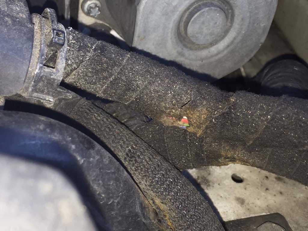

I'm very grateful for these 'stitch in time' tips so have checked my van.
I'm happy to note that my loom has been fitted to be well clear of the tube with no cable tie in evidence (difficult to see from photo but there is a couple of cms clearance)
Don't know if I was just lucky or whether the fit had been amended by then (probably a 2009 build chassis) or whether there was a different loom for the 2.3 engines.

Thanks for the photo Crossingkeeper. Your loom has been fitted with a protective sleeve, mine hasn't - just wrapped round with tape which has worn through at the top left of my first picture - I was holding it out of the way to show the rusty abrasive patch on the tube, which was completely hidden when the loom was in position.
Looked under the bonnet of my van and didn't recognize any of these pictures. The loom is wrapped in a harmonica sleeve with rubber grommets in the metal supports, no rubbing of chafing anywhere. My vehicle is of course the continental version.

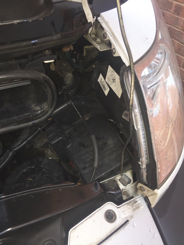

And the ECU cover needs removing , RHD Iveco 2.3 & 3.0 engines
You can see my new loom the electrician made up, the cover that covers loom and ECU needs removing, to gain access to the area where the loom chaff's against bracket, (headlamp requires removing to gain access the ECU cover
Mine looks to be worse than the photos above. As in all the others the problem seems to be from the paint on the black steel tube rubbing off easily so rust makes the surface rough as sandpaper.. There is no sign of rust where the loom touches other painted surfaces which are part of the main (galvanised I think?) bodyshell. My loom was wrapped with only thin plastic tape, not the felt stuff in other photos. 2 wires were damaged, and appeared to be just about worn down to the copper core. But the core was intact and the wires were dry because the van had been standing for a week without rain. So I put a bit of insulation tape around the partially exposed wires, before binding it up with more tape and covering it with rubber hose for further protection.
