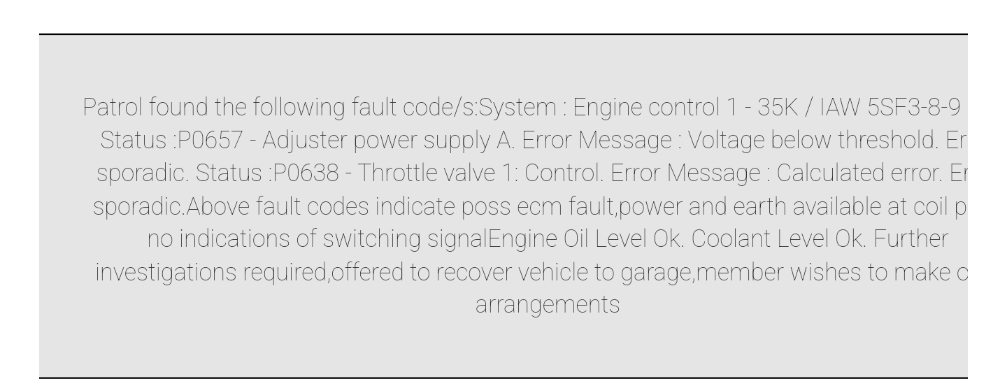

I received the AA final findings and attached to this thread
