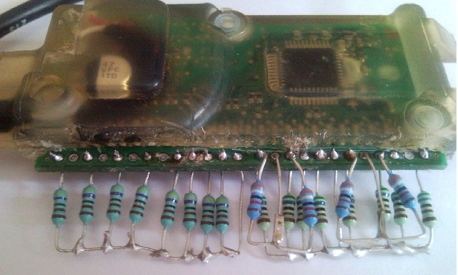

Should I cut I foil or solder resistor paralell with foil?
cut the foil. if you leave it ther it will have the same rezistance as the rezistors...
and some other pictures with 2 ocs's repaired.

all is ok, solved all problems today. check also driver's wirres under the seat if you have problems.
this is schematics what i've made today...
try it!

hi there i just done this mod to the airbag it worked great for one day but now has stopped working again i checked my resistances they are a little low but within 3% do they need to be deadly accurate or can i even go a little higher? if anyone knows how the system works your help would be greatly appreciated
thanks
I made this simulator before one month. It worked perfectly till yesterday. Yesterday I got message ''Airbag failure'' two times. Today it works fine again. I dont know is that because of tollerance of resistor.
check the whires under both driver and passenger seat.
It's not a problem. I connected fiatecuscan and it said that ECU gets incorrect signals from passenger seat sensor. When I unplug conector under the passenger seat, fiatecuscan said that somewhere is open circuit, and I assume that connector is not a problem.
Last owner had some version of simulator and he said that it was working some period and stoped.
Maybe ECU is too smart and it can recognize that we would like befool them.

hi mate the pcb is connected to the seat pressure sensor under the seat cover it is covered in a rubber compound take care when removing it!!

Worked like a charm! Used the old resin to isolate it whit hot air.
Had the error 32 fixed/unknown
Used ¼ watt resistor's, mostly 4k7 and 8x 20k (series of two=40kohm).
