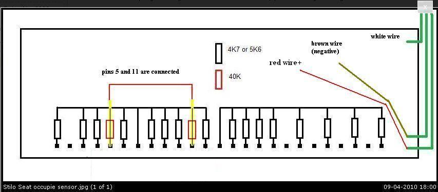

But yes if just foil matrix is faulty... Is there any possibility to emulate just the matrix, not circuit?
Yes, havent tested it but others have and say it works.. emulates the seat being empty.. There are other solutions such as reprogramming the 68HC and other stuff, prob easier just to get a new mat or a full emulator.

this is how my OCS is connected... pin's 5 and 11 are connected on the circuit board. also i don't know if the red, brown and white wires are connected like they should. from what i checked they are but... waiting from an answer from someone who knows better... my wires have brocken when i dismounted it....

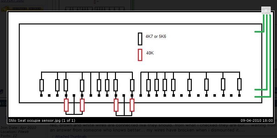

try this method, it is working. pay attention to the foto and make the connections like the ones in the picture. i just emulated the matrix today. it's working like now...
i've user 5k6 and for the 40k resistances one of 39k and one of 1k..

It would be a better idea to emulate the seat occupied at all time than noone in the seat. In a crash, your passenger won't even notice the airbag saved itself for someone better?
Morty, the method posted above it's a safe method. In case of a crash the passenger airbag will deploy even if a passenger is not in that seat.. the ocs emulated actualy tell's to the airbag that there is a adult person seating on the passenger seat.

I understand. And misunderstood at first. I though the method would make it permanently shut off. It is no point of saving the airbag as a crash propably is a writeoff anyway - if the impact is so hard deploys the airbag.
I used an emulator earlier from http://www.airbag24.de which worked very well, but it was only a substitute until I got a replacement OCS. This one also emulated a "grown-up" person. So child seats (not for infants or toddlers) should at least be mounted in the same direction as the other seats.

hi guys this emulator how exactly do i make it and it wire in.
do i remove the old mat first.leaving me with no board and just the 3 pin connector or do i cut the mat off so i have a board and no mat conected to it.or do i leave it.
are all of those resistors already on my ocs circuit board
do i just add the 2 red resistors to my existing board or is this a new board i have to make out of the diagram and connect it to my 3 pin connector for the ocs board.....
